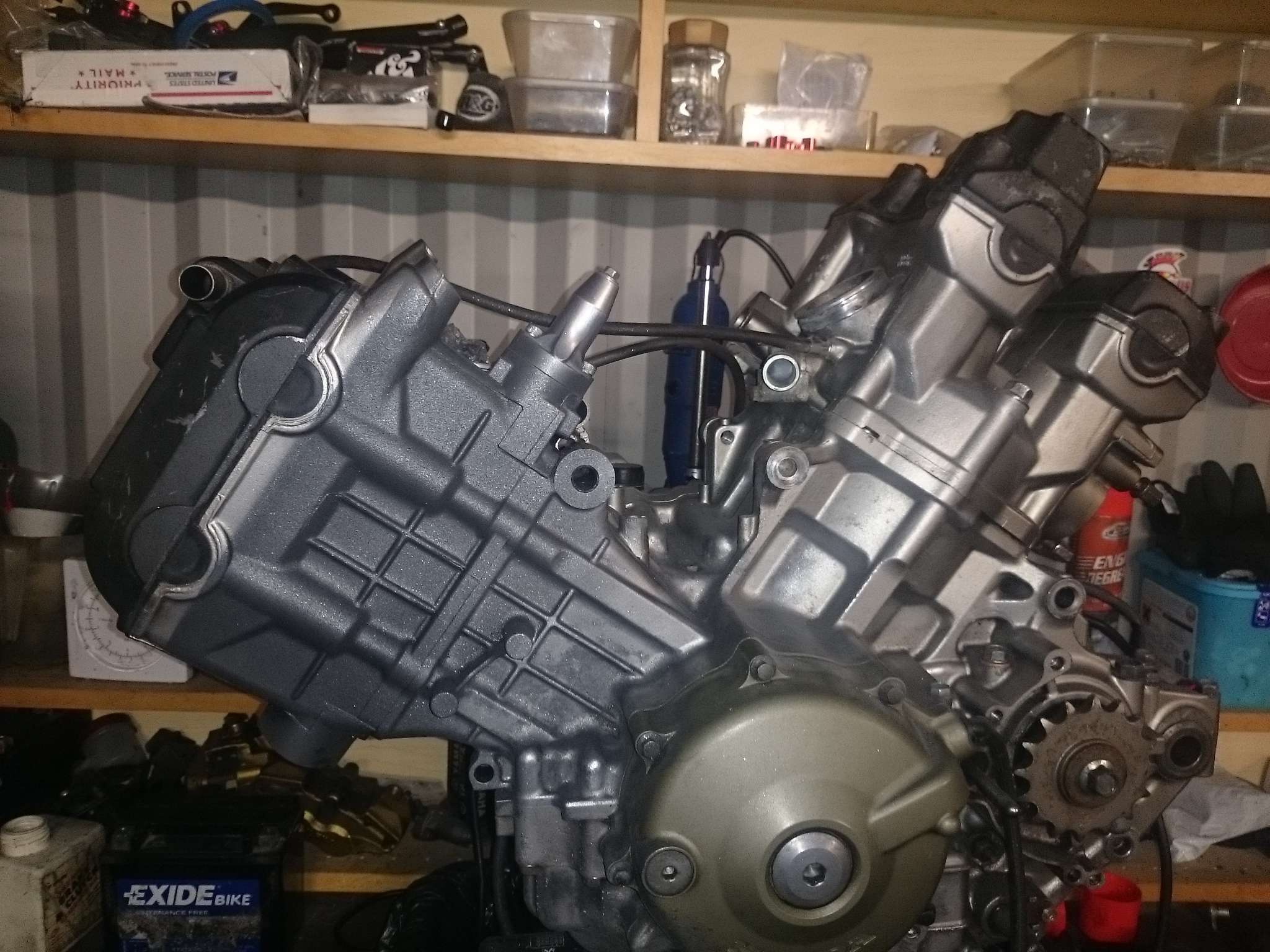

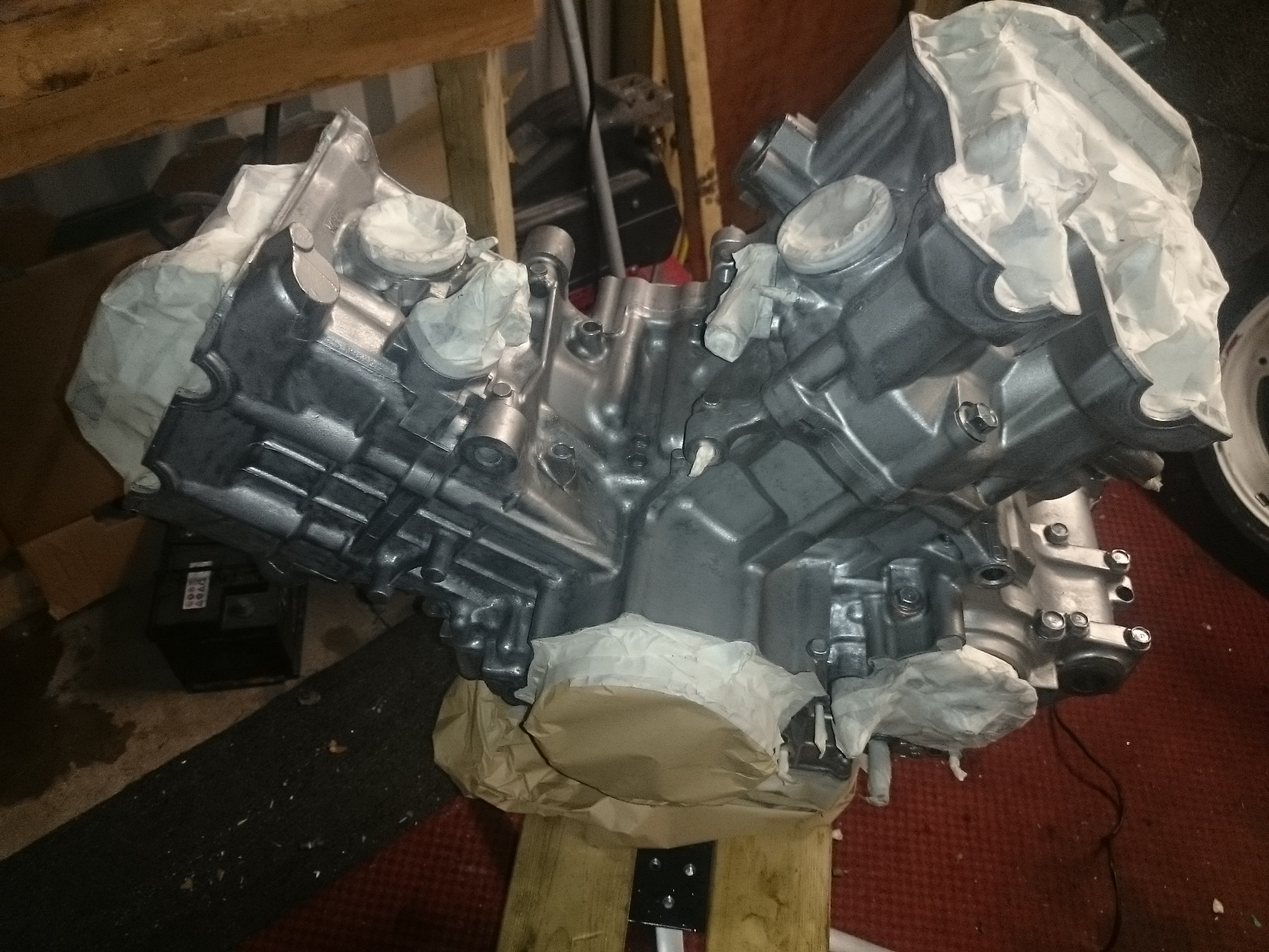

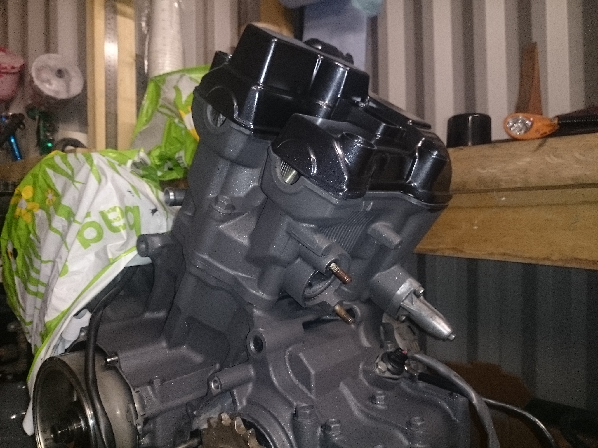

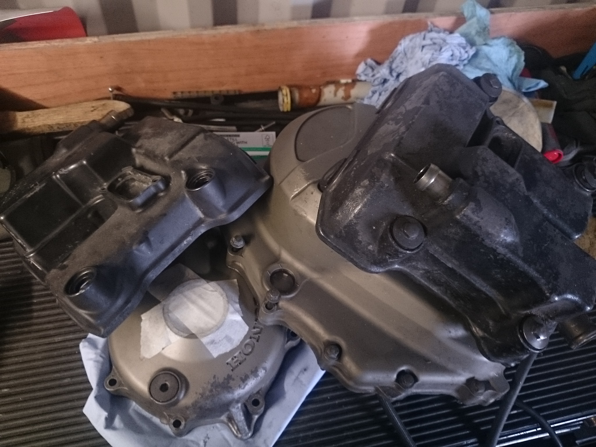

Stuck lump on the bench and started cleaning up tonight.... minging! :lol:
Was going to do engine matt black and cases & covers dark metallic grey... Really don't like the matt black so out of curiosity tried a bit of what I supposed to be metallic black on the block... quite like it so will go with the black in photo on block and then do covers/cases in something as close to the original covers colour as poss.

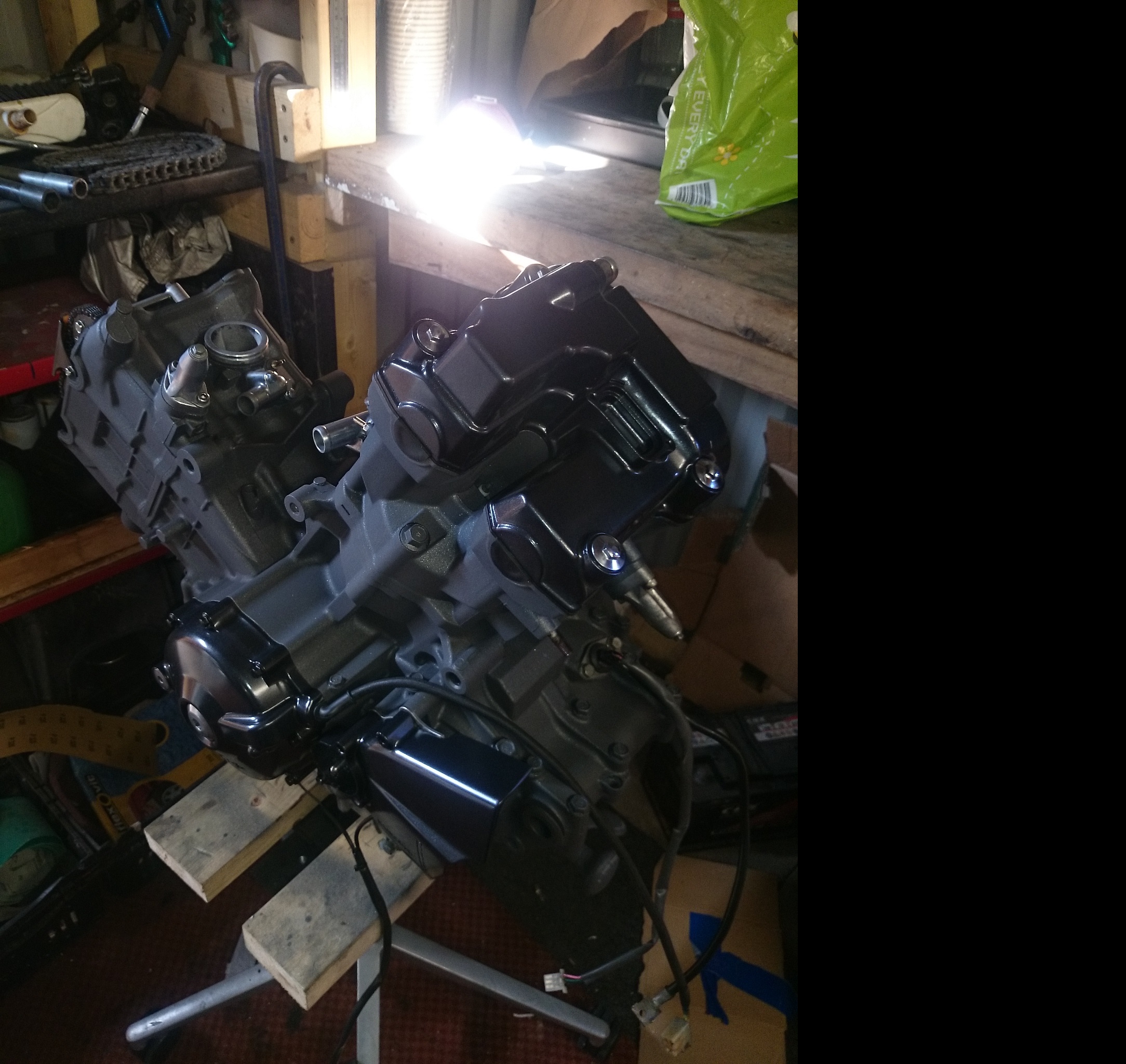

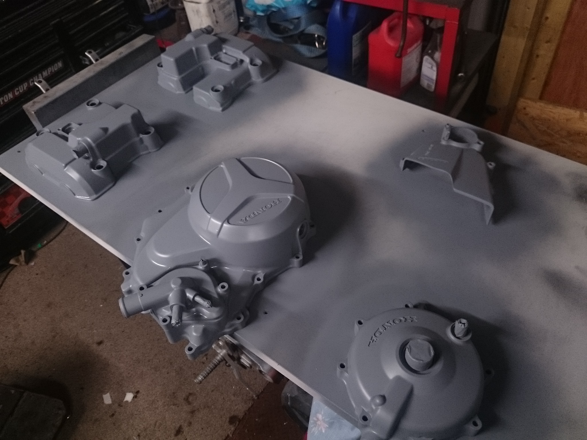

One minute I feel like i'm getting somewhere having painted the engine up.. then I sit down and think about how much more I have to do and suddenly think I haven't really done sod all yet :lol:

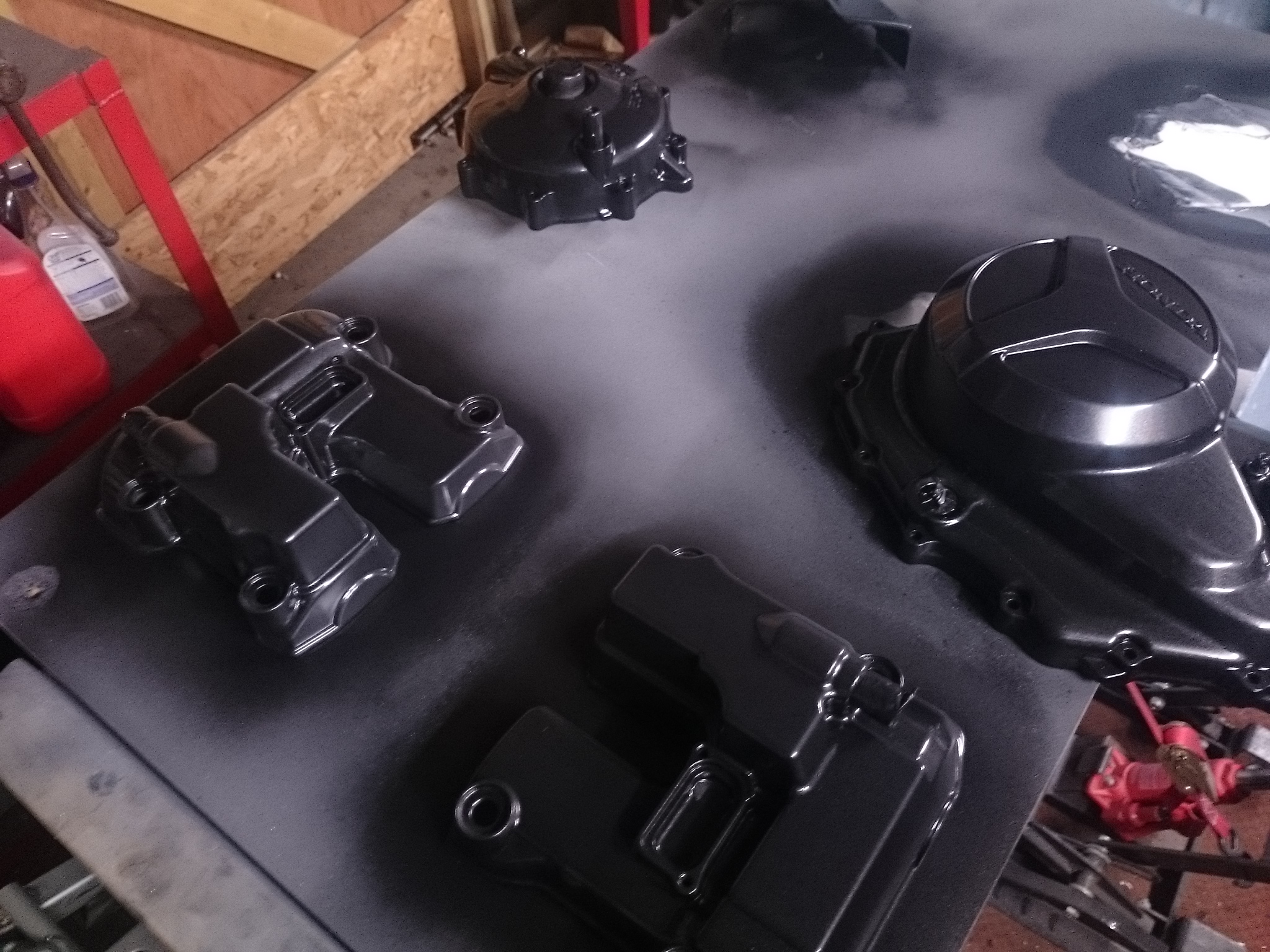

But at least the engine is done... painted the block last night and then did all the covers/cases today. What a mess the cases etc were... one cover was so rough I swapped it for one off a spare engine I have which is 7 years older and with 70k more miles on it.... Happy with how they look although being just rattle canned up i'm not sure how long or well they will last.. don't matter though... when bike gets painted over the winter I will knock another set of cases up into shape properly.
You can see the colours in the photos but the colour on the block isn't quite as light as the photo suggests.. looks a different colour under the camera flash.

Re: It's that time again.....
Post by KermitLeFrog »
Looking good. Well done!
Post by VTR Phoenix »
Engine looks great, nice job, did you use a high temp paint as this will need curing (engine run hot) before it is fully manhandleable.
If normal paint it will start to blister after a while due to the engine temp.
Watching this thread with anticipation, looking good though.

VTR Phoenix wrote:Engine looks great, nice job, did you use a high temp paint as this will need curing (engine run hot) before it is fully manhandleable.
Yes... high temp on block... normal stuff on the rest. Actually.. never used high temp paint before so didn't know about engine needing to be run up to temp to cure... makes sense now though cause I noticed at the mo it doesn't take a lot to rub the paint off lol

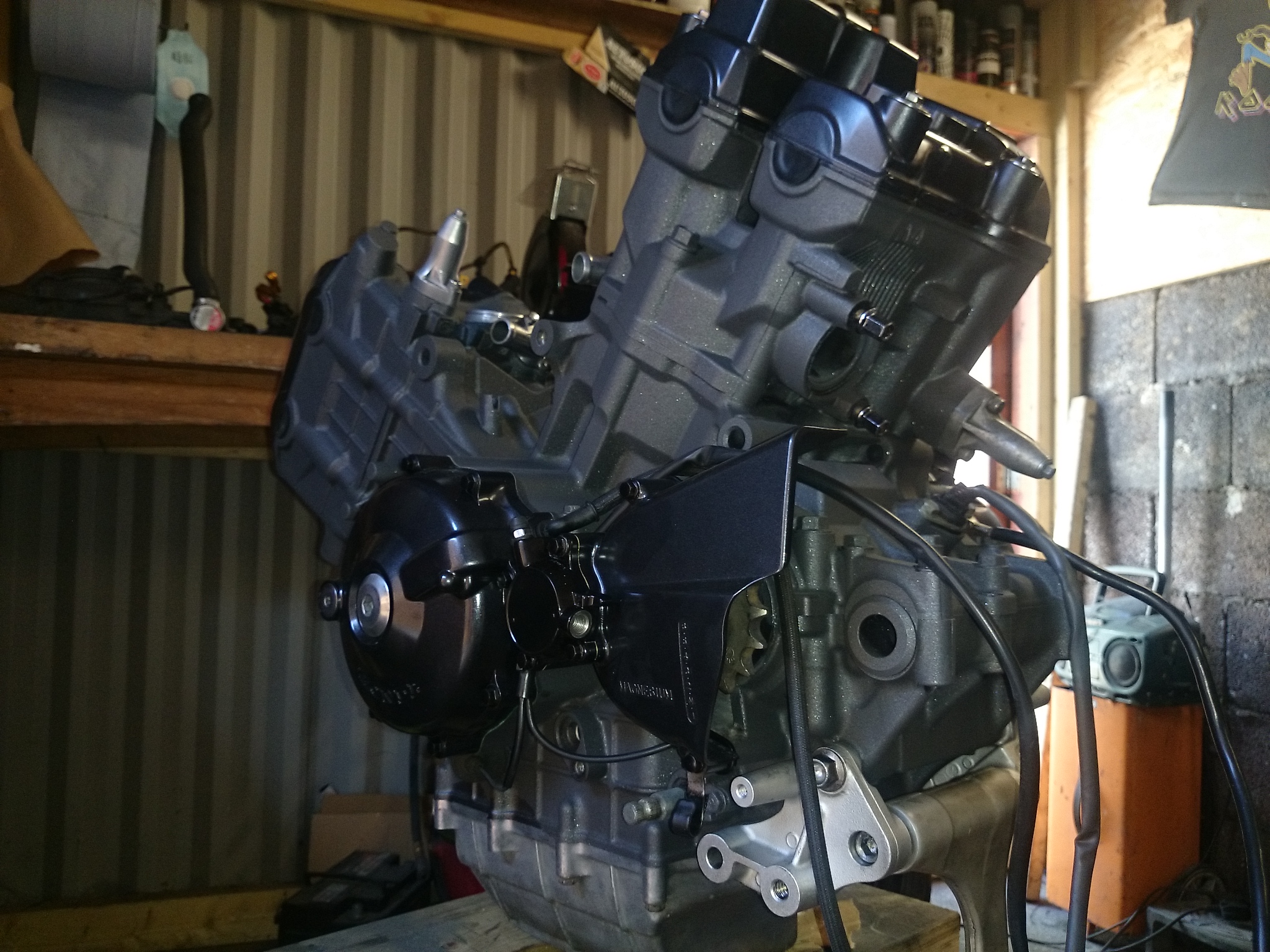

Couple more pics of the engine now that it's coming together... can see the colours better in these

Besides bolting a few more bits to the engine have just been cleaning/tidying parts up the past couple days.. things may slow up for a week or so too.. partly because i'm stuck for things to do while waiting on parts to come back from powder coating but also because I have to sort out getting my old Transit through it's MOT.. oh and a couple hospital appointments (check ups) ... probably won't have van later in week and into start of next week so won't be able to pick frame up even if it is ready..
Have been trying to get wheel bearings to allow me to fit the blade front wheel... no luck :cry: On the bright side... spoke to the fabricators who told me it's no trouble to take 1mm out of the hub which will allow me to fit a slightly larger bearing and in turn fit the blade wheel :mrgreen: Hopefully will have new bearings for Wednesday which will allow me to drop the front end off for work.. they will machine the wheel, either take a bit off the inside of the tube that sits in the rim between bearings or make me a replacement plus knock me up some new wheel spacers. I will try and blag a lift if the front end is done before end of week but failing that i'll have to pick up next week.. which sucks because as soon as I get the wheel back it goes in for powder coating so still won't be able to put a front end on the bike.... hence why everything is slowing up for now.

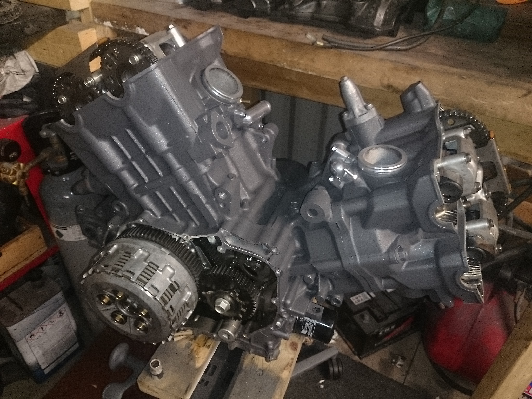

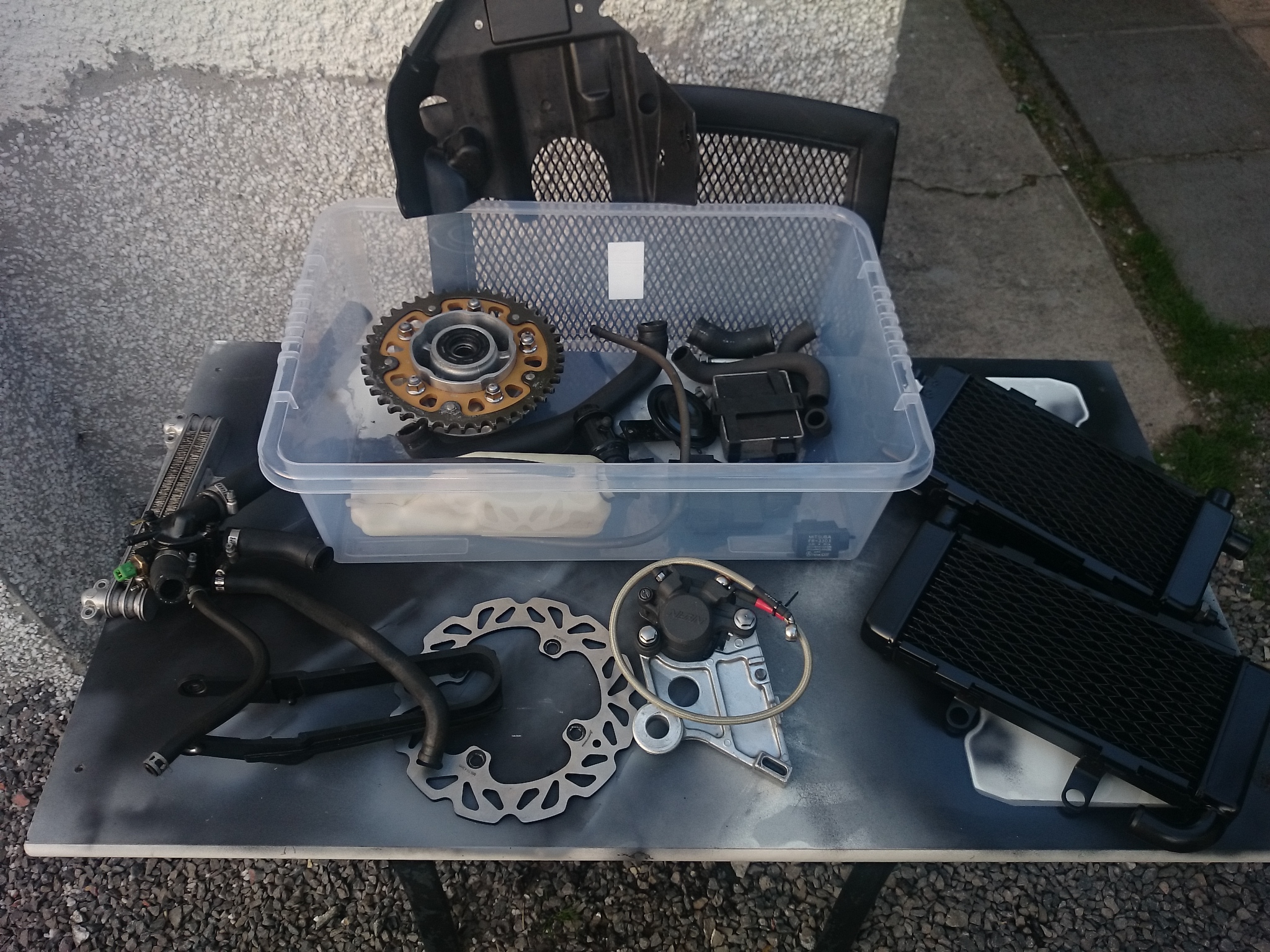

Couple photos of the little I have done... bolted a few more bits to engine and slowly filling my big plastic box up with nice clean or shiny parts ready for refit. Meanwhile i will keep on cleaning bits up starting with the carbs that I pulled a part earlier... it's near 2 years since the bike last run and there was fuel left in the carbs... it's all kinda grim in there with blocked up all sorts :lol:

Shauned71 wrote: Image
It seems you've gone with the same rear calliper solution as I chose in using the blade bracket & transferred the locating slot as well as the brace.
Definitely the better option in my eye's, looks great.
