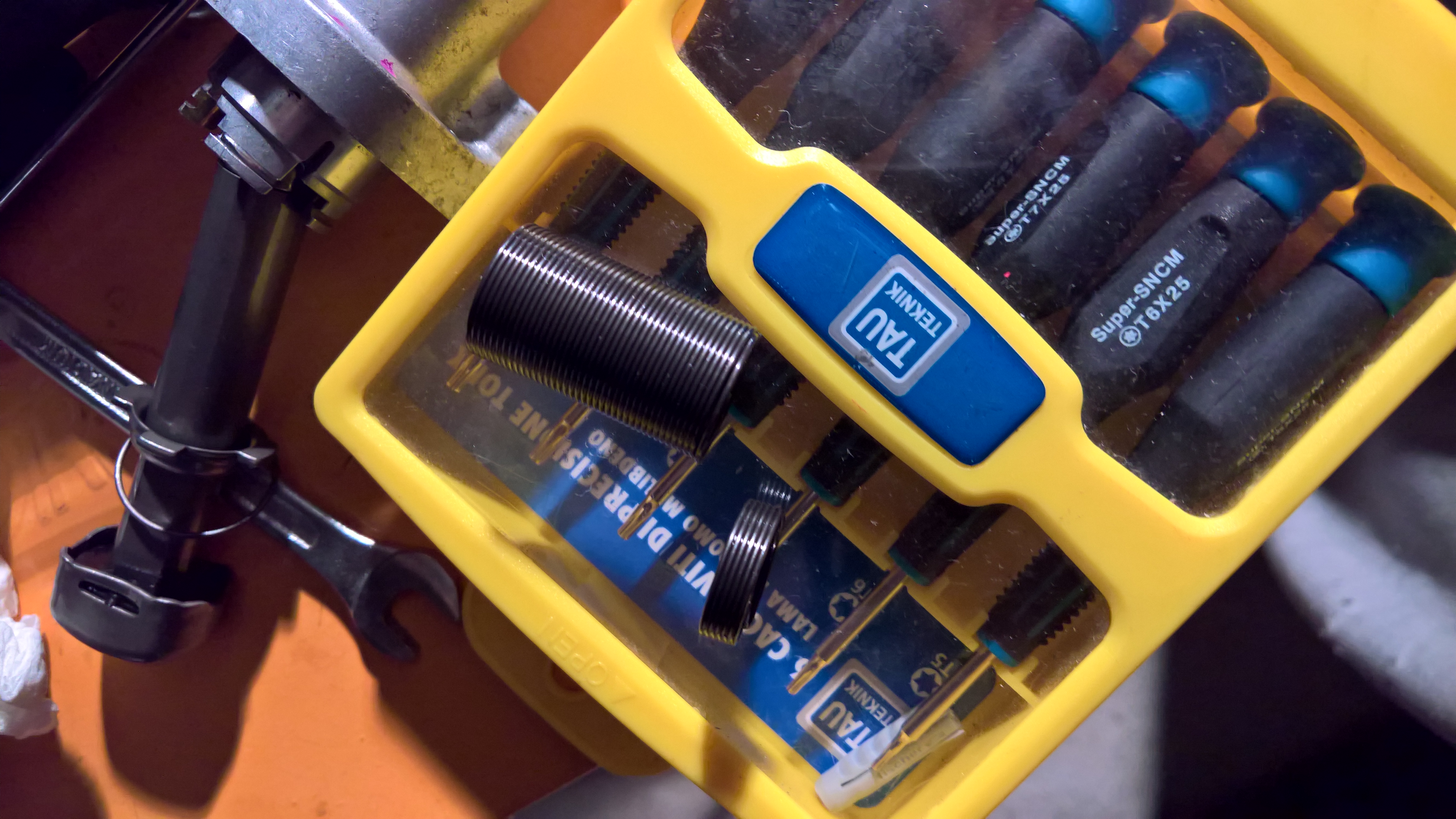

Hello to everybody
Results:
Cct:broken spring (no rust but brown color)
Chain:the FI rocket was 3 teeth backwards
I didn t take off the head because i made some empirical try:
1)turning both the cylinder(one per time with relates spark pkug installed) with spanner they have the same compression.
2) the valve slack is ok(in case of bent valves this shouldn t be)
3)turning fast (by hands and spanner) the crankshaft i can hear the "bang" from the exhaust
So i m quite sure that nothing worse has happened
So it s time for me to buy a couple of mcct in order to switch it on and leave any doubt
Of course this was my first Honda of my life (as courtesy bike of my lovely gsxr),and I m sure it will be the last one

Post by fulviogsx »
Broken spring 9k
Broken spring 9k
