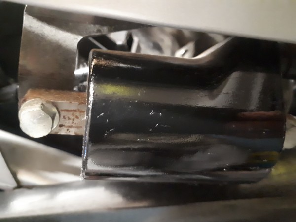

Whats this called.

Re: Reculator/Rectifier
Geeman wrote: Sat Oct 13, 2018 8:44 pm Whats this called.20181013_202213.jpg
HT ignition coil,
