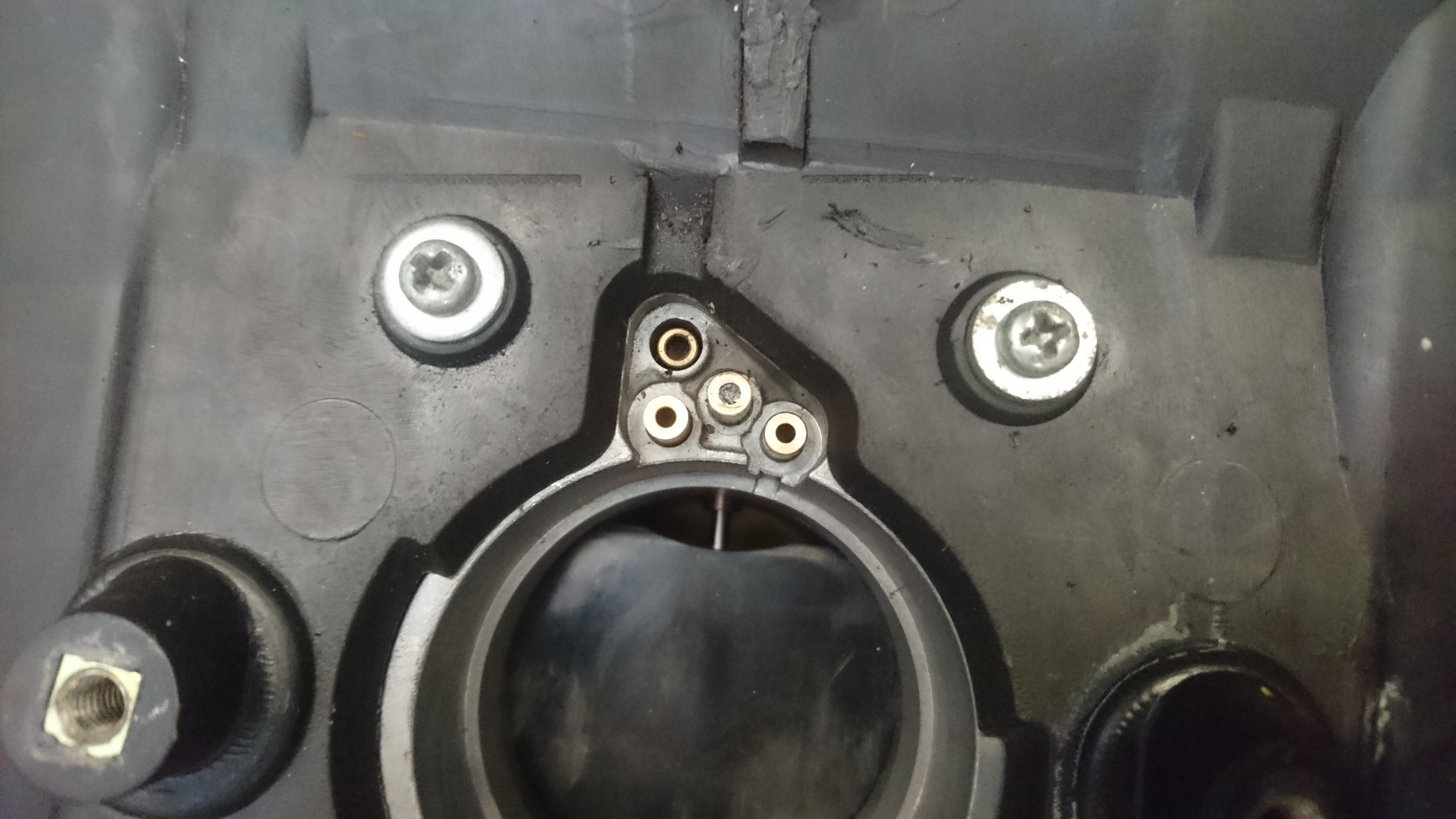

This is why I think it's the air bleeds. From what you describe it sounds similar to my bike after the engine and airbox work. Wide open it was fine but on a part throttle it felt sluggish. It turned out it was very lean. And that was with the airbox lid on. The first thing Andy did was block the main air bleeds and it ran way better. We sorted the main jets and needles then did the same with the open airbox. From memory all it took was going up a couple of sizes on the mains with the lid off.
Here's what my logic says happens with a stg1+ engine. Big cams, big valves, porting etc mean it sucks way more air so it runs rich - more air sucks more fuel. On WOT that's easy, just drop the main jet sizes. I run 165/168 front rear. With the lid on they were 155/158, I think.
Without cutting the carbs open I think the air bleeds draw air from the airbox down and out through the hole in the carb throat while the air passing the butterfly pulls fuel from the float bowl through the jets and out the same hole. With WOT the vacuum created in the carb throat pulls enough fuel in to deliver the right mixture but on a part throttle it can't so the air through the bleed leans the mixture out. Block that and the air passing the butterfly is the only air in the mix. This is only a problem when a Storm is able to suck a lot of air. And I'm pretty sure it's why Tony couldn't get the MWR filter to work, which I'm running happily.
The pic below is of the front carb from the front of the bike looking back. Middle tube is the main bleed, right is the pilot and the left is the enrichment circuit. Or maybe the other way round, I can't remember. If you look closely you can see the middle hole is sealed.
Check your carbs Fabio and if one is blocked and the other isn't that's your issue. If both are open I think that's your issue too but you would have had to misplace something otherwise it wouldn't have run so well beforehand. If they're both blocked I'm stumped.

aaah i see said the blind man... mine arnt blocked and never have been since owning it... also my jetting since getting this engine with its matching carbs is so different to yours
like miles different. im running 48 pilots and 190 mains front and back and its always been super clean tho i run an airbox lid and gutted box inside..

Actually the bleeds sit above the emulsion tubes and their purpose is to add air to the fuel being pulled through the main jet.freeridenick wrote: ↑Wed Apr 03, 2019 10:28 pm
It does this because the "emulsified" fuel is easier to pull through the jet.
The old example of this was "think of drinking through a straw. A carbonated beverage is easier to suck through the straw than a non-carbonated beverage."
This is also why you go down on the jet sizes when you plug the bleeds. you are now drawing straight fuel not an air\fuel mix through the main jet.
