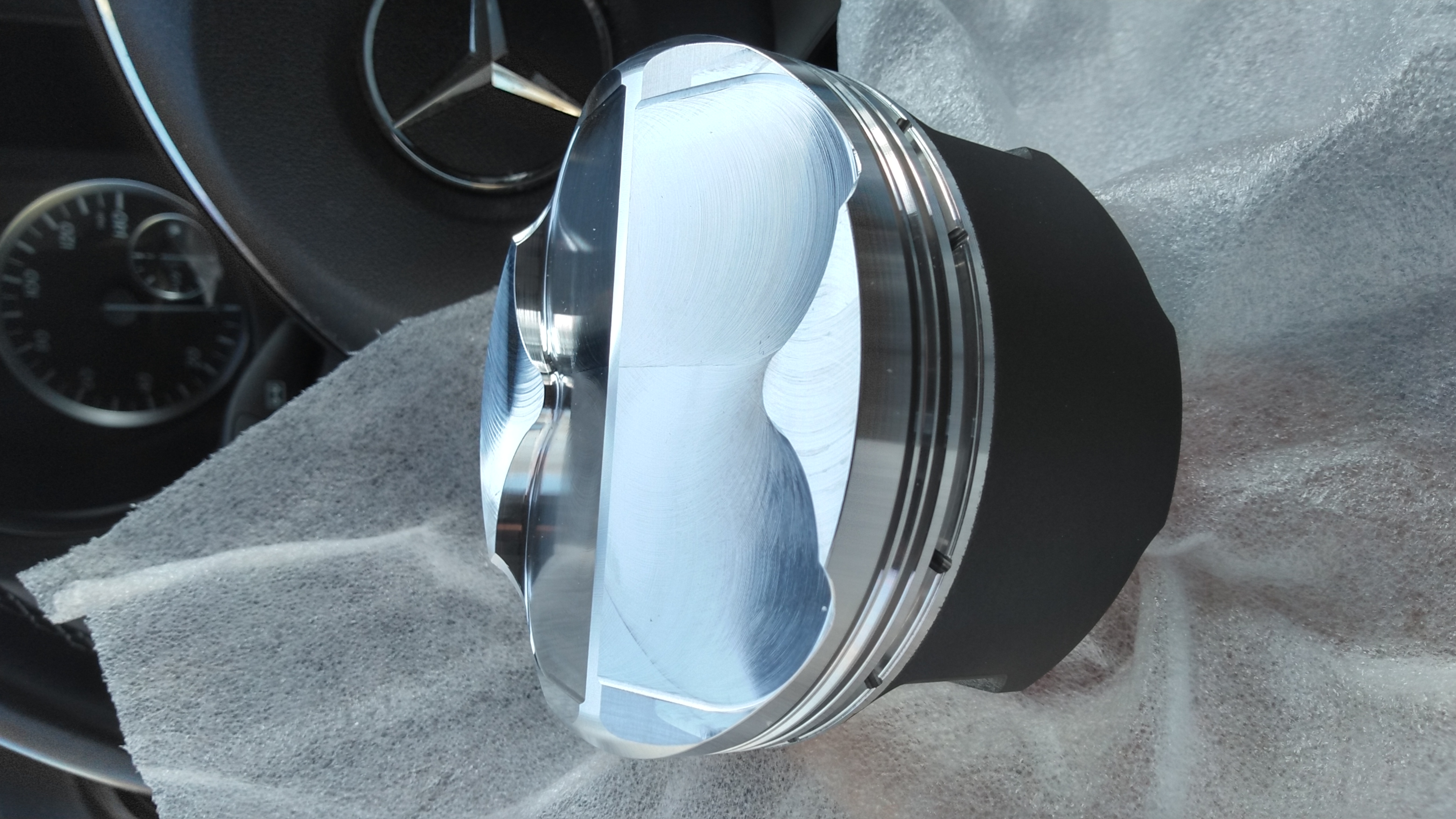

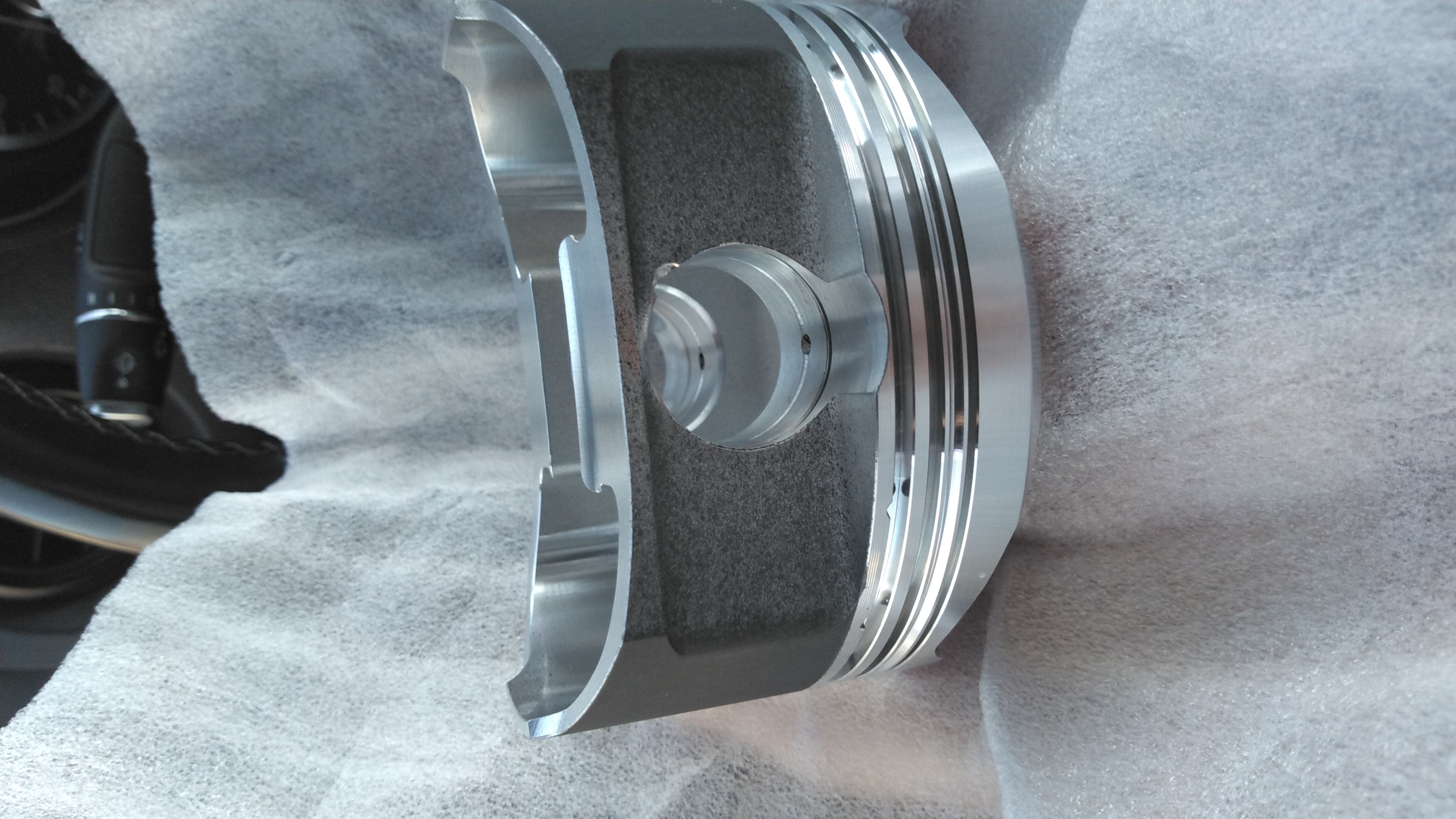

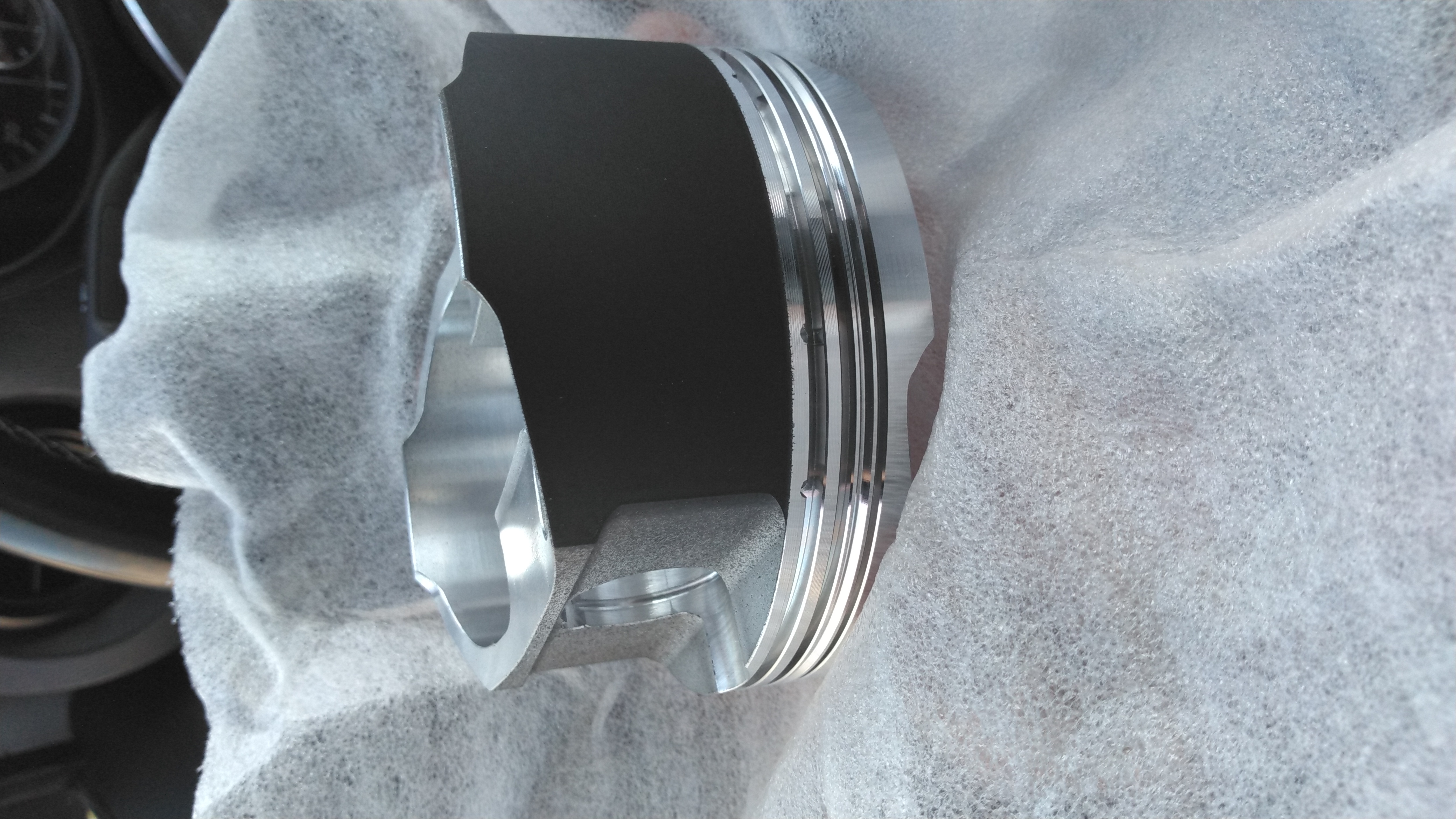

And here are the pistons from JE...a thing of beauty isn't it!!

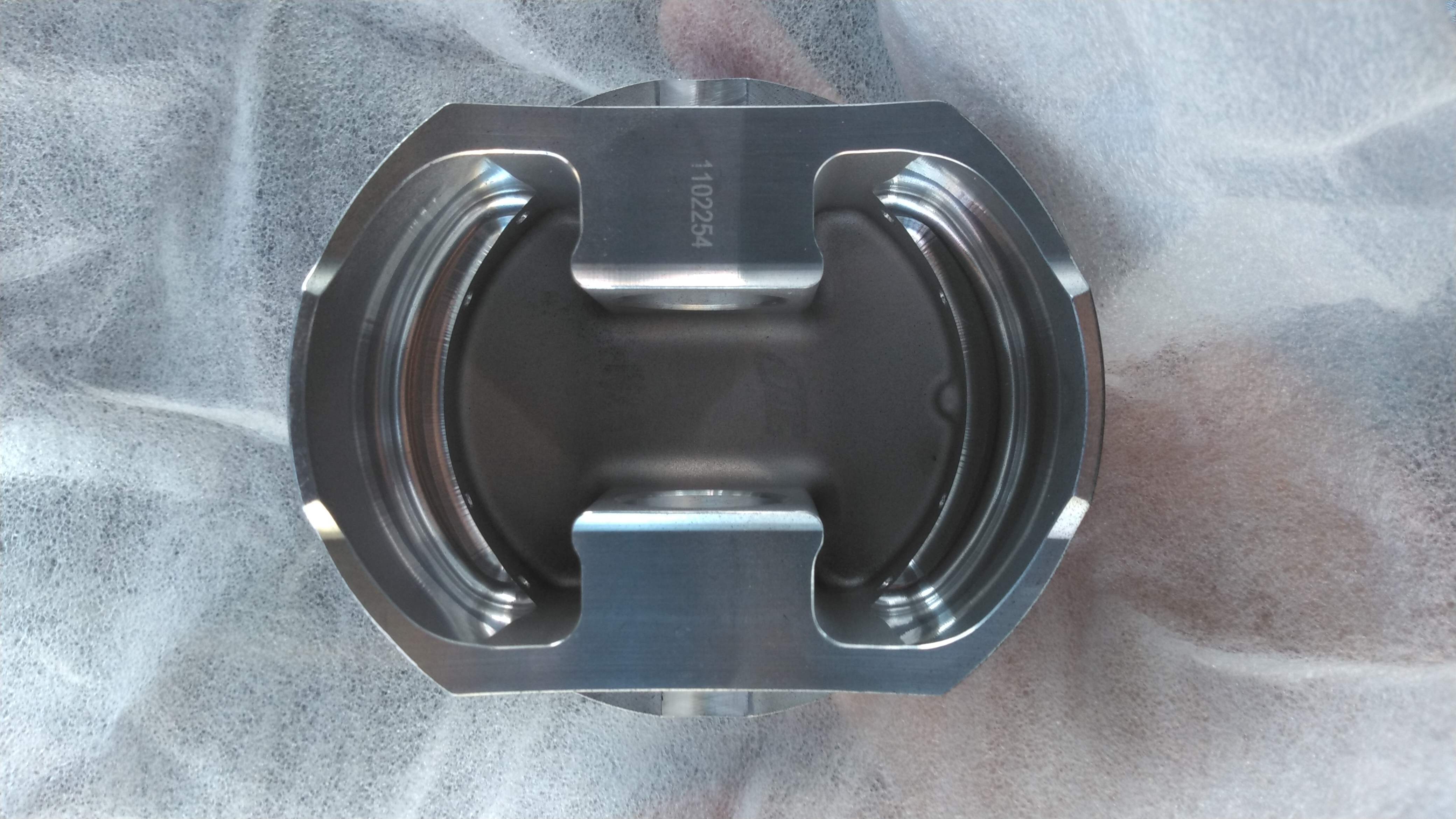

Post by Ace VenTRa »
99mm's of happiness in a box!!

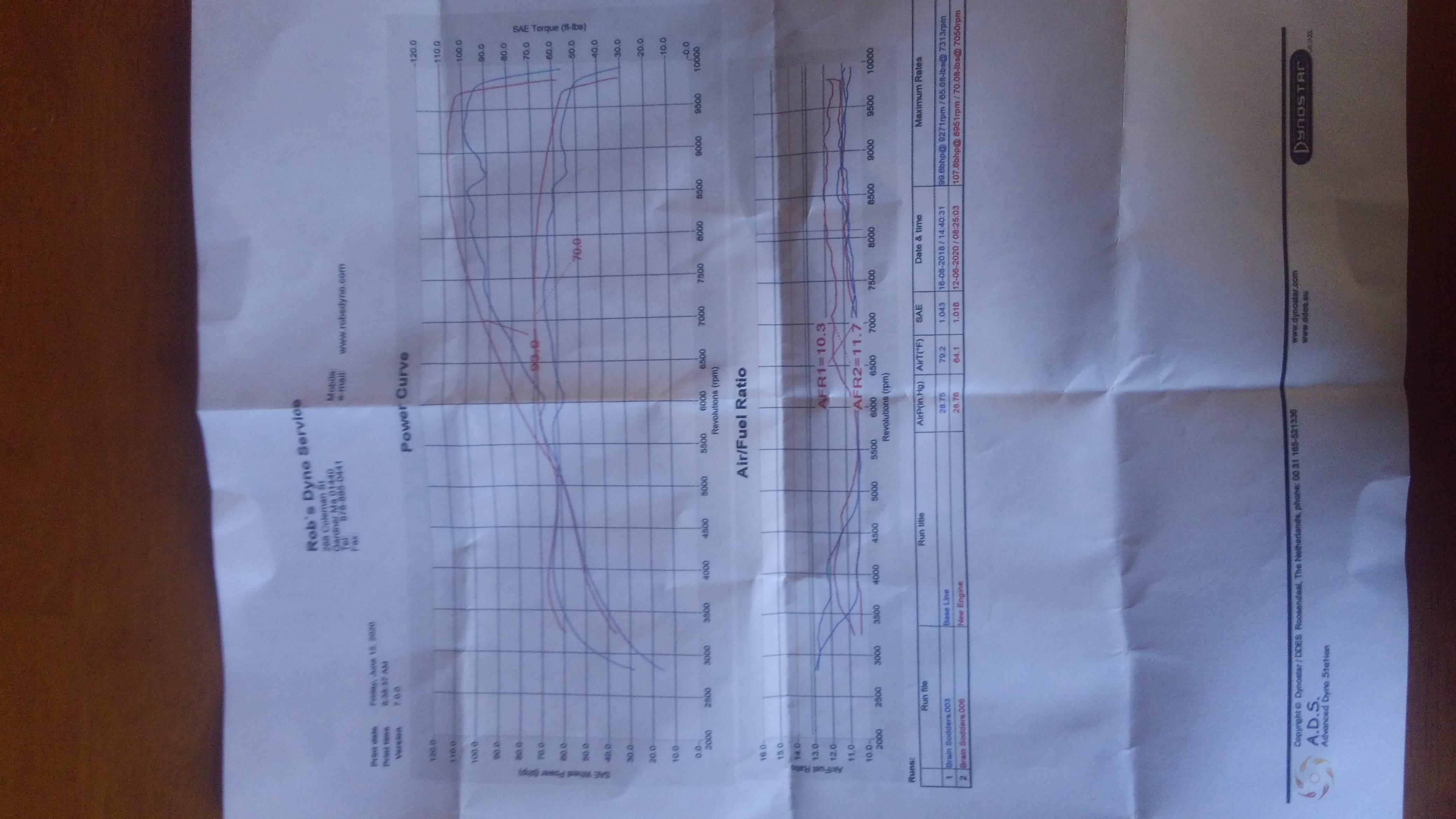

Alright here it is,
I finally had a chance to get to the dyno and the results are in.
Jetting is still way too fat so I'm working on that today but the hard numbers are:
HP: 107.6 @ 8951 =+ 9 Hp
Tq: 70 lb/ft @ 7050 rpm = +5 ftlb
Essentially it is making more power and torque everywhere with respectable horsepower gains over the last session. The next dyno run is in September and I wager we'll see 72lb ft and 112 hp, here's hoping! More importantly, this is very drivable hp with big increases in power after 5500 while using a completely stock airbox and TB slip-ons. What is kind of cool is that it makes its power about 300 rpm or so sooner in the power band and there are no unusual anywhere. Essentially, it is exactly what I was hoping for, more power that sustains itself better and smoother.
