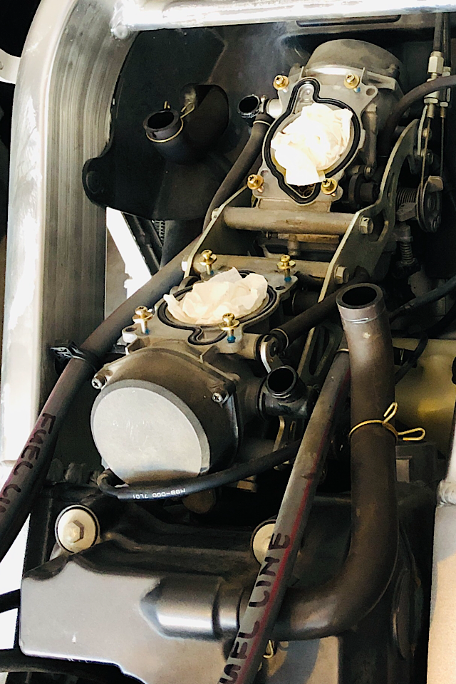

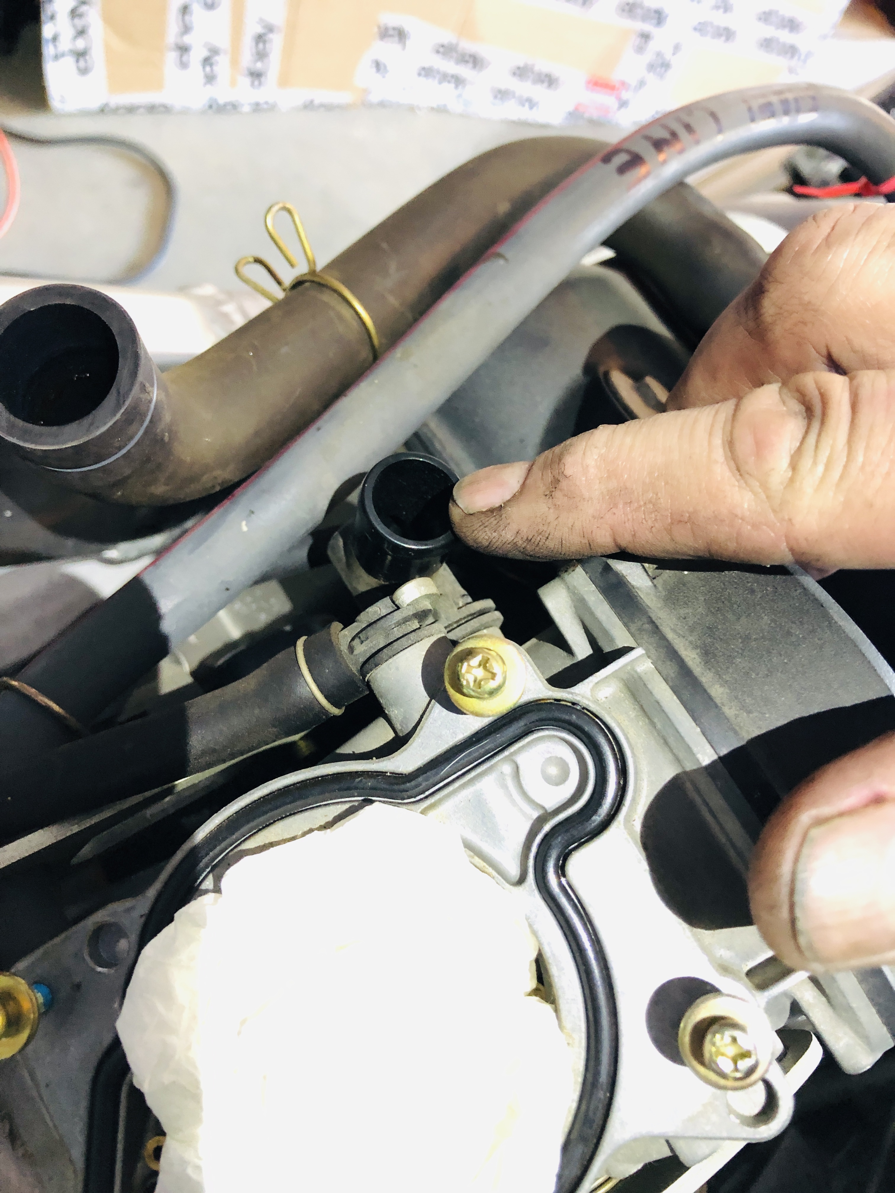

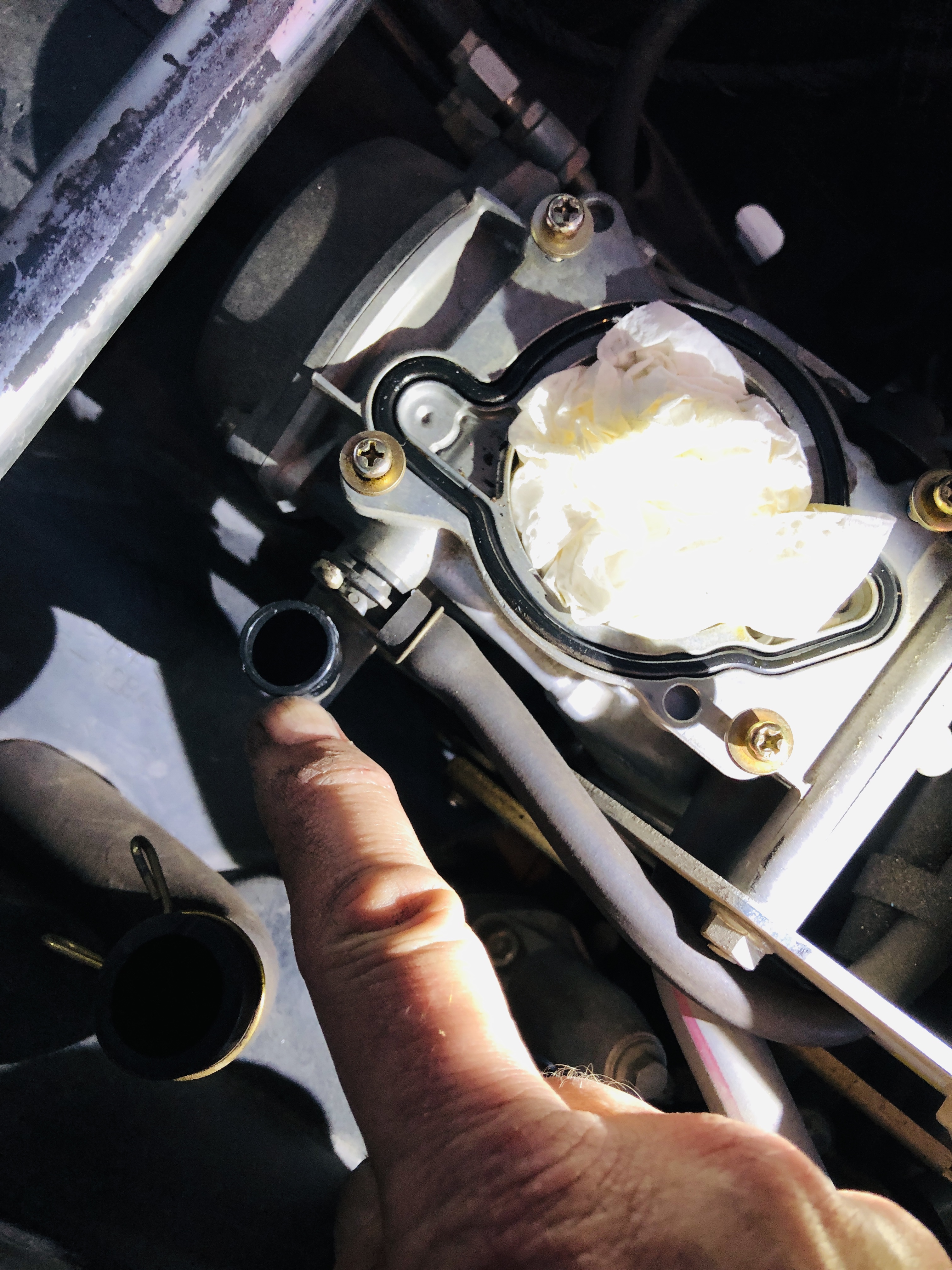

These were the tubes that connected to the small vents with the mini filters in them that I'm point to.
On the air box I am sealing that tube off but I wasn't sure what I should do with the port fitting I'm pointing at in the picture so any help on this would be appreciated.
The actual crankcase tubes will be fitted with a coupling tube for a small pod filter so each carb can breath if that makes sense.
The two hoses you see in the picture below with the hose clamps still fastened on the end coming odd the valve covers I would think are the crankcase tubes, no?
Those two hoses were planned to have pod filters attached so they can breath.
Those need to have a filter attached. They feed the back side of the slide diaphragm allowing it to move.
The reason for the filter is that because of the lift holes in the slide, it is a direct path into the engine.
If left open (not attached to the airbox or the foam sub-filters are missing) you will suck unfiltered air into the carbs.

Re: Say hello to my little friend.
You can seal them easily and cheaply with a section of foam filter material wrapped over and held on with a hose clamp.
It's not a very elegant solution but you can't see the attachment once the tank is back on.
The little pod filters on the head breather pipes will drop oil occasionally, place them where it can be wiped down and won't contaminate the rear tyre.
