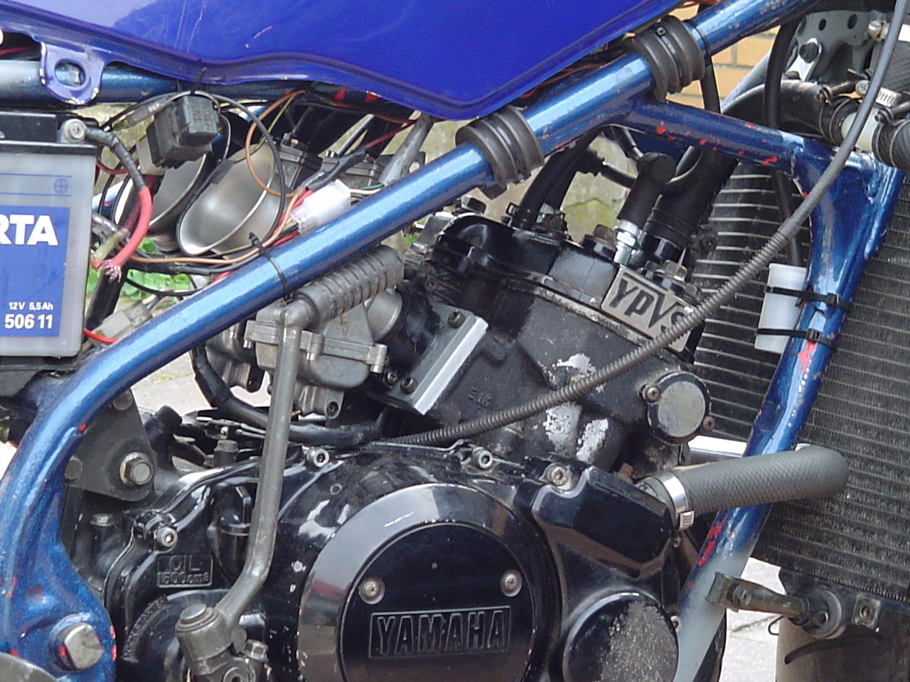

Martin, that was also the direction I was imagining, to just have a pickup on the crankshaft.
If you could post up some images of the pickup, that will get me thinking.
Also what carbs are you using there? They look designed to be used at a steep intake angle (with the float bowl and slide still horizontal and vertical), where as mine have the float bowls at such an angle that I am not sure they should work. Last owner said he adjusted the float height to compensated, but it doesn't look right in my logic.

My setup wouldn't help you as I went for the dark side (aka cheap and dirty).
I removed the magnets from the rotor, so the inertia was reduced significantly but let me keep everything else in place (mounting plate & pickup). Just the stator had to go, too, and voila - minus 1.6kg accomplished.
The Ignitech offers a wasted spark elimination, so I can run two independent HT coils.
Also have the shift light and shift sensor option active (which enables upshift without clutch).
The ignition & power valve maps are 3D (advance/position vs rpm vs TPS).
Other weight savings were done by an R6 front end (which shaved off 6kg from the usually used RGV250 lump) and DIY aluminum tank/rear subframe.
Designed & welded the pipes on my own, too.
The carbs are RGV250 VJ21A (the early models) which have 32mm.
The later VJ22B and Aprilia RS250 had 34 mm but a lot of unnecessary stuff like solenoid air valves. They're much harder to set up.

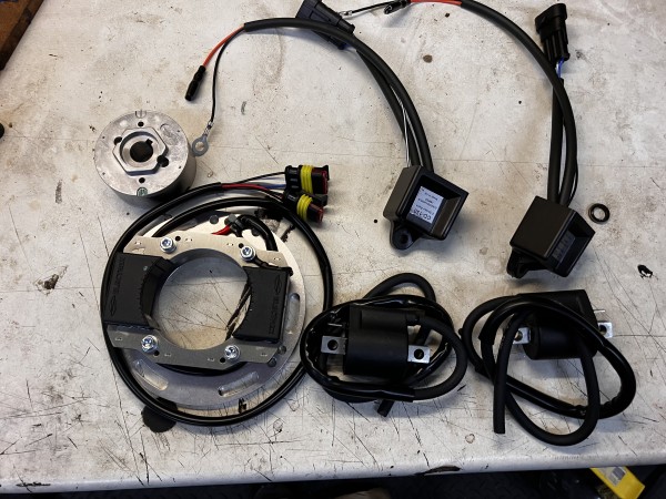

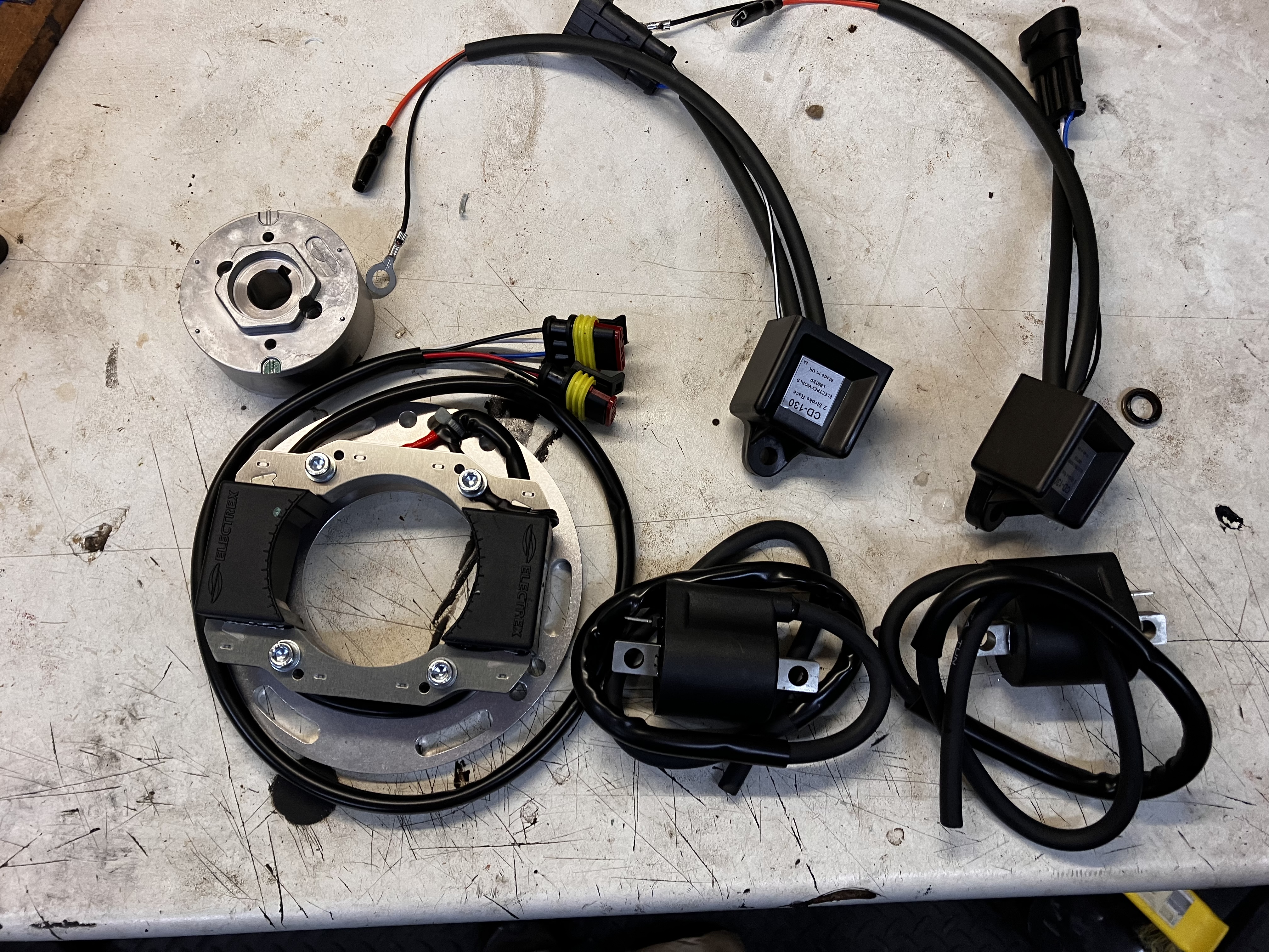

Re: The RD400 drag bike
After trying for ages to work out if the FEMSA ignition was wired correctly or working in anyway, i gave up and bought a new ELEXTREXWORLD ignition system designed for race TZ Yamahas (no battery’s) but also fits and works for tuned air cooled RDs.
So now I have sparks

That's looking more like it AlAMCQ46 wrote: ↑Thu Jan 26, 2023 8:47 pm 2B14D541-F53F-4816-A5FF-C0E692DAB25D.jpeg
After all the time off for weddings, New Zealand Holidays and Christmas, I am back onto it with the RD400.
So now I have sparks, just have to sort out some kind of fuel tap solution for the PW50 tank.
