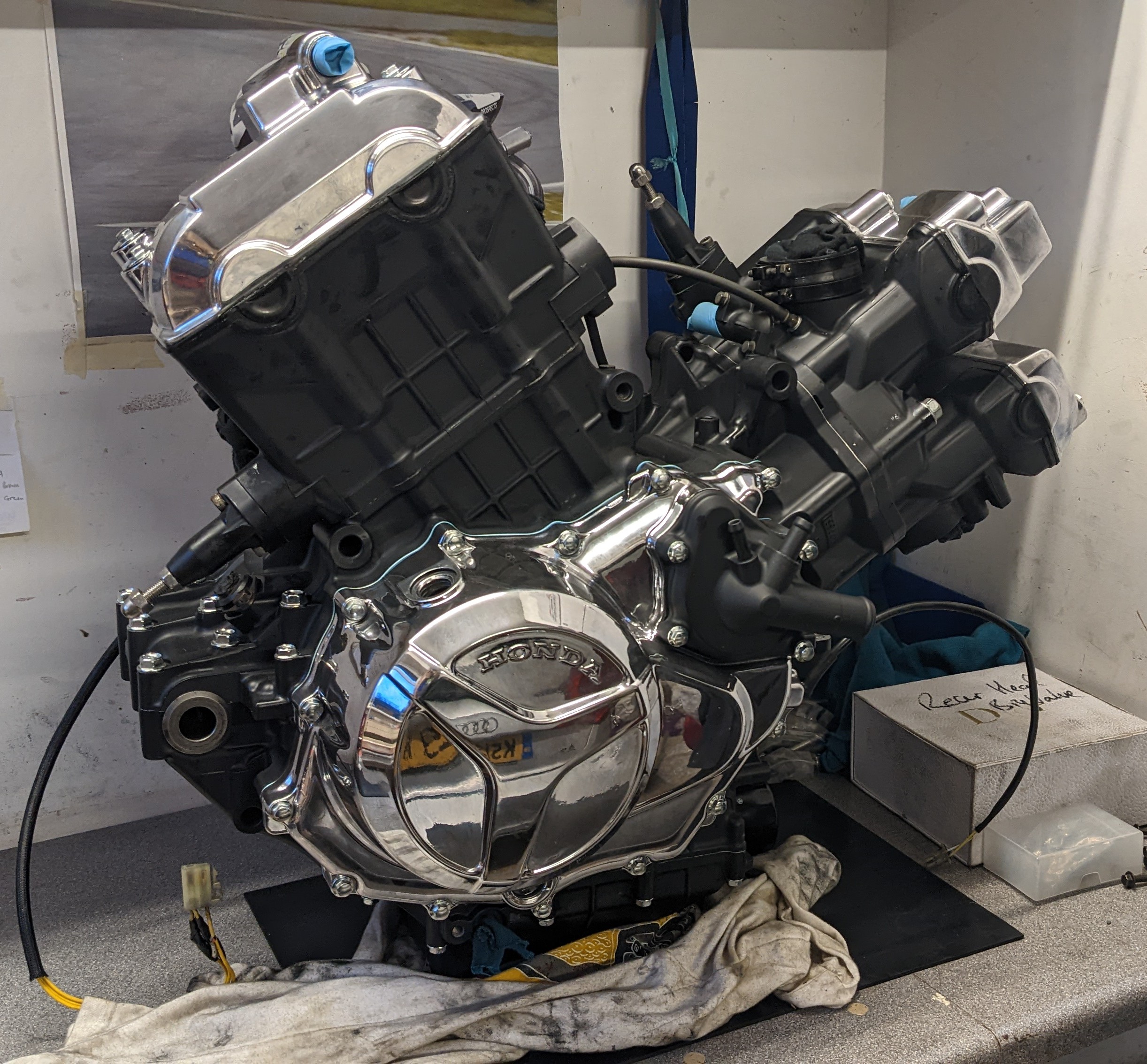

Finally, and it's about chuffing time, my engine is more or less finished. Just a double check of the cam timing to do and then I can stick the covers on and get it in the frame.

We'll that took somewhat longer than expected. The cam timing was a learning curve: definitely something that's easy to comprehend but less easy to do. Some lessons learned but a great feeling to have it more less buttoned up and ready to go in the frame. I might actually have a running bike by the end of the year.
Re: From 107 to 128
WOW that looks amazing Nick :thumbup:

Re: From 107 to 128
sirch345 wrote:WOW that looks amazing Nick Image
I bet you're pleased to be at this stage,
Extremely pleased Chris. I think I've got everything collected together to get back to road trim so plain sailing from here on. Image

Re: From 107 to 128
If it goes like it looks you'll be happy :thumbup:
Re: From 107 to 128
be shame to cover that engine up :eek2 :eek2
