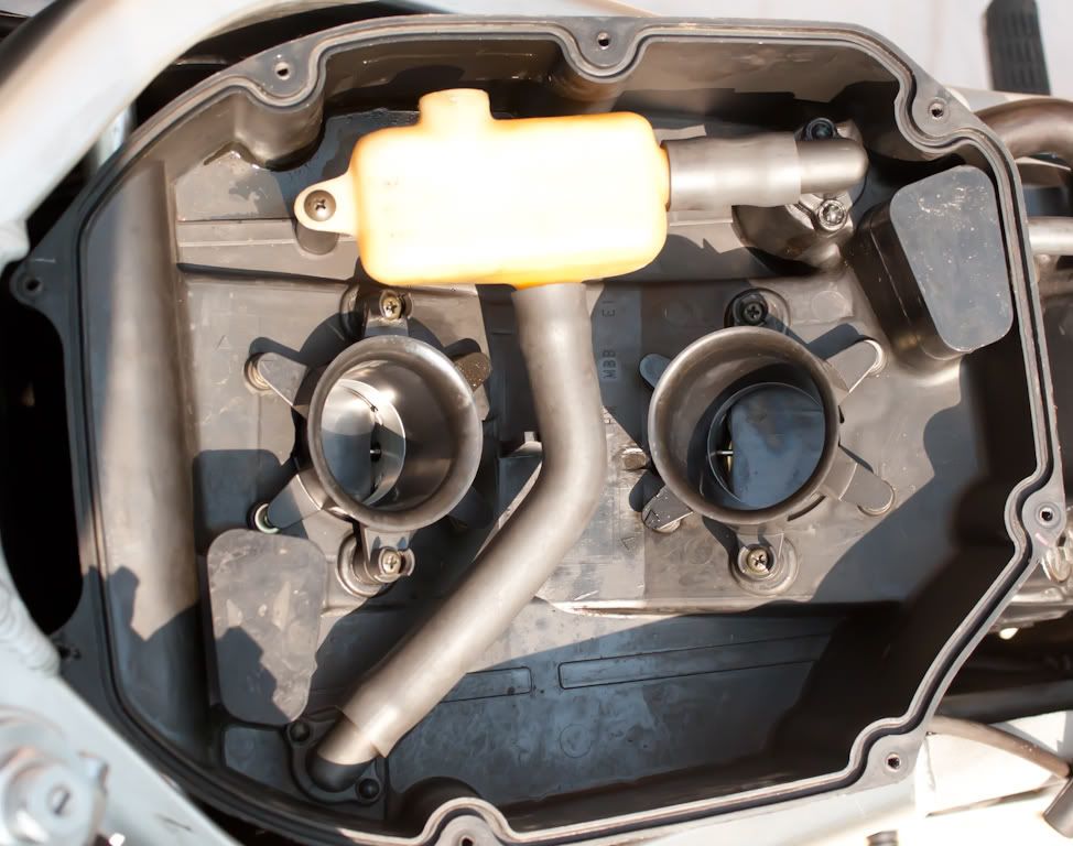

I too attempted the TPS today, got her all stripped down, then bottled it as I dont really have a scooby what Im doing...Must buy a bloody haynes!
So, next step, have a look at the idle jet, again, bottled it lmao.
But, in the air box was this mucky looking oil, is this normal?
top left... So all I did in the end was adjust the idle and wash and re-oil the air filter.

yeh the oil is normal, just give it a wipe when you have the lid open, does no harm.
it's from the breathers.
wtf bottling it lol, theres nothing to it! get on with it you poof!
if you get stuck give us a ring. pm'd you my moby.
