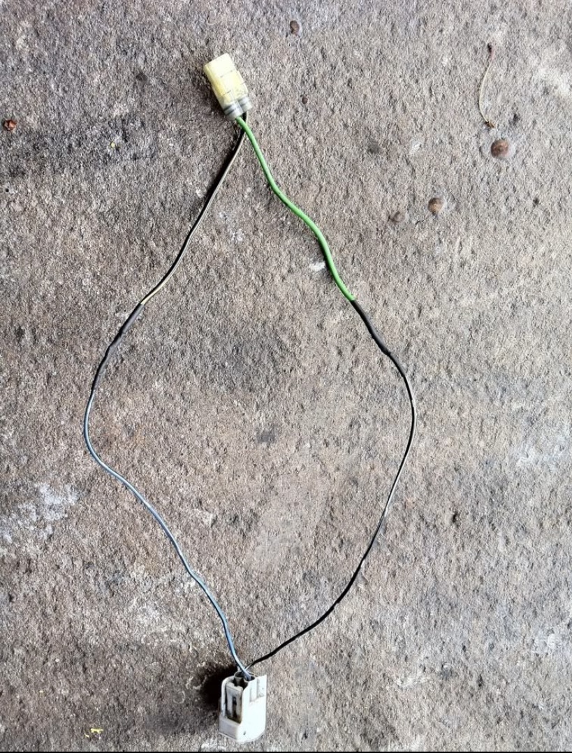

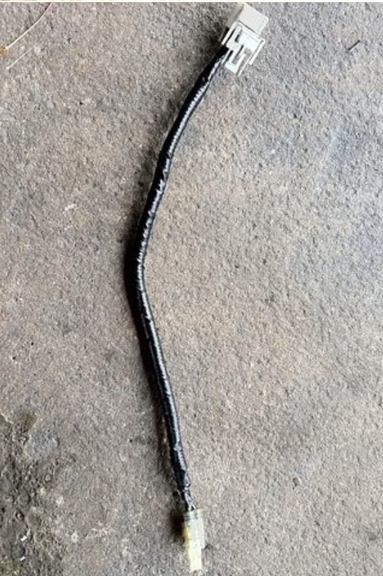

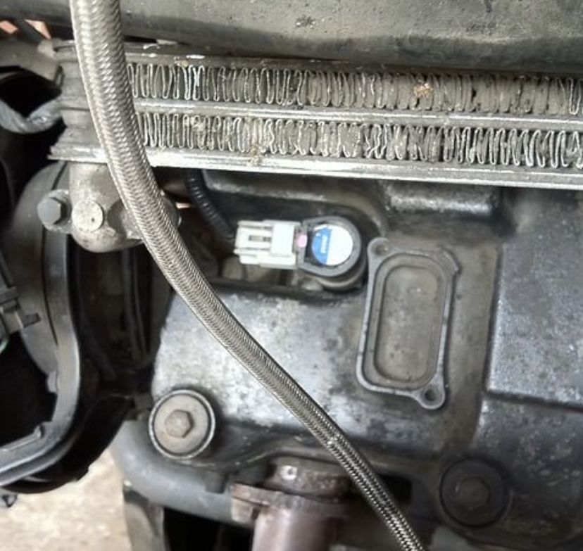

hey there is no pics l :D need more info
Re: How to fit stick coils
Hope this helps took me ages to find these old pics
