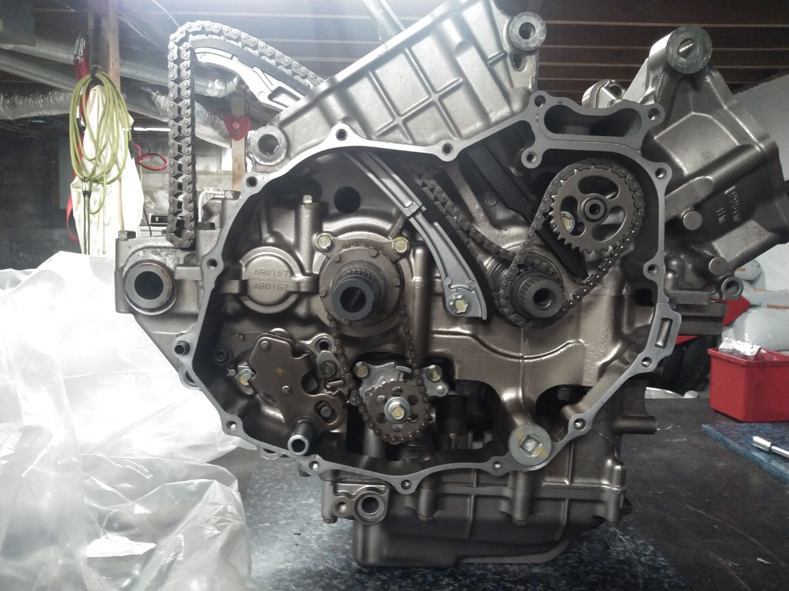

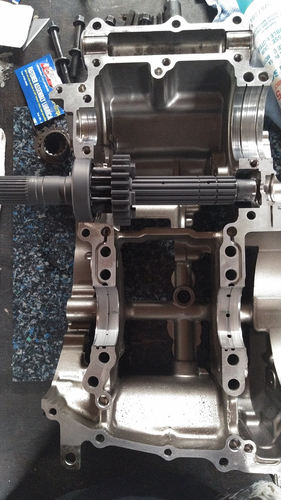

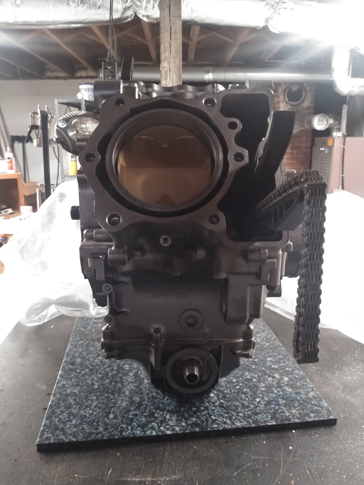

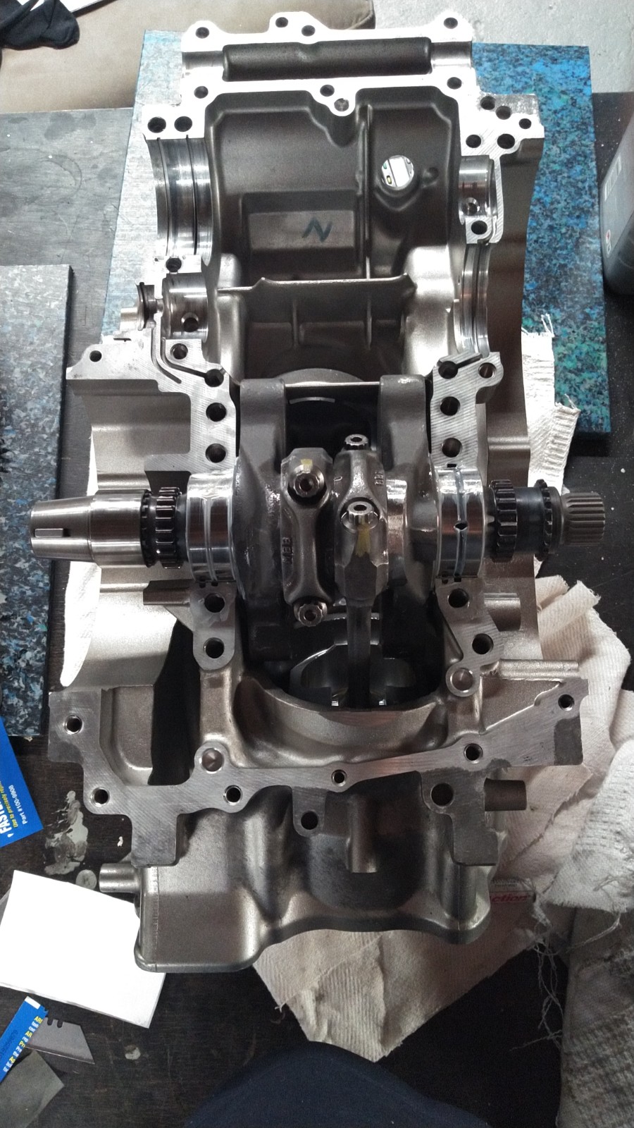

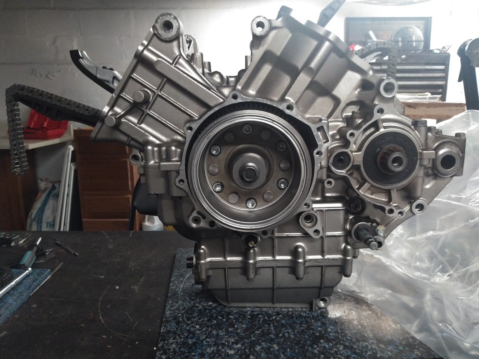

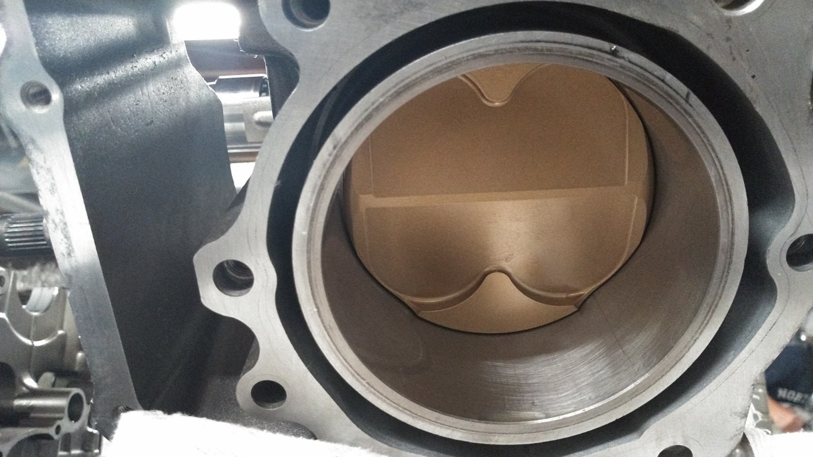

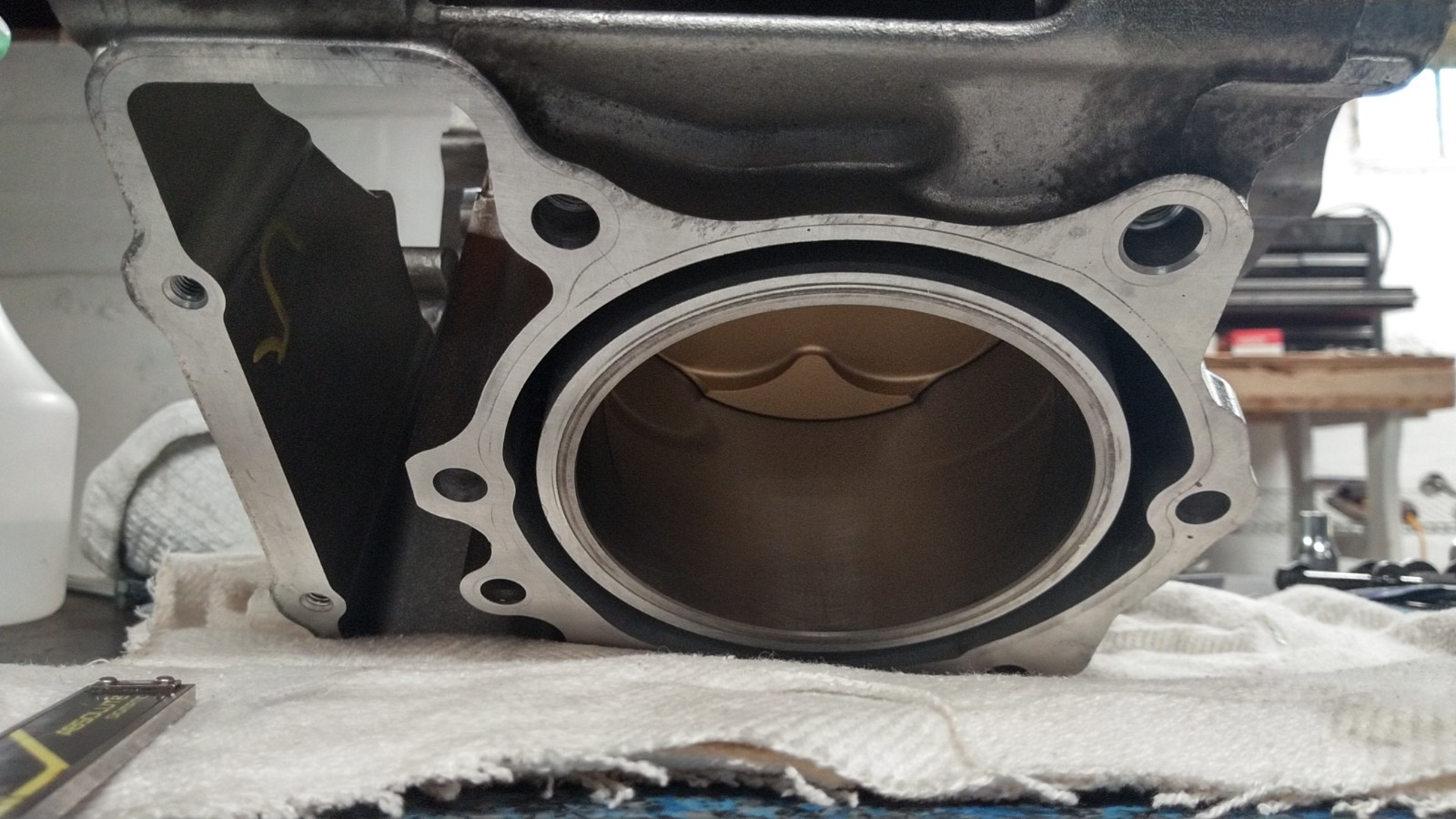

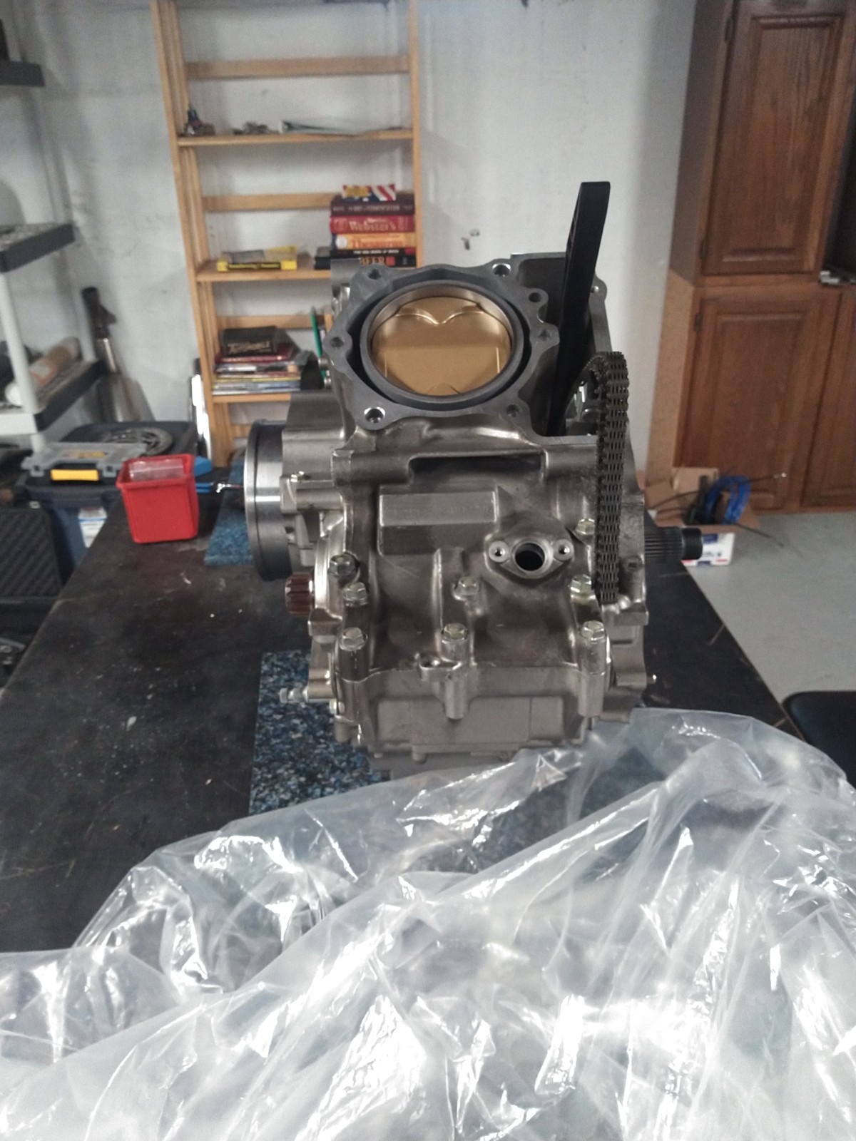

And here she is well under way again. The balanced assembly is back together and in the block with the 99mm JE's, happy as a clam. Everything is back from cryo treatment and the pistons have their ceramic coating on top for good measure. The RC trans is coming along nicely and I'm just waiting on some circlips and a gear that is being back cut. There is a noticeable difference in the ease of assembly with polished journals and resized rods, it was smooth as butter on the last build but this one takes the cake...

Good to hear of your further progress, it's all looking great
Re: Bigger Bore Etc
Superb, only wish I had your skills and confidence. Well done that man
Re: Bigger Bore Etc
Well done so far, hope the build goes smoothly, and I'm looking forward to hearing it run

Cheers! It is coming along, I can't wait to fire it up with the high compression....

No joke, I'm salivating at the thought. But, I noticed today that I managed to complete an entire season of riding without breaking anything....So, I thought I might let it go for one more before I pull the motor. I added the delwood stacks a K&N and for kicks I added a dynojet kit that I had laying around and...a home made flow control for the main air bleed and it really woke things up. At the last run I made a whopping 73.8 lb/ft of torque but only 106 or so HP. All gains are after 5k rpm and I lost nothing below that. I suspect there is a bit more in there I just need to get back on the dyno one more time. So, I am quite happy with it but seeing as how I have the CBR almost back together, I think I'll wait till it is completely track ready before I yank the motor out of the V. Essentially I have the short block complete I just need to swap the heads and peripheral stuff and she'll be ready to go!

And in the meantime you can still look at the tops of the high comps and rub your thighs in a Vic Reevesy sort of way.
Once the heads are on you can't gloat over them any more.

Wow, that looks very nice! I hope you don't mind me asking some question regarding your builds, since I have the intentions on rebuilding my own next year!
Do you know by any chance which material is used for cylinders? It looks like most of the times people are saying that its "nikasil" coating, which you cannot bore, the only option would be to recoat the cylinder, yet honda offers .25 and .50 oversize service pistons and rings, which makes no sense if cylinders are "nikasil". Manual doesn't have any info on materials. You said that your cylinders were bored, which makes me come to a conclusion that this engine has "alusil" for cylinders. Or did you have your engine resleeved actually?
I assume those JE pistons are a custom order. Which coating did they use? As far as I am concerned, pistons for alusil cylinder have to be iron coated.
What is your piston to cylinder clearance?

Re: Bigger Bore Etc
There's no coating on the bores. They're iron, so can be bored then honed to an oversize. There's no trick coating on the pistons, either, aluminium alloy.
Piston to bore clearance should be as the Haynes manual, similarly ring end gaps.

Ok, so, as far as the bore goes they are not coated in any way. They are an iron sleeve that is cast in place and could be bored out for a new sleeve but I think it would be a lot of effort without much gain. The bore is 1mm OS at 99mm and the pistons from JE are the same as they offer in the catalog, I just asked them to make them 1mm bigger. They were happy to do so.
The coating on the skirt is a proprietary coating from JE that I'm sure is some kind of Moly coating, maybe they spec it out on the web site but I haven't checked. The coating on the tops is another proprietary thermal coating from a different vendor that I use for cryo treatment, coatings, any engineering issues or theoretical problems that arise. JE also offers a thermal coating for the tops and it's basically a standard option at this point but it is not the same as what I have. If you want what I have I can point you in the right direction.
As for clearances...do not under any circumstances go by the factory manual or any other. The same applies to ring gap. The reason for this is that the JE pistons are forged and require a piston to wall spec that JE will provide you with but in my case I have mine set at .0025.
