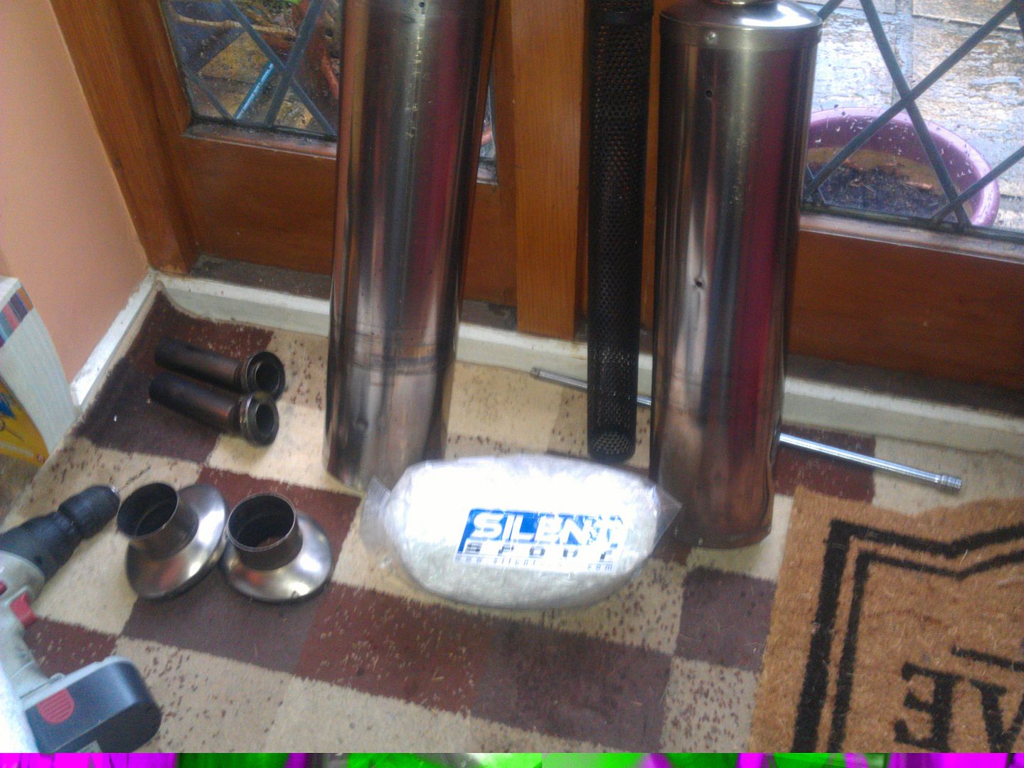

Ordered some shiney new c/f engine covers. Browsed eBay so more, will an after market digital dash be heading my way? Maybe in the future :lol: also ordered some new link pipes saturday evening and some exhaust packing.

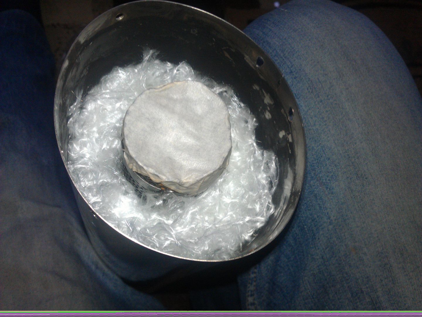

Finally got around to re-packing my cans. Run out of packing though and there's not quite enough packed in :( so need to order some more. Git them back together with a few rivets to hold it all together and then went for a ride. The tone is so much more deeper :D sounds good, can't wait to get more packing in them.
I hope you gave the cans a good clean at the same time :thumbup:
not to mention some fresh laquer on the akra exhaust brackets?
Carl iuse this 1 meter x 1 meter
http://bit.ly/1deFgaX sorry for the short link .
There's enough to do both cans .

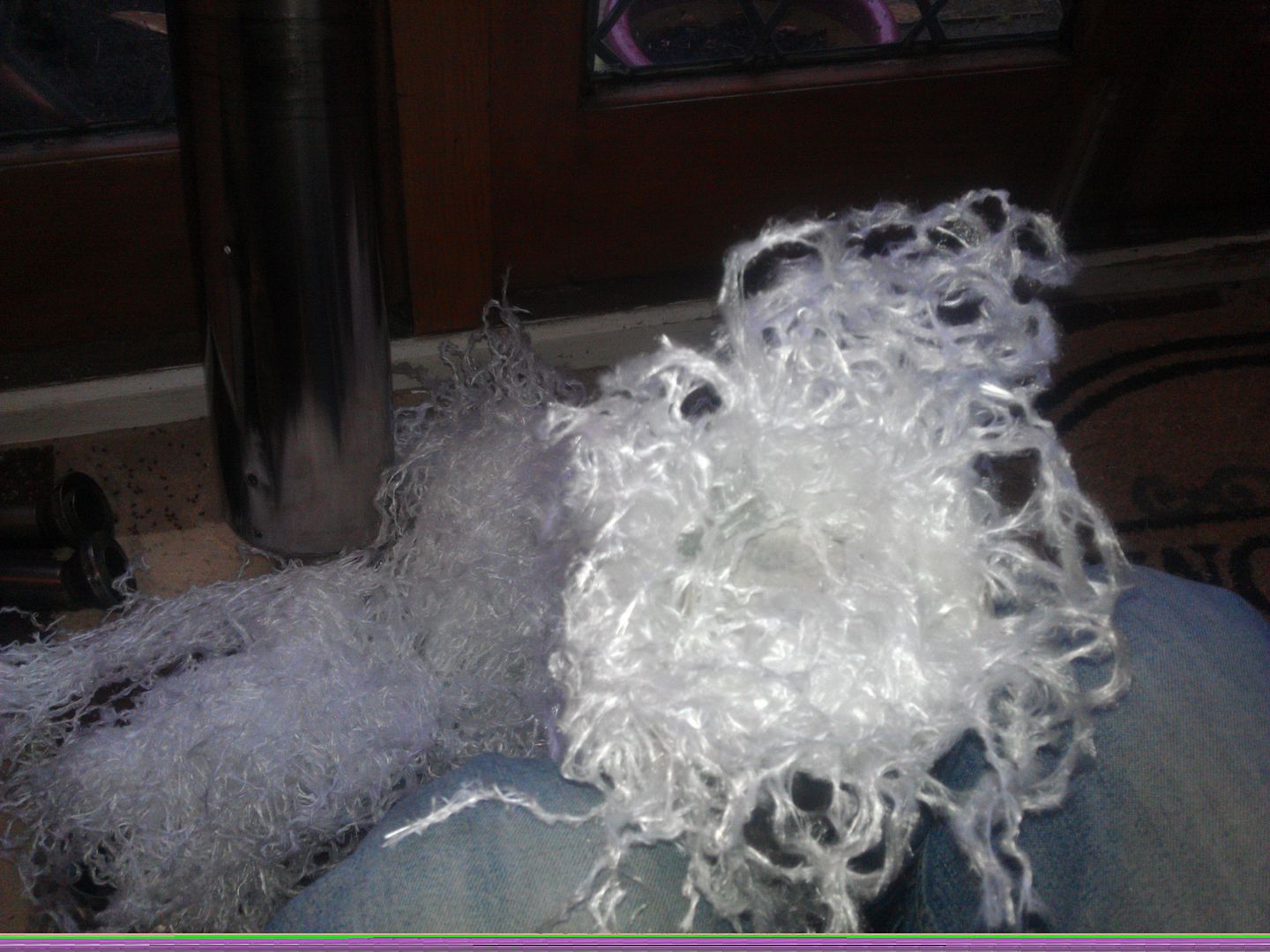

I used the following http://www.silentsport.de/premium.php#p decide to use loose fill though as apparently it's supposed to be better as it gets into all the areas. It's also lot easier to pack.
Here's the link I found that made me decide on loose fill.
http://areapnolimits.com/products/Muffler-Packing.php

heres what happens when I have a spare hour and I'm not supervised :wink:
