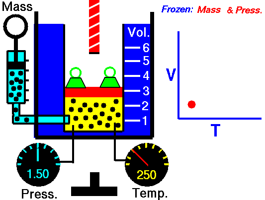

Re: Airbox backfire.
But why is the piston lifting green handbags?cybercarl wrote:
Is this the latest Kermit accessory?
