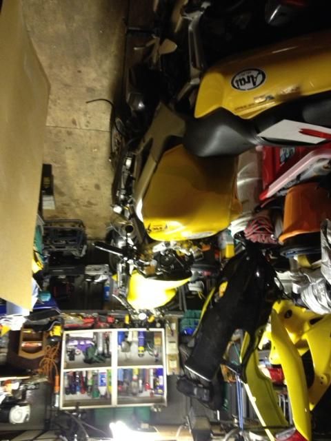

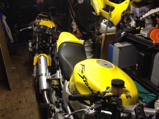

My workshop is a bit crowded at the moment as I have both storms in there and tucked away is a CG125 in bits that me and my lad were supposed to be restoring before this happened.

Proper man cave, nowt wrong with that. Keep up the good work & hoarding...it'll come in useful one day you mark my words... :lol: :lol:
