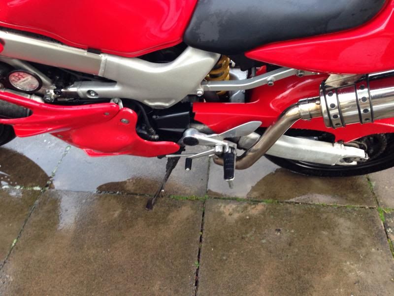

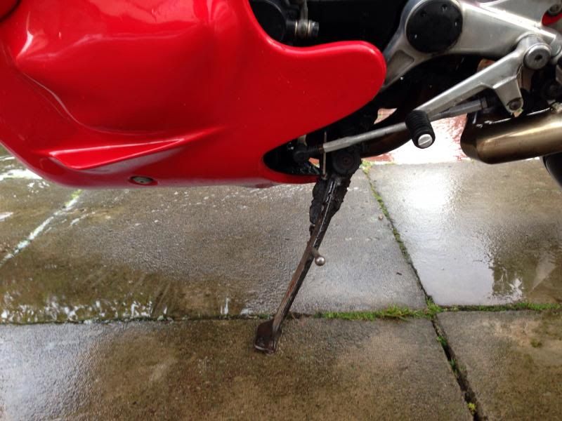

Thanks all, these are the best pics I can get. Not really showing much of a curve, it just seems to sit too far forward to me.
Posts: 16286
Re: Sidestand
That's not too far over, just try pulling it over towards the LH side and see how hard it is.
The wind won't blow it over.
Re: Sidestand
Looks like there's a slight bend, just above the toe prong.
Like Tony says, doesn't look like it'll fall over any time soon.
Posts: 22389
Re: Sidestand
I agree, it doesn't look to be leaning over too far, but (as Jamoi says) the side stand does look in the 2nd pic to be slightly bent. Also the foot of the stand in the same pic doesn't look like it's sitting flat on the ground which would suggest it is bent. Mind you that might be due to the paving slabs not being entirely flat. I suggest you try it again on a flat piece of tarmac or concrete, see what the lean angle is like then, and see if the stand foot sits flat on the ground.

Thanks all, the foot of the stand does lift slightly at the front so I guess it is slightly bent. The bike seems fairly solid for now but I'll try and find one and get it swapped soon.
