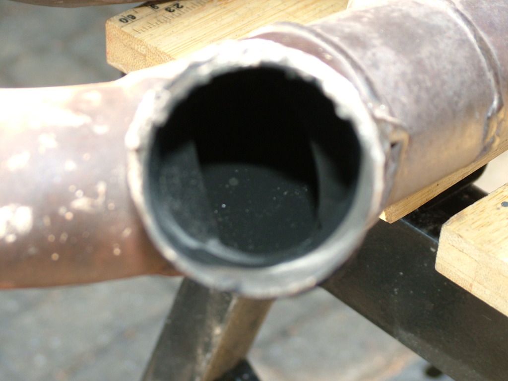

Actually the restrictor is always restricting. Its not a flap that opens and closes as the above might have been taken.
The different temps are caused by it though. Left side is more free flowing so gasses exit somewhat faster.

Re: Cold exhaust gases on one side
That's what I meant but you explain it so much better than me.
Here you go....
Here you go....
