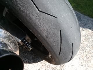

The bike behaved very well to, I say on the linear springs it's more stable and less prone to the very slight weave it had at Easter, but it's still tearing the rear tyre up see below
so I probably need to have a look at the rear spring / damper, won't have time to do anything with it before Wales it's a 'winter job' I think, although I think a new rear tyre is on the cards in the near future, I'll be going back to the OE 180-55 rather then the current (pictured) 180-60, for me the 60 profile offers more cons than pros, the larger diameter alters the ride height, it was very interesting with the 6mm spacer in and 10mm fork drop

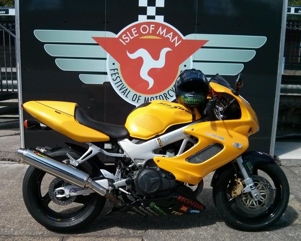

Here’s pic of the old girl in the pit lane, she doesn’t look to bad considering she’ over 17yrs old.
