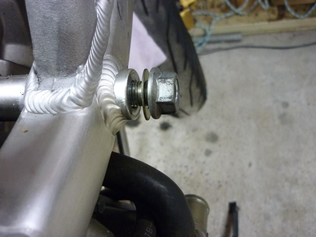

Well I decided to see if the front engine mounting bolt was seized or not. So I removed the RH nut and washer (see pic below). There was quite a bit of thread extending out beyond the frame to which I attached two nuts and locked them together. With this done I was able to rotate the bolt about a 1/16th of a revolution back and forth. Admittedly not much but enough to see it was not seized.

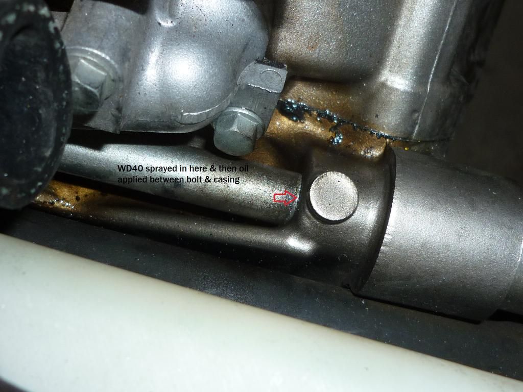

I then sprayed WD40 around where the long bolt goes through the crankcase lugs at the rear of the front cylinder (see below) then I applied oil as best I could to work its way in there. I know grease would have been better, but no way of getting it in there and I did not want to remove the long bolt and grease it as I may have upset the torque settings on the other side of the frame.
When re-torquing the nut and washer on the RH side it seemed to take a lot of effort and I was beginning to think it was going to strip or something. The torque setting for the nut was 47 lb ft so I backed the wrench off to 40 lb ft and I was already at that figure, so I tighten it a bit more and I was there.
Now all good. I know it's not seized and lubricated it as best I could.
