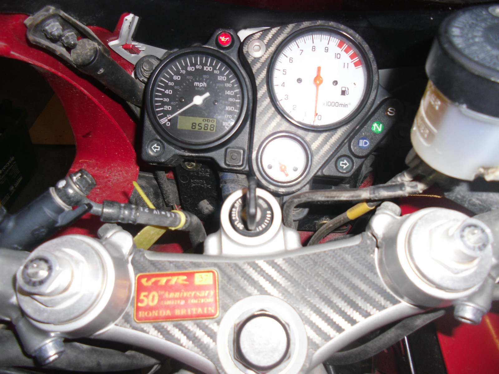

Is the speedo in kmh?
Re: How do i know if my bike is a parallel import?
Slightly odd this one in that the dial goes up to 280 but it says MPH on the face of the clock.
Coincidentally the supplying dealer us very local to me and always did parallels ad I bought my 98 blade there. I seem to remember there was a method of electronically doing some to the speedo so the needle actually reads as mph on a kph clock face

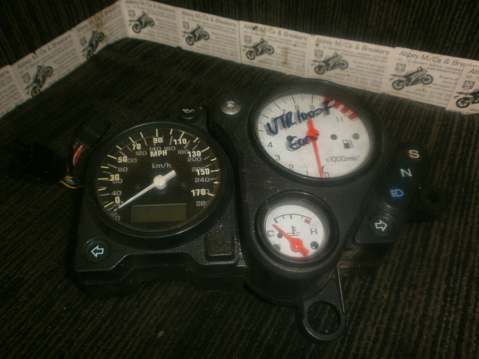

Have you a photo of your speedo? There have been odd cases of lcd apparently suddenly showing kmh (after electrical problems?) but there's no known way to reprogramme it back. If kmh scale was to show mph was used using a speedo healer then the total miles / trip meter display would be false.
mph speedo
kmh speedo with overlay
mph speedo

I'll do a picture - not sure I can upload???
A pic will better illustrate what I am on about !!!!
Very pleased with it though - it was cheap as a previous cat c but it us in very good nick.
I'm suspecting this speedo was a dealer fix on delivery

Hopefully you cansee this???
<a href="http://tinypic.com?ref=2eg8qxd" target="_blank"><img src="http://i57.tinypic.com/2eg8qxd.jpg" border="0" alt="Image and video hosting by TinyPic"></a>
or
New to this technique !!!!!

The mph marking looks like a sticker applied the the face of the speedo, and as the sppedo goes to 280 I guess its a kph speedo with some sort of conversion/speedo healer type thing. Might be replacement clocks though so not really a way to tell if your bike is an import. A Honda dealer would probably be able to tell from your chassis number/VIN or perhaps a call to Honda may clear it up?

Yup agree with Kurt - the 'mph' is obviously a sticker covering the original 'kmh'. Was it sold by the 'dealer' to you as a UK bike? Name and shame em...
You could take out the speedo face and put this in > http://www.ebay.co.uk/itm/Honda-VTR-100 ... 20ee63f285
Chassis number/VIN would tell you the Japanese factory it was manufacturered and the year, though if you check with Honda UK in Bracknell they might still have a record if it was officially imported into the UK.

It was a private sale - and having done more research on mot s there are a few mentions down the years of headlamp masks etc so I am assuming it is a right dipper - as I said earlier the original dealer was well known for parallels .
Guess I'll have a look for a left dipping headlamp unit and think about the speedo - as mentioned it may have some kind of speedo healer.
