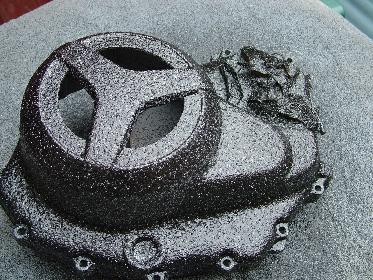

Use a suitably sized coin to mask the glass...
Not sure what Carl used when he did his >
From the classic thread > http://www.vtr1000.org/phpBB3/viewtopic ... 45#p249876

Wicky wrote:Use a suitably sized coin to mask the glass...
Not sure what Carl used when he did his >...lots and lots of heavy drugs! its the only explanation!!

LMFAO>>> iv just read that link :Shock1: :Shock1: :Shock1: :Shock1: funniest thing iv read in years :clap:
Posts: 16274
Re: Oil level sight glass
fabiostar wrote:LMFAO>>> iv just read that link :Shock1: :Shock1: :Shock1: :Shock1: funniest thing iv read in years :clap:
Amazing what a fertile imagination can get up to with an old half-can of underseal found in a drawer in the back of his grandad's garage....but as far as I know he never did get the lit-up innards from an old Battling Top to fit properly on the clutch basket.
