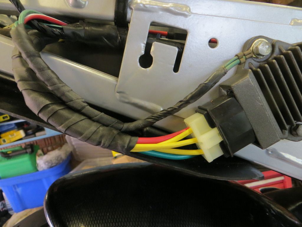

Following on from my previous post here is a picture of the modded reg/rect wiring
And thanks wicky for those links

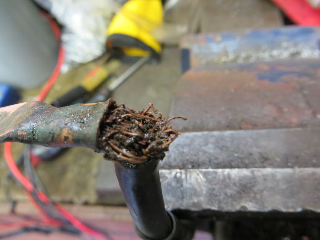

I did actually try another shorter starter cable I had in stock(probably from a blade) and perfect!!!!
So I took the original cable off and on closer inspection here is what I found!!!!! Im suspecting it just could not carry enough current.
