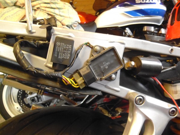

dave... if the battery is getting hot it's the R/R without a doubt... Take off the seat plastics to reveal the R/R pull the block conector out & visualy check for signs of burning to the block or the wires...prob be both.
If the R/R is the origonal it will be a small black block about 3'' x 2'' ...take it off & throw it in the nearest bin !
They are called rectum friers for a reason. :lol: :lol:
Later bikes came with a finned R/R to help cooling but they can still fail.
What you need to do is fit a more modern Mossfet type R/R & hope the failing one you have hasn't burnt the loom too much.
Old finned type v's Mosfett, this is on my F2 so looks a bit diferent to an early Storm.
Mosfet as fitted to an early Storm...
