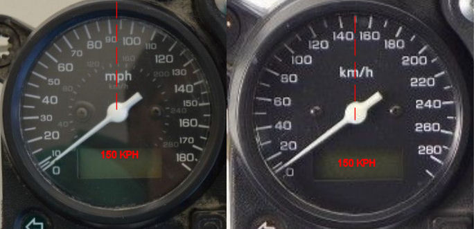

BrianC wrote: Mon Dec 31, 2018 1:41 pm Im just wondering if the speed sensor is different
I dont have a non US one to test, so take this for what it is an Educated WAG.
By part number they are the same sensor UK , Japanese and US. But I have limited non US parts resources so I could be wrong.
and the two faces KPH only and US/KPH seem to line up for KPH tick marks

Mine looks like the one on the right but it says mph
Im struggling to get images uploaded here
Re: Speedo on a parallel
Yup Km/h speedo from a Euro bike - with a sticker on the face with mph - was there a clear vinyl mph vinyl overlay on the 'glass' face?
Presumably the odometer is showing Kms - Replace with the spare clock cluster or I've got a proper mph face

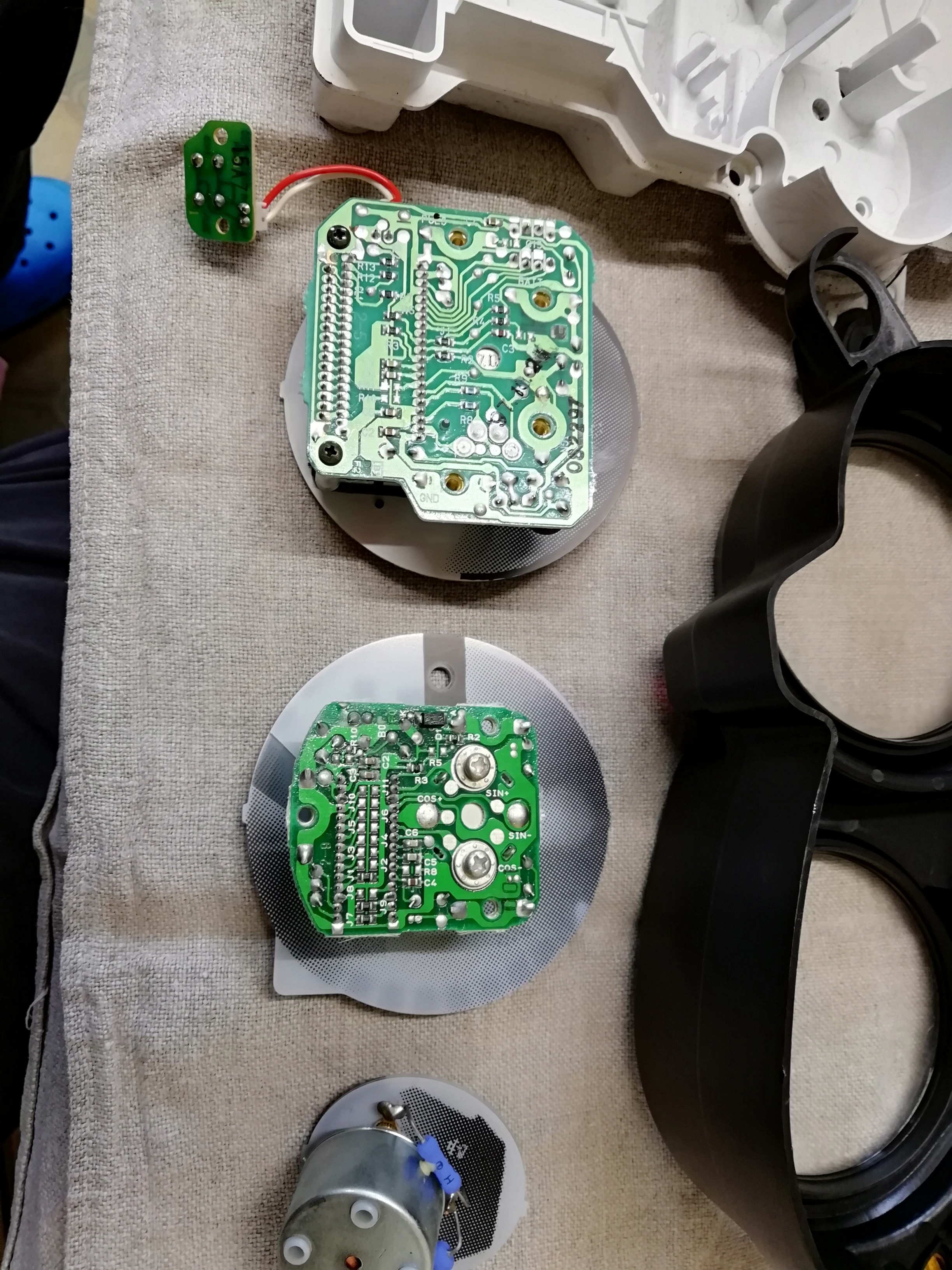

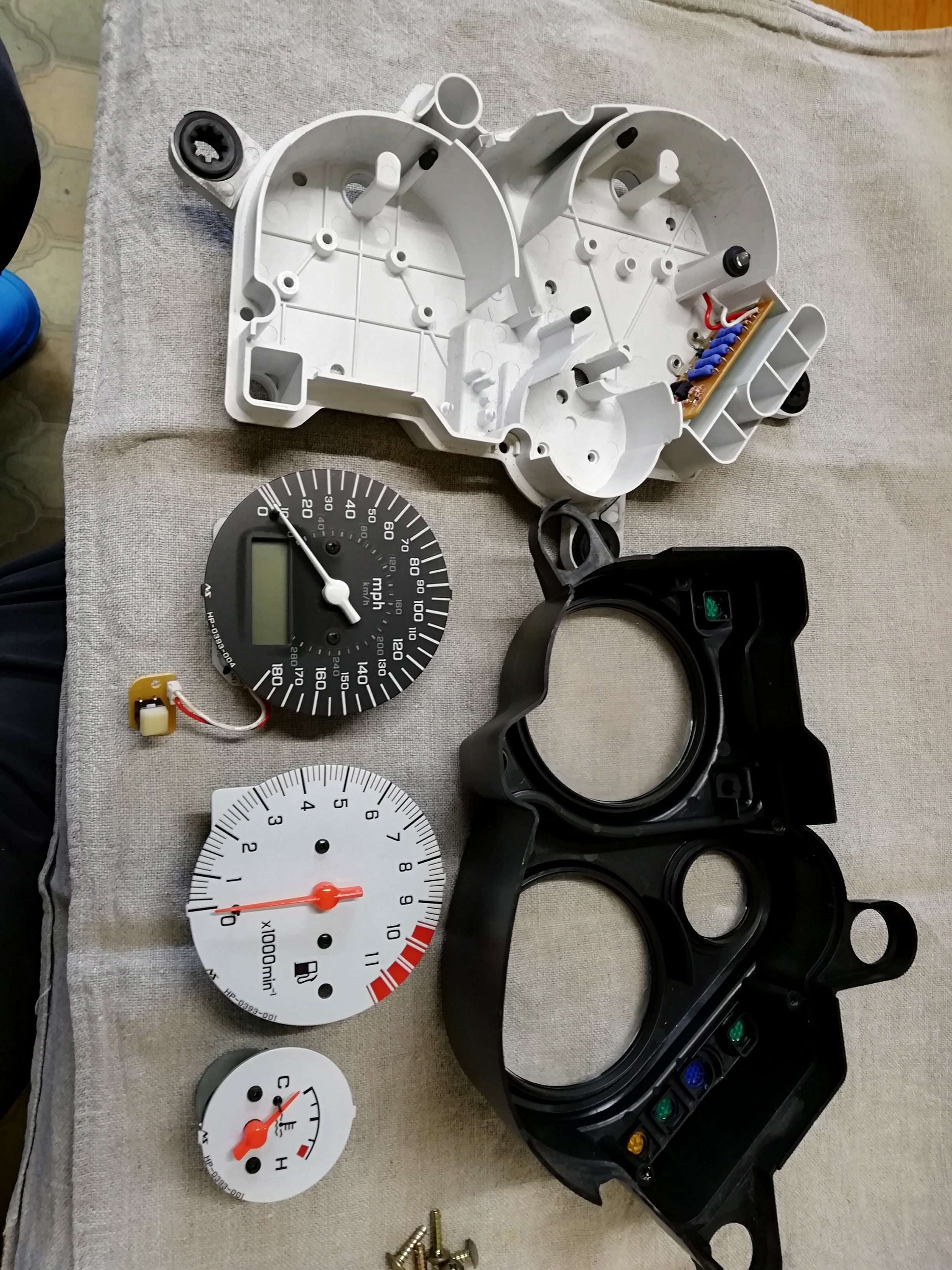

I've just bought one in a job lot. I don't really need it. Make me an offer? The dash has obviously been disassembled and then just stuck back together. The clocks are loose in the dash. If you are interested I'll take it apart and see what gives.
KermitLeFrog
Posts: 1662
Location: Hexham
Post by KermitLeFrog »
See here:
