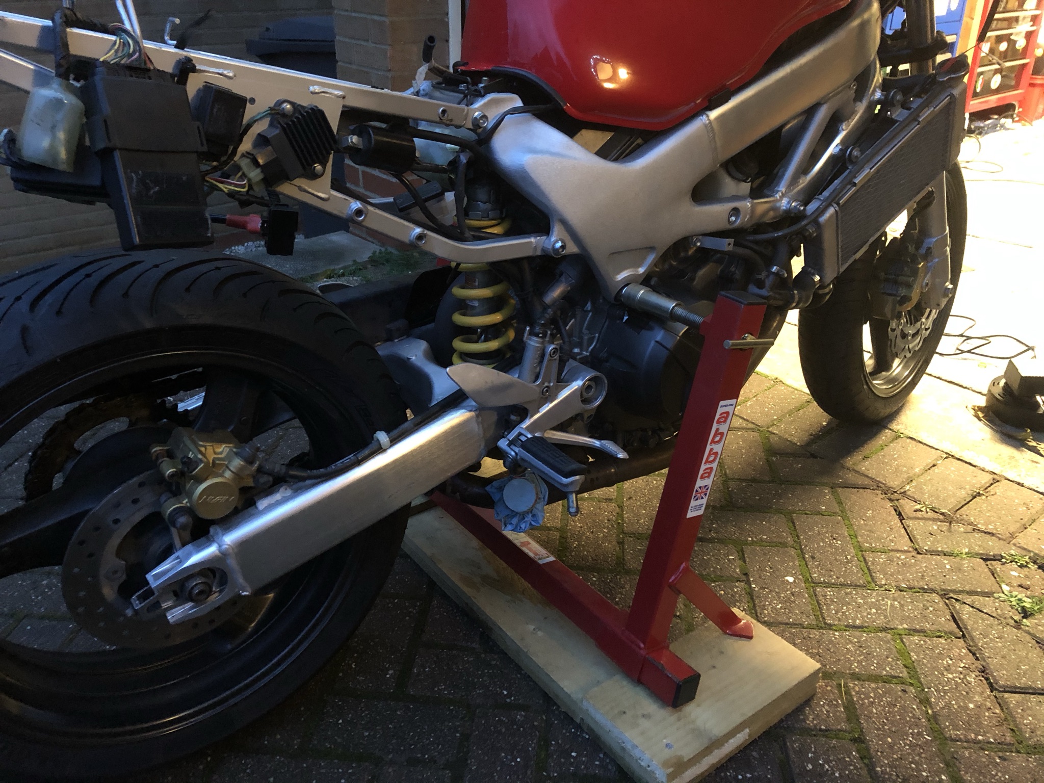

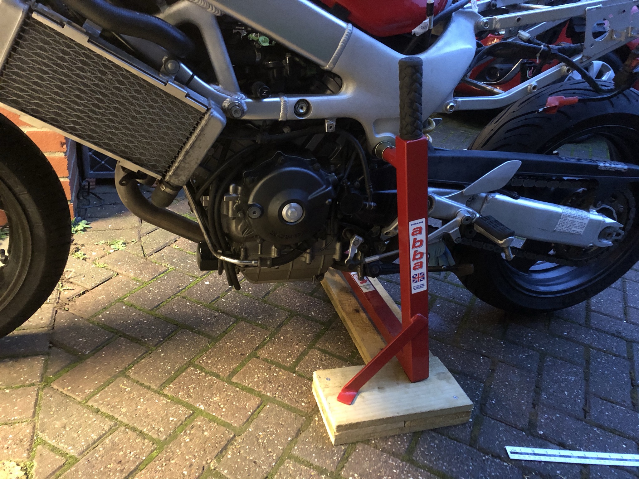

Re: Question on swing arm removal
Sorted thanks for the advice, 17 mm socket on the right, works a treat
