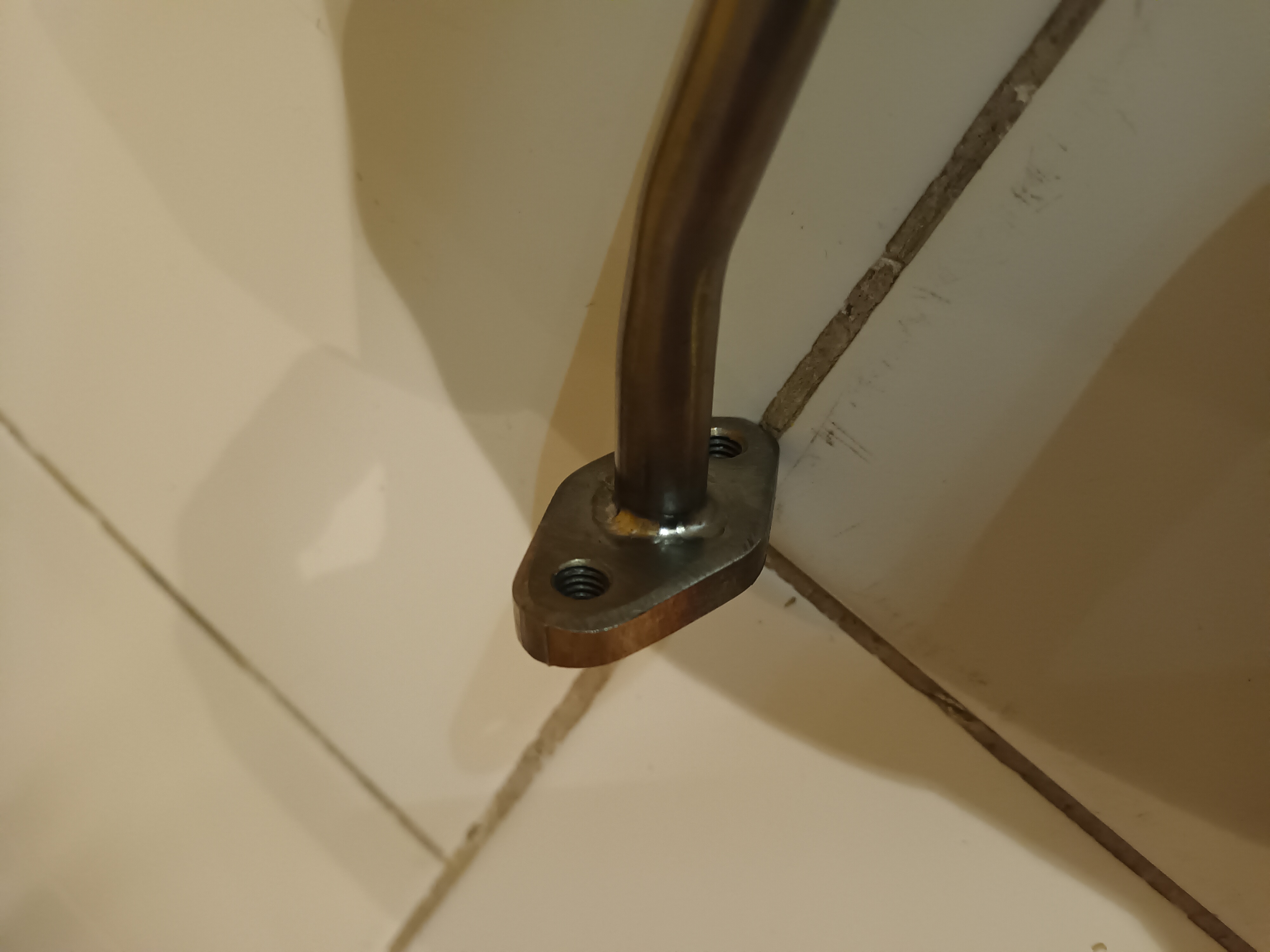

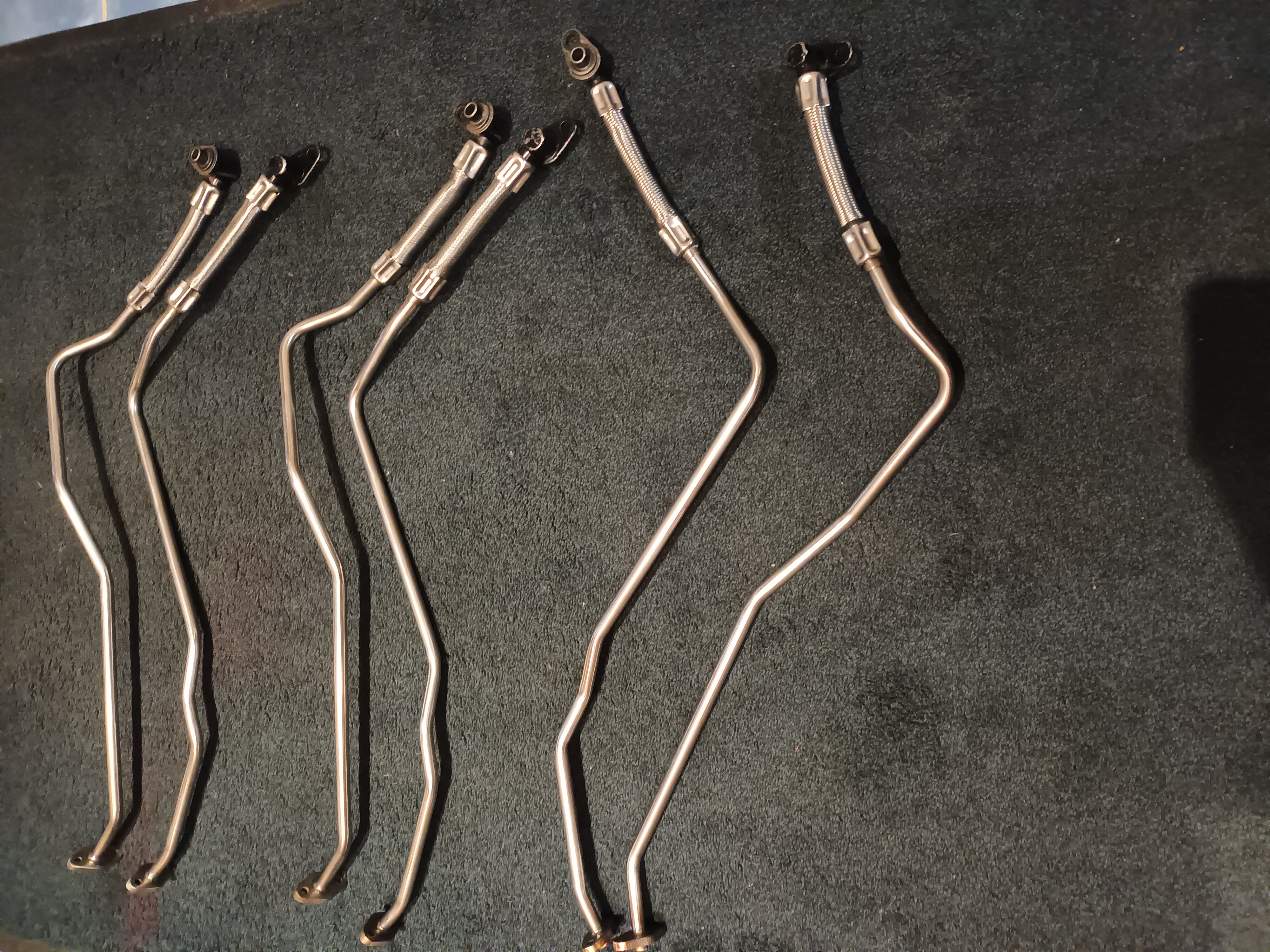

These pipes I made some months ago, showing laser cut flanges welded to the tubes, the other end shows oil resistant flexible rubber tube held with stainless clips, I've since purchased a crimping machine with stainless crimps, these are much better, although the clips worked perfectly well.
The second photo shows crimped pipes compared to the old ones, ready for the engine sump fittings.

Material sizes used to make the Pipes is identical that used by Honda.
Only difference is Stainless steel as opposed to chrome plated carbon steel that Honda continue to use.

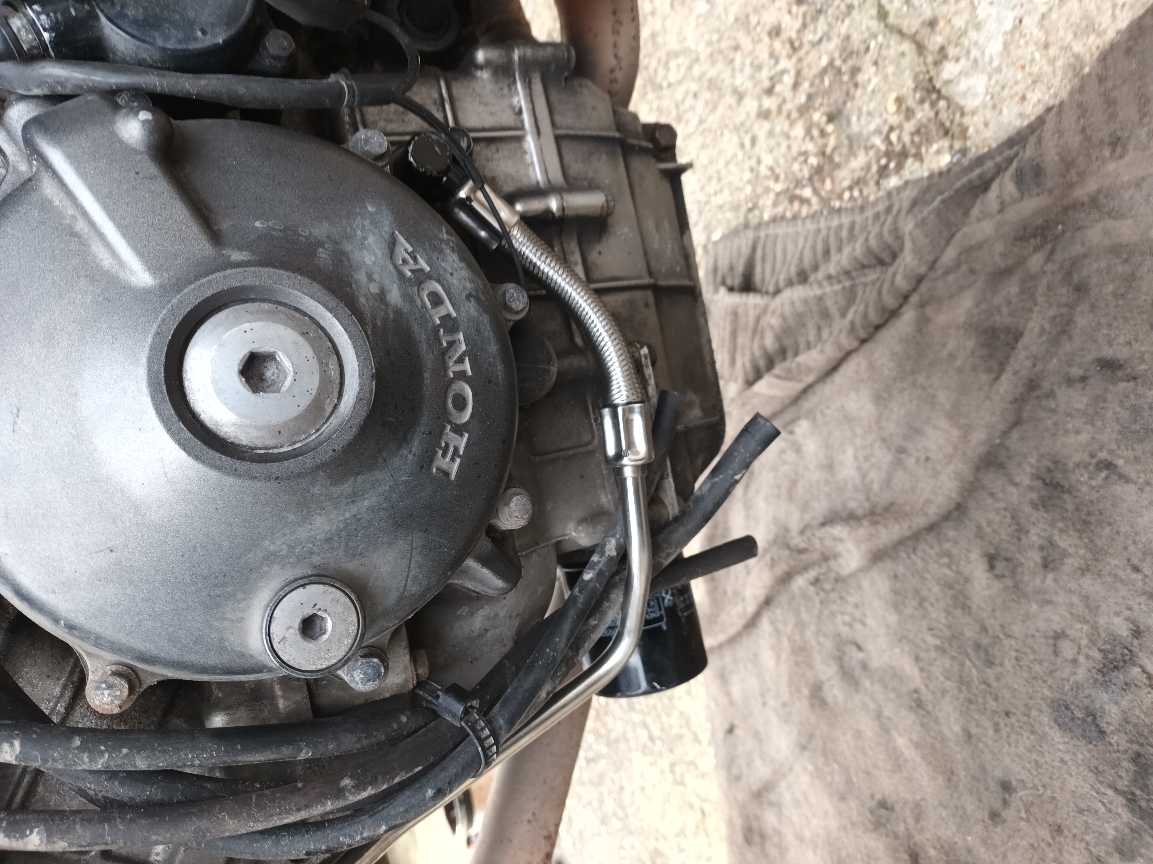

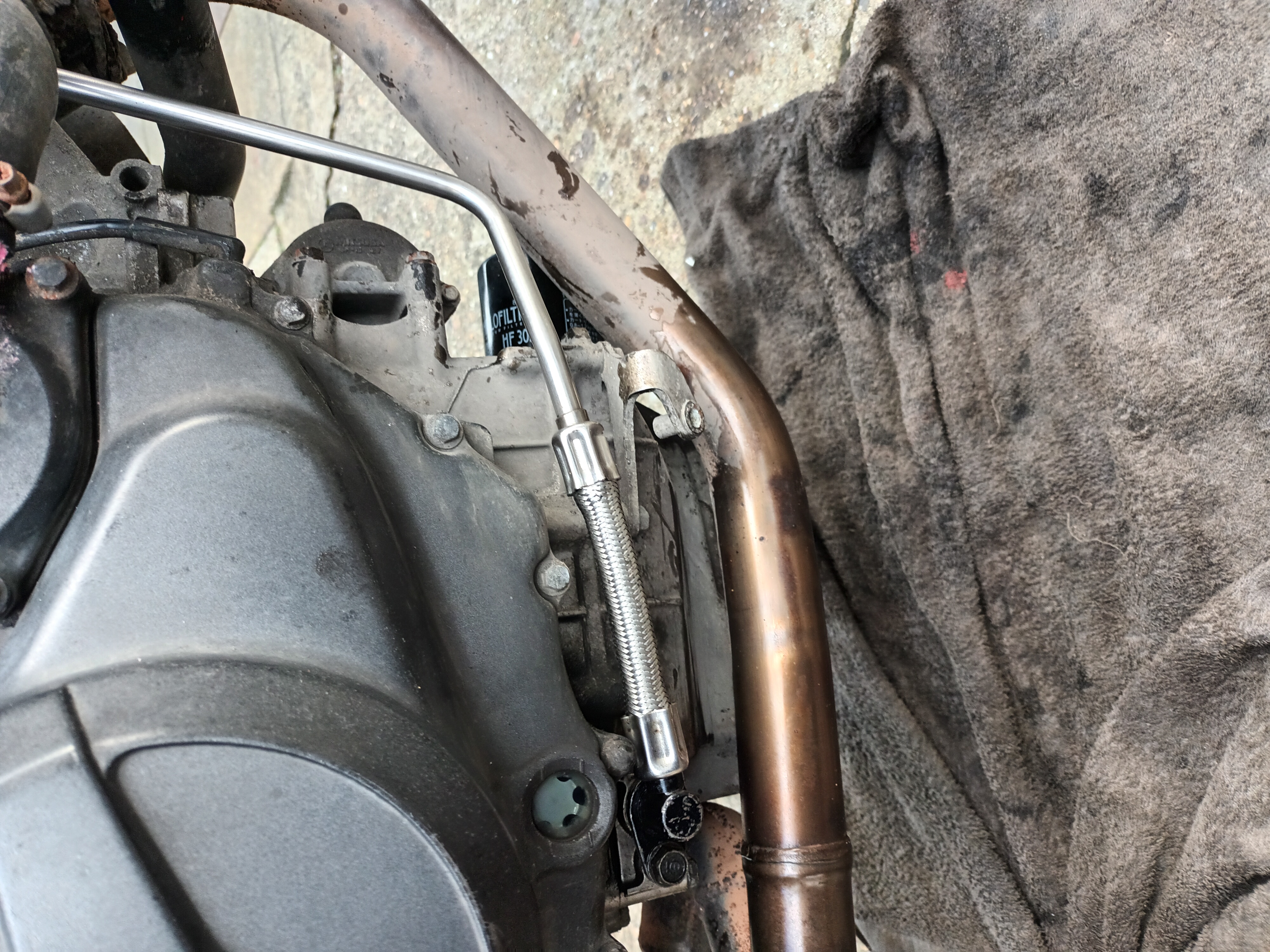

Did the deal with Ed, sent him a full set & 3 chopped sets for the fixings.
Got these yesterday, waiting for me when I got home from work... Short day let out early so home by 11o/c...
Nice dry day today so fitted a set to The Murvinator...
Perfect fit, very nicely made, very happy.
