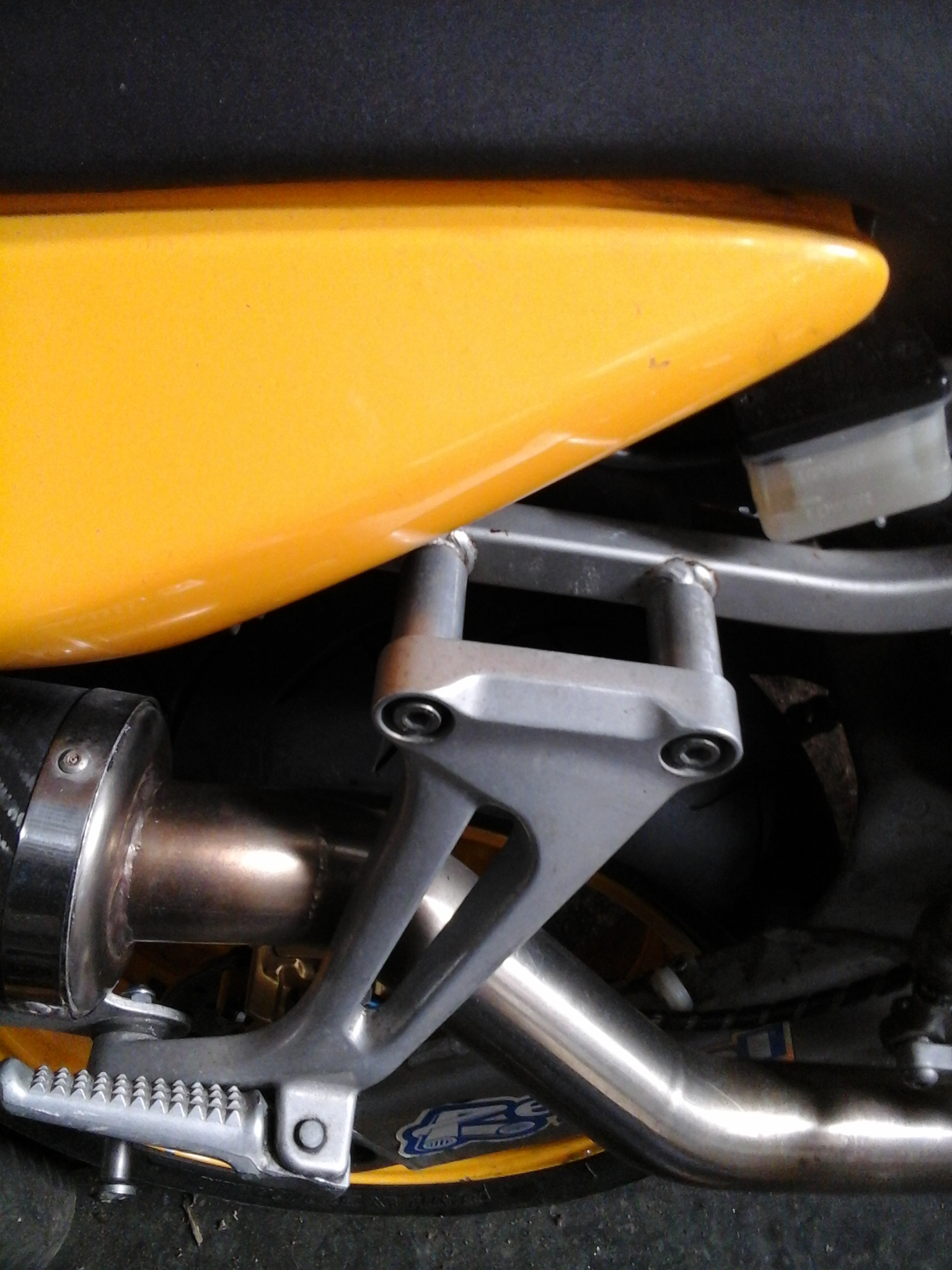

Nigel, from memory you will need some spacers and long bolts if you want to put the rear foot pegs back on. i have some

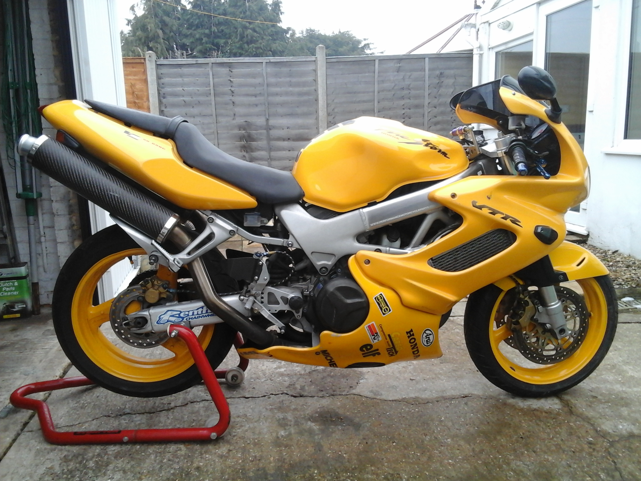

One of my Storms came with carbon Migs fitted...
As you can see it has the rear pegs fitted...the cans mount via the hangers...

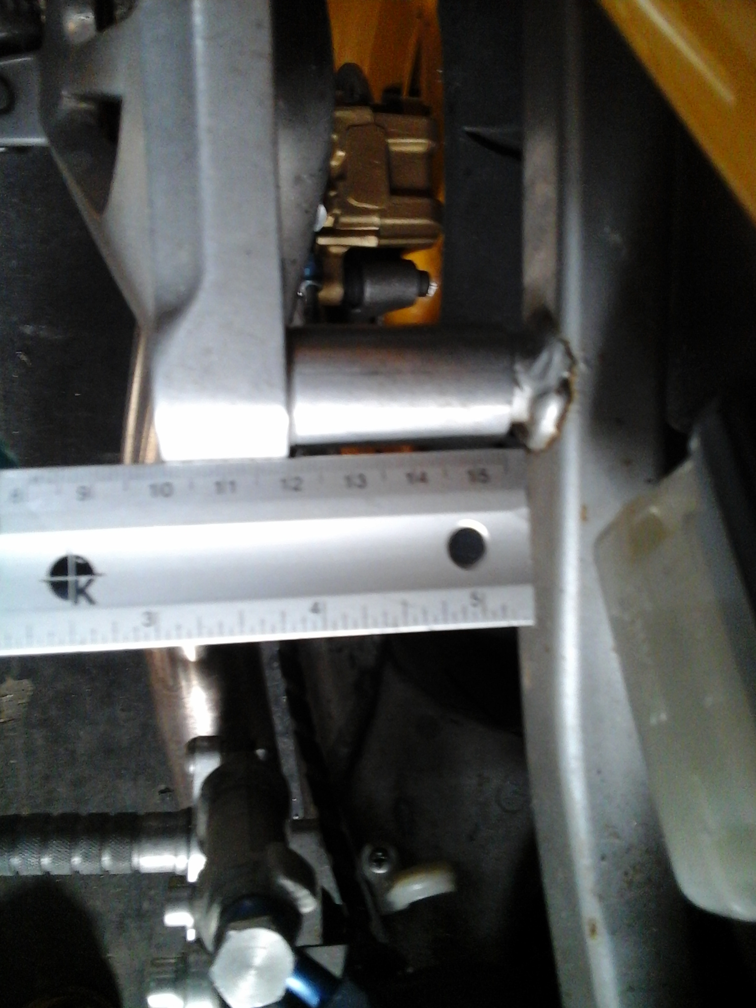

Longer bolts & some ally tube to make the spacers...
Tony Mons had Carbon Migs on his Storm... They are loud, very loud. The Carbon is very thick & good quality
