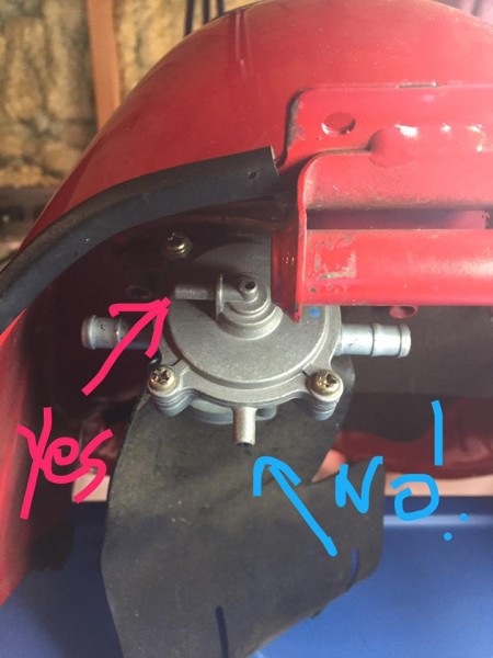

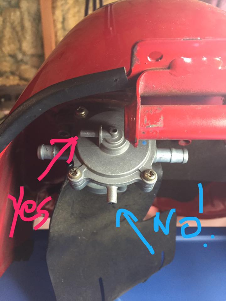

Re tank removal... It's always best to do this with as little fule in the tank as poss but if you have recently filled it up & have no way of draining it never mind just remember it will be heavy when lifting it.
Two 8mm bolts at the front of the tank. There should be a top hat spacer in the rubbers that go in from the bottom.
You need the saddle to be off, then at the rear of the tank is a bolt holding the rear of the tank to a bracket, 10mm head on the bolt & 10mm nut.
So take out the bolts at the front, take the nut off the rear tank bolt but leave the bolt in for now.
In the bunch of conectors at the rear of the tank just behind the frame rail In front of the battery, on the right hand sied of the tank you should be able to see a wire coming from under the tank & going into the wire bundle, trace the wire & find the conector & disconect it... This is your fule level sensor so make sure you reconect it at the end of the job or you wont get the fule light warning on your dash !
Lift the tank from the front & prop the tank up. I use a bit of timber cut to length or you can use bungee cords or simular If you have something to attach to.
Now at this point get your phone out & take some pics of the pipe work...
See here... viewtopic.php?f=31&t=42689
Now I'm assuming you have an early Storm as it will be different on the later ones with the bigger tank... so bear with me...
I'll refer to 16ltr & 19lt as I dont know which you have...
16ltr. just pull off the two breather pipes... You dont really need to turn the tap off but if you do use something to remind you to turn it back on or you'll be posting up that your bike wont start...
Personaly I don't bother with turning the tap off.
Now use some pliers or just your fingers to squeeze the clips on the fule lines & remove each one, some fule will come out but dont worry it wont be much. On the back of the petcock is the vac pipe...It's hugly important that when reconecting this goes to the correct spigot ! Or again you bike will not run...It'll start with the fule in the carbs but once thats gone it'll stop & you wont restart it...
Now once all the pipes are out of the way & the sensor wire disconected, lower the tank back down, remove the tank bolt from the rear ( if it's tight push it through with a long allen key or somesuch & when you put it back in grease the feker up !) ...
Now lift the tank clear of the bike & place it caerfully on the ground somewhere away from where you are working On a towel or the grass just away from anywhere you will be walking or possibly dropping or throwing tools !
19ltr Basically as above but the fule petcock is a remote item & is mounted on the frame so you only have to pull the two breather pipes & the sensor wire... There is only one fule pipe from the tank to the petcock & this needs to be clamped before you remove it from the petcock...
Have fun.
