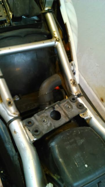

had a look at the airbox today and theres some strange snorkel extension been added?
I have removed the pipe and re-seated the air box onto the carbs as only one inlet was on properly. genuine suzuki standard air filter ordered and a new fuel filter.
I'm hoping that once the filter is in the bike will run properly otherwise the carbs will need checking that they are standard settings.

Thanks for your help on this . It was indeed just a case of putting the standard air filter back in. :!:
Unfortunately for her she had the bike in a 2 different bike shops who cleaned carbs, replaced coil packs etc...
even though its back up to full power if your ever in doubt of how good your storm is go ride a bandit 600 lol
