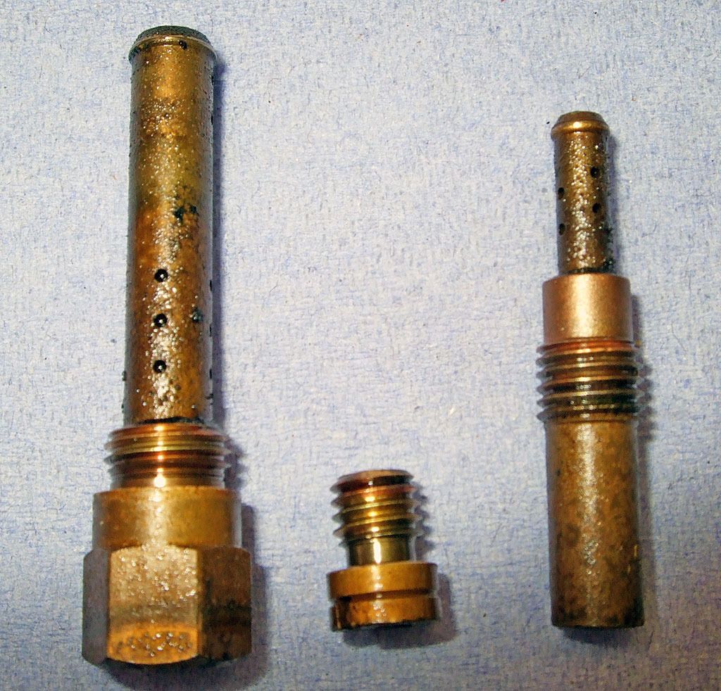

I took a photo right away before starting to clean them:
The pilot jet on the right.
Just to clarify, in case there is some misunderstanding with what I'm asking.
I don't mean the holes in the side of the tube. I mean the hole that runs thru the centre (like looking thru a telescope)
The other two (left two) in this photo have large openings all the way thru them, the pilot jet, on the right has a tiny tiny spec of a hole. I'm not sure is this is right or it's blocked?
Is the thru hole on the pilot jet supposed to be large (when I say large, I mean about 2mm) at either end, then, in the middle it's only a tiny tiny hole?
Re: Pilot Jet Hole - Is it a really small thru hole?
Then you are in good shape.
Also yes I did mean the pilot jet not the emulsion tube when I said there are 3 small holes in there.
If you look down the small hole in the pilot jet, there are 3 smaller holes that actually meter the fuel.
That is why pilots are so hard to get clean. :thumbup:

Really?
Amazing.
Given the larger holes in the brass pilot jet are only around 2mm in dia (bit of a guess) at either end, but there is a little bit of solid in the middle of the brass, to have 3 holes thru that solid bit is pretty amazing, they must only be fractions of a milimeter in dia. will have to take to work and look under magnification to see if I can see these 3 holes you mention as I can only see one when I look down the brass pilot jet.
