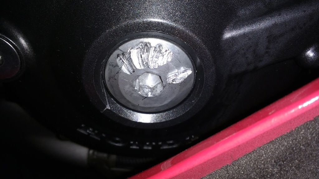

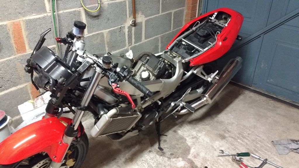

I followed the excellent guide on this forum (thanks VTRDark) and everything went relitivly smoothly once I'd removed the notorious genny cover bolt, this was a proper pain in the Ar$* and I ended up having to use heat and the chisel and lump hammer method:

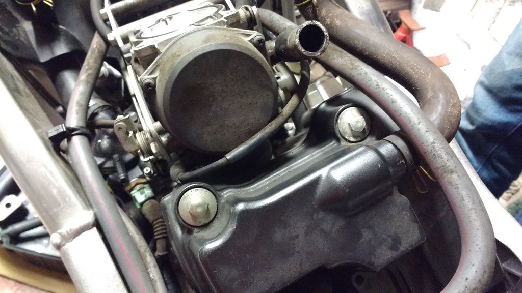

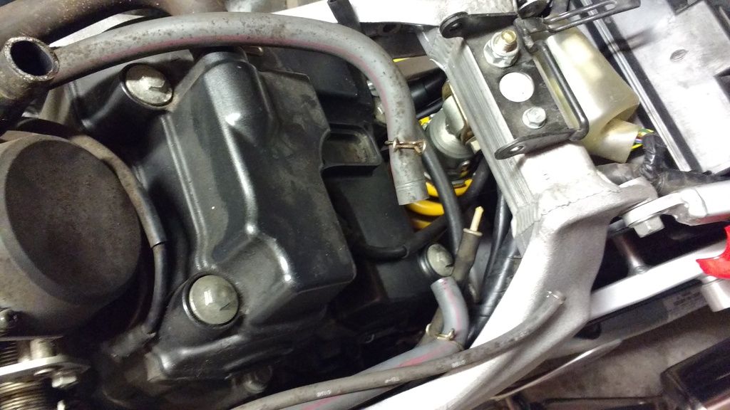

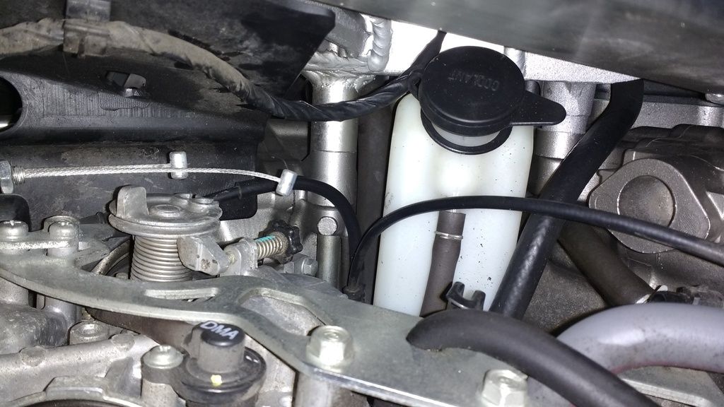

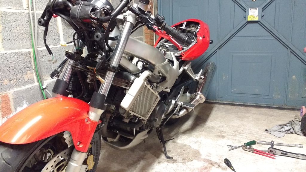

After sorting this I proceded to strip everything down which took a couple of hours (was taking my time). So the first evening I got it down to this point, deciding to leave the actual fitment till the next evening:

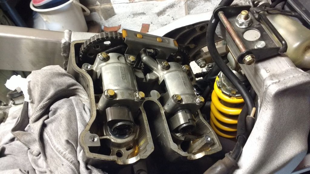

The following evening I took off the covers, checked the timings as per instructions, removed the auto's and fitted the manuals. I adjusted the chain to between 5-7mm as per guide:

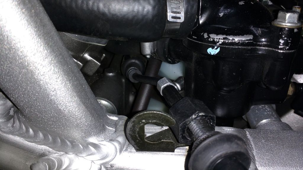

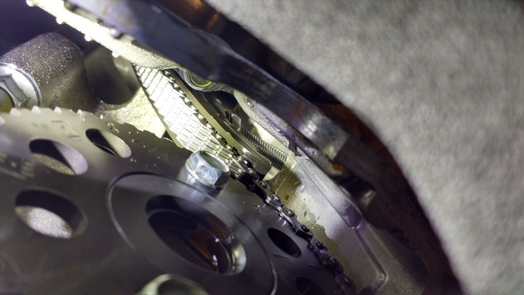

Here's a shot of the manual tensioner bolt pressing up against the chain guide:

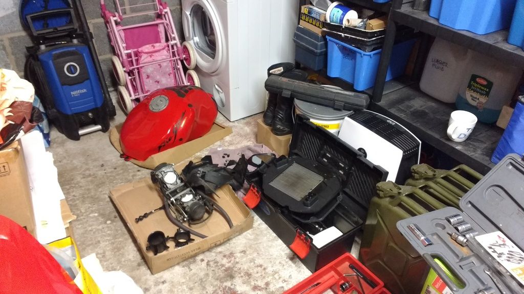

The next evening was spent reassembling everything, so all in all it took 3 evenings and around 6-7 hours in total. I was deliberately taking my time though, and I only had a couple of hours free on each evening. If I had to do this again I reckon I could manage it in around 3 hours.
