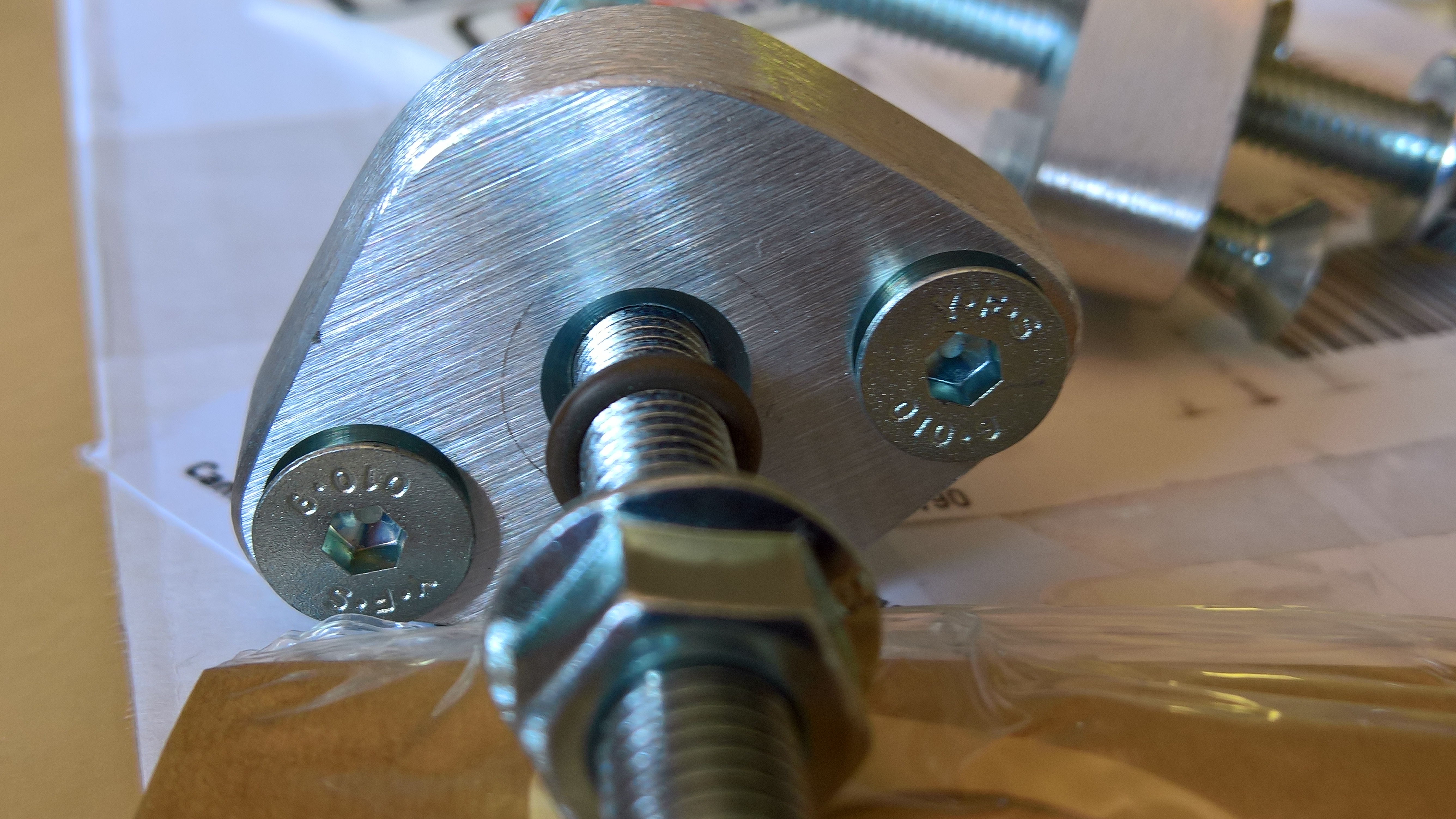

Hi guys,mcct just arrived.
Mine are "O ring" version.I suppose the sealant is no more necessary?
