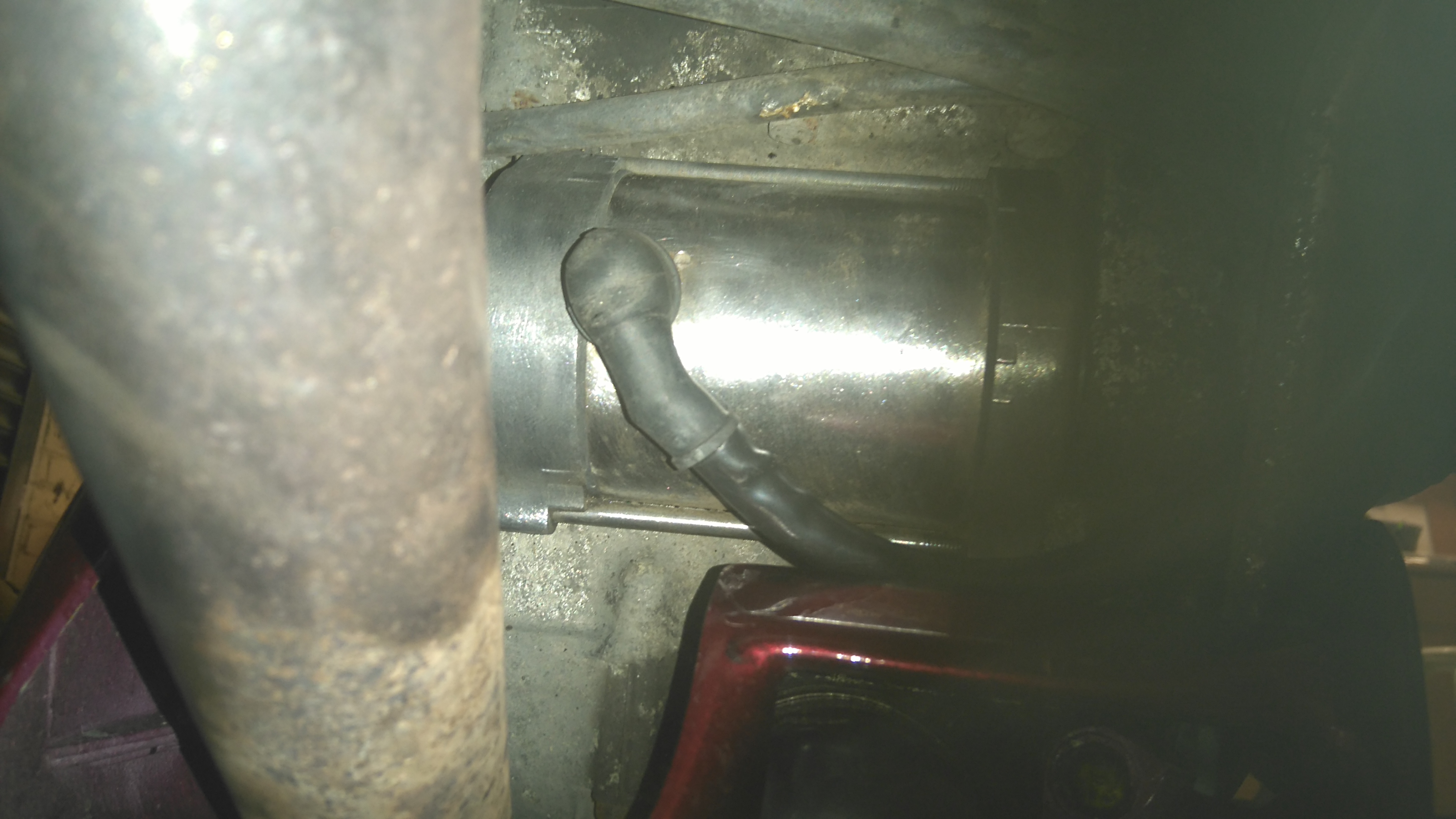

A clicking starter relay is a sign that there's some eclectrickery getting through but not enough to turn the starter motor.
What's the terminal connection like under the rubberhood on the starter motor? Any sign of corrosion on the nut & bolt.
If you short the starter relay does the starter motor turnover okay?
Same battery?
Same battery?

No manual cct's ( they are sitting here, waiting though)
Starter relay doesn't click. It pulls in fine, but the starter motor struggles.
A new one is on the way though.
The starter motor nut looks a bit sh1t, I have a mate sending a good used secondhand unit up.
Battery is a nice 14ah exide unit, I don't trust those lithium ion batteries, never had much luck on another bike.
I've ordered some new cable.
For future reference the stock cable is AV15 cable (crazy Japanese numbering for #6 awg)
Which is about 13.36mm2 so I'll replace that with 16mm2 oxygen free flex cable. And some decent lugs.
Cheers for the ideas guys, much appreciated

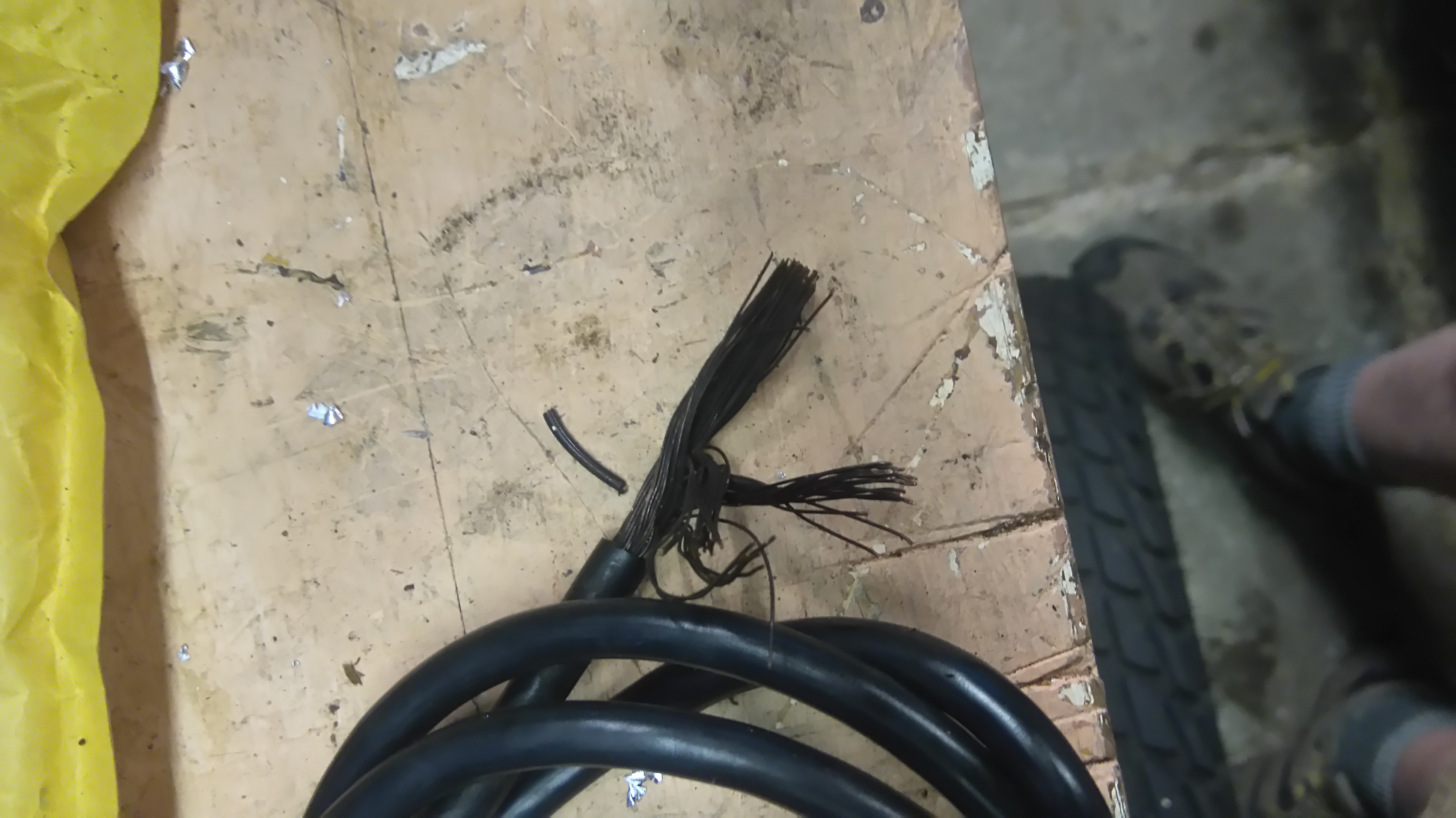

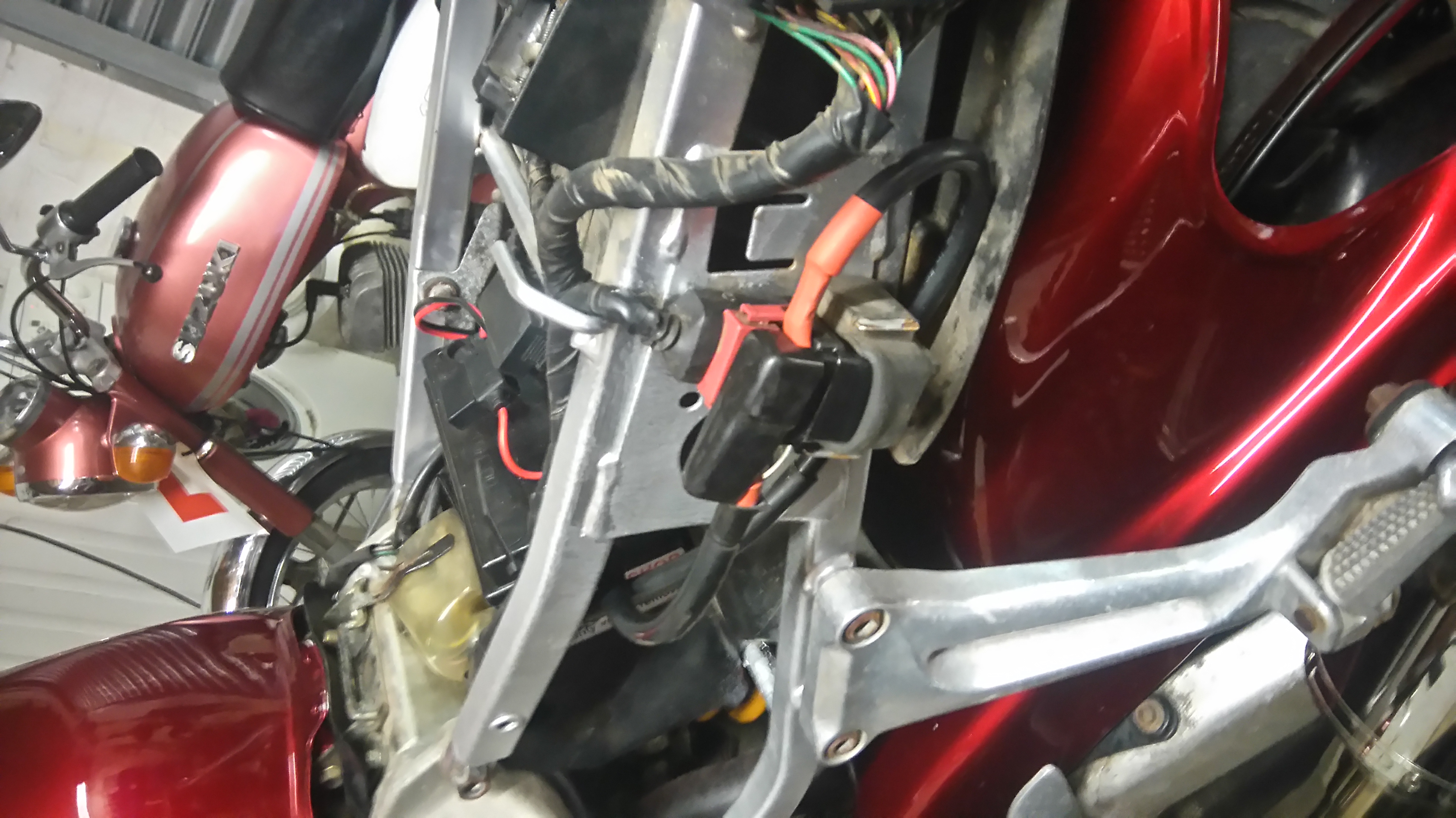

Right update,
I replaced all the starter cables with 16mm2 cable.
With decent hydraulicly crimped lugs, I cut the original cable open, and the copper had turned black. I replaced the starter motor and gave it a quick Polish on the wire wheel
