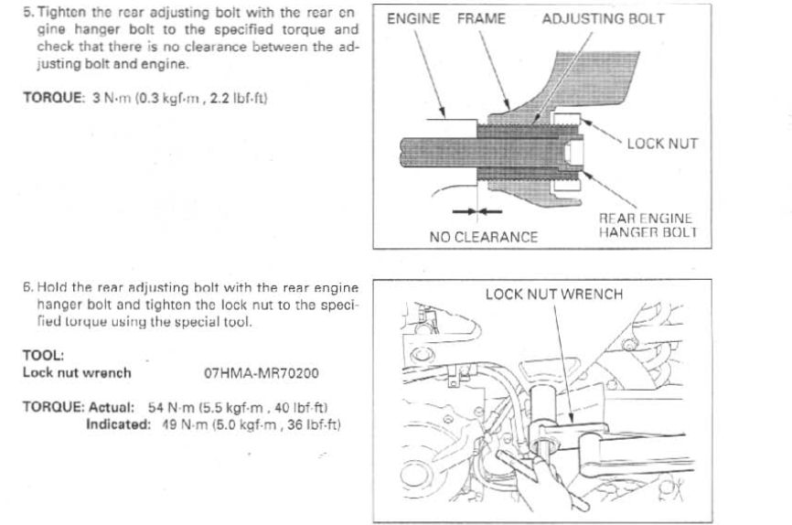

yes only needed for installation to set the correct spacing & tension between engine and frame

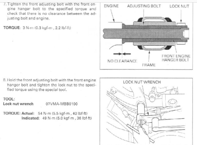

With the castle nut tools I can't see how one would hold the adjuster still while torquing up the lock nut. Is Al's marker trick the only option?
Re: engine mount bolts
The castellated nut IS the lock nut... you hold the bolt though the center of the tool and tighten the lock nut down.freeridenick wrote: ↑Thu Dec 07, 2017 7:48 pm With the castle nut tools I can't see how one would hold the adjuster still while torquing up the lock nut. Is Al's marker trick the only option?

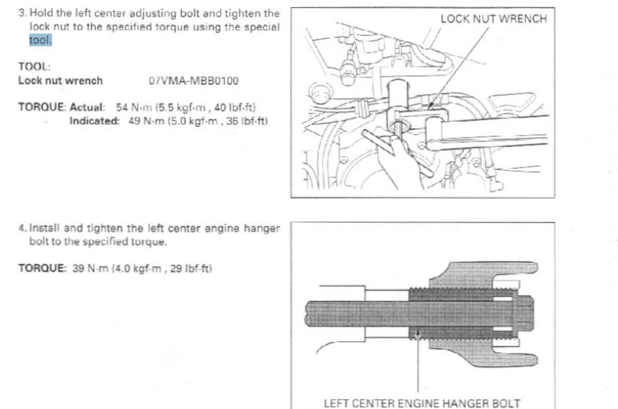

That bit I get but all the non-honda tools I've seen are a standard square drive which means you can't get anything down the middle to hold the bolt.E.Marquez wrote: ↑Fri Dec 08, 2017 7:40 pmThe castellated nut IS the lock nut... you hold the bolt though the center of the tool and tighten the lock nut down. engine mount locknut 1.jpgfreeridenick wrote: ↑Thu Dec 07, 2017 7:48 pm With the castle nut tools I can't see how one would hold the adjuster still while torquing up the lock nut. Is Al's marker trick the only option?

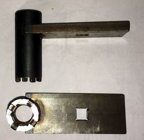

I don't suppose you have any idea what the distance from centre to centre of the two holes isE.Marquez wrote: ↑Sat Dec 09, 2017 3:00 pmAnd thats why you buy the OEM tool or make somefreeridenick wrote: ↑Fri Dec 08, 2017 10:44 pm That bit I get but all the non-honda tools I've seen are a standard square drive which means you can't get anything down the middle to hold the bolt.
No need to guess when you can do it as designed correctly.
Chris I absolutely do
Oh, wait, you wanted me to tell you what it is....
66mm center of the socket to center of the 1/2" square drive
Why 66mm?
Because that is what the factory tool is TOOL:Lock nut wrench O7VMA-MBB0100
So I also use the service manual specs for "indicated" TQ to achieve the specified "actual" TQ
