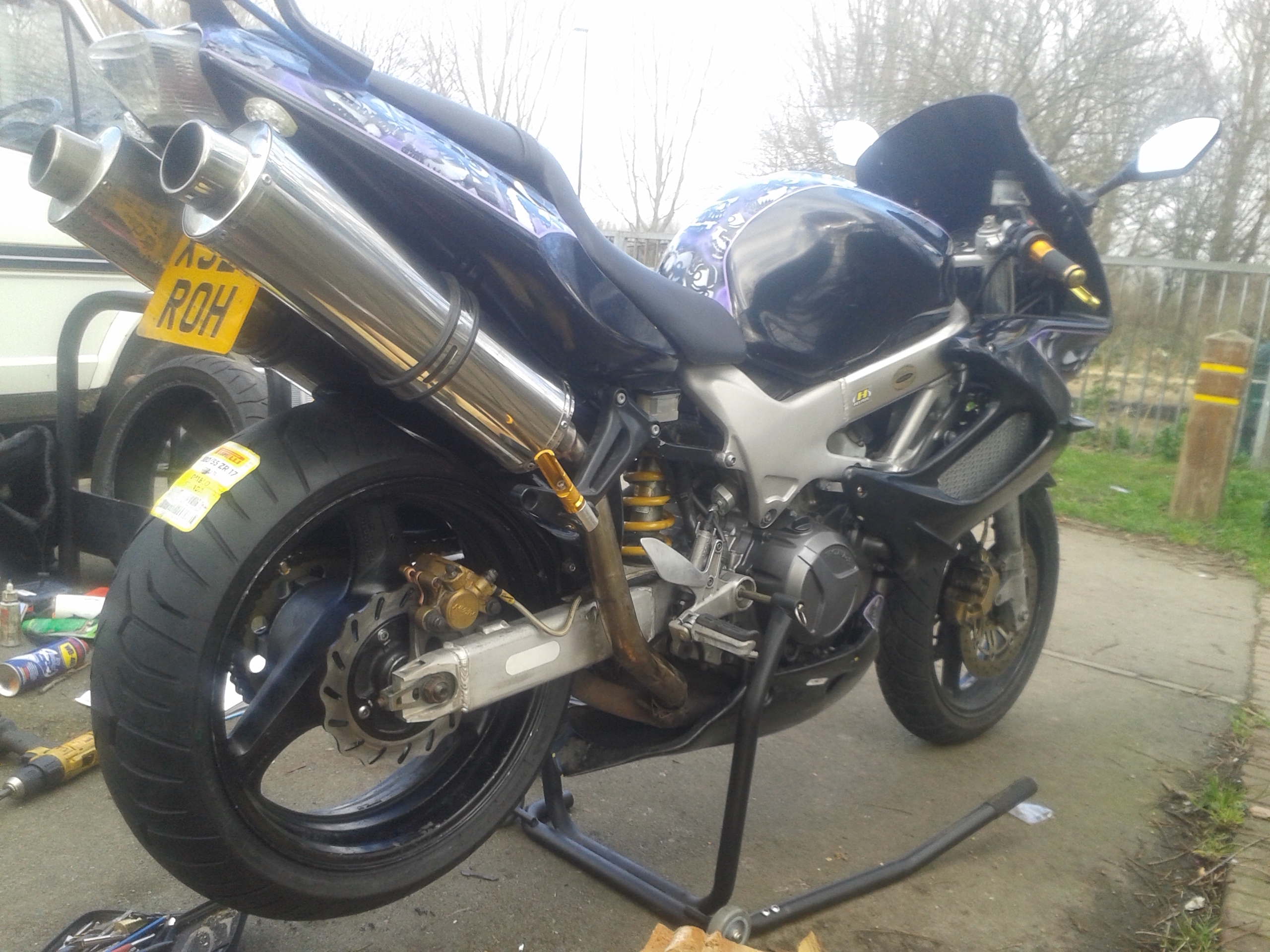

so today I found some time to tinker on my bike
firstly I refitted my rear wheel with a lovely new tyre (is it just me, or does anyone else get excited about new rubber :lol: )
after that I replaced the front subframe mounting bolts and nuts with ti jobbies, I also did the same with the clip on bolts.
last week i'd noticed my rear light was a tad wobblier than normal, so off with the rear fairing to investigate. turns out one of the plastic mounting tabs is giving up the ghost. a smear of super glue will hold it for now. I also added a little extra foam to the little tabs that sit above the light unit on the underside of the fairing, and now its a much more snug fit.... :thumbup:
also my rear light is a clear lense unit. and it has two red plastic domes mounted inside, and the oem bulbs fit inside of them, but over the year vibration has destroyed them, but luckily a few yes ago i'd replaced the oem bulbs with red led bulbs, so it was just a case of removing the rear lense, taking out the damaged red plastic domes, and then refitting the clear lense. job done.
I also had time to address the wiring from my brembo brake master to the kill switch. when a friend help me fit it in the past, we'd used spade connectors, and then black insulating tape, but the wire was longer than it needed to be, so I cut out the connectors, soldered the wires together and neatly covered it all with heat shrink, it looks much better now.
jobs for this weekend includes. fitted 2 sat navs, one on my bike and another on a friends bike. they can be hardwire in. should be fun... :roll:
we've also got matching Bluetooth intercoms, I've never used them before, not sure i'm going to like them, as other than music on very long touring journeys, I wear earplugs, so have someone talking to me is going to be odd, not to mention them listening to my waffle.... :lol: :lol: :lol: :lol: :lol:
so petrol and a tyre pressure check and the bikes good to go, sunday is supposed to be 14 and sunny. lets see what happens.... :wink:

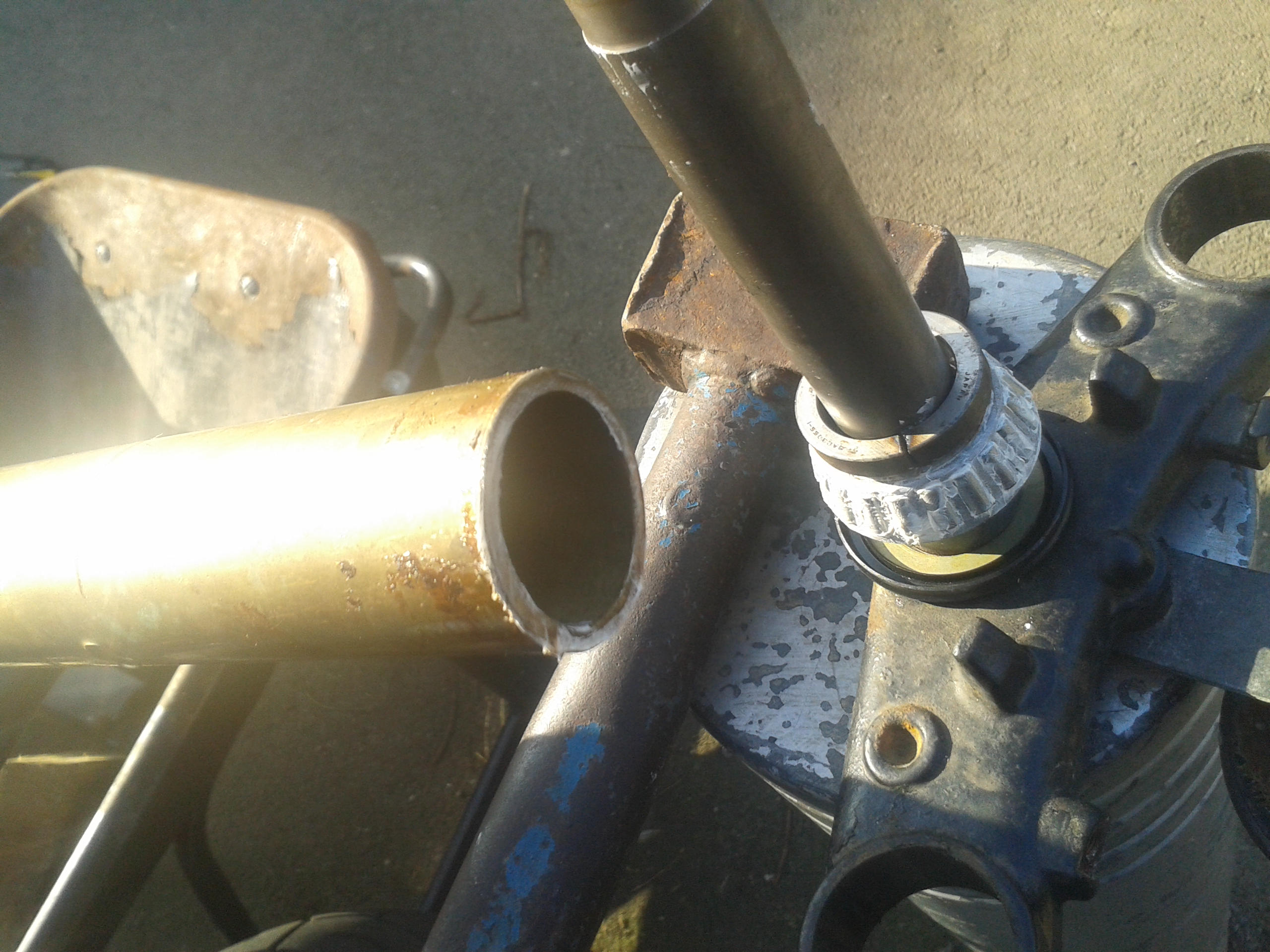

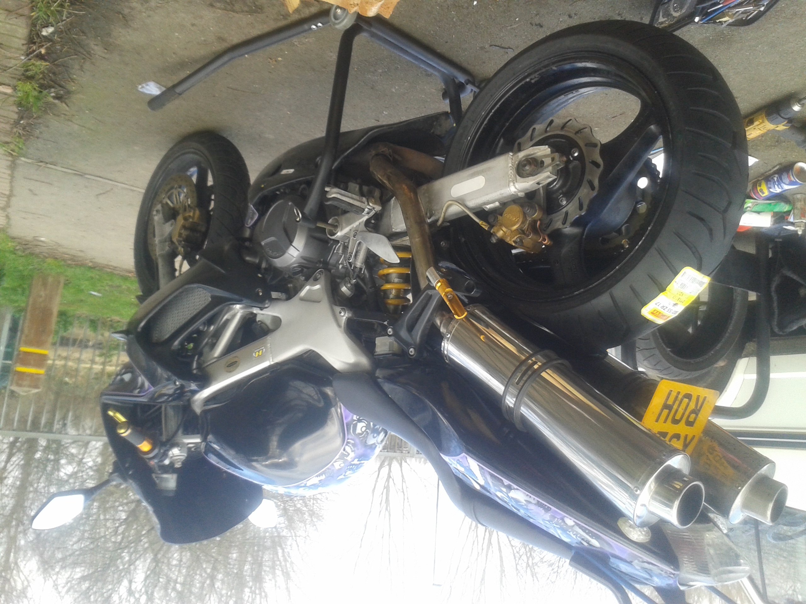

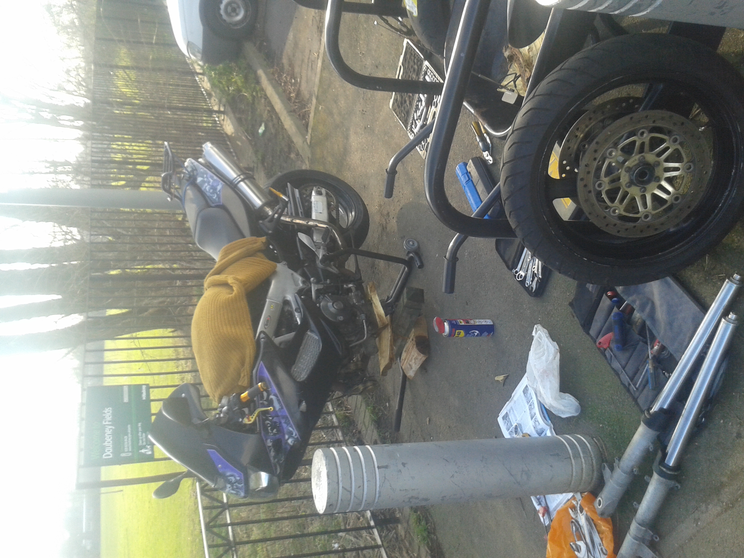

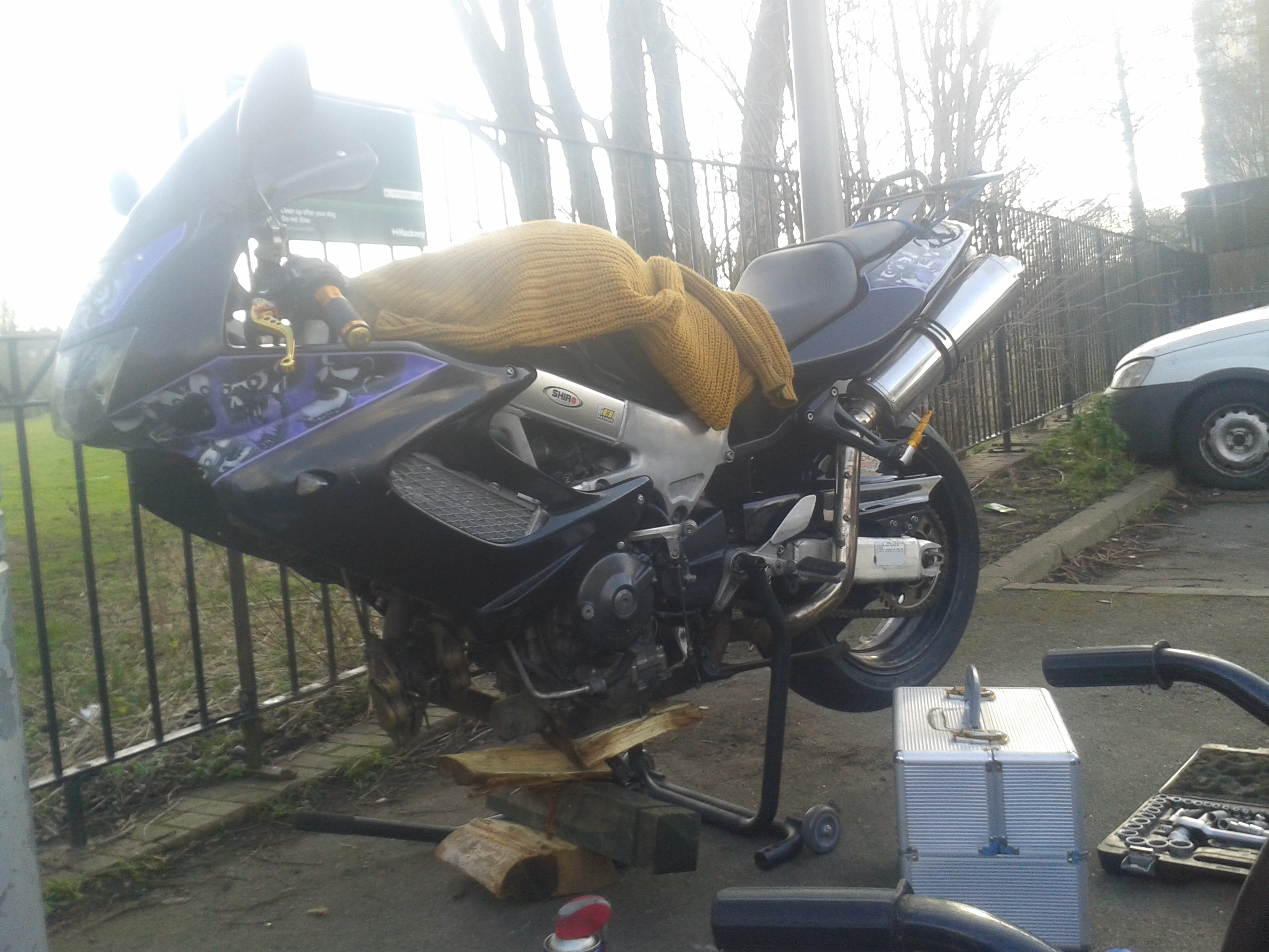

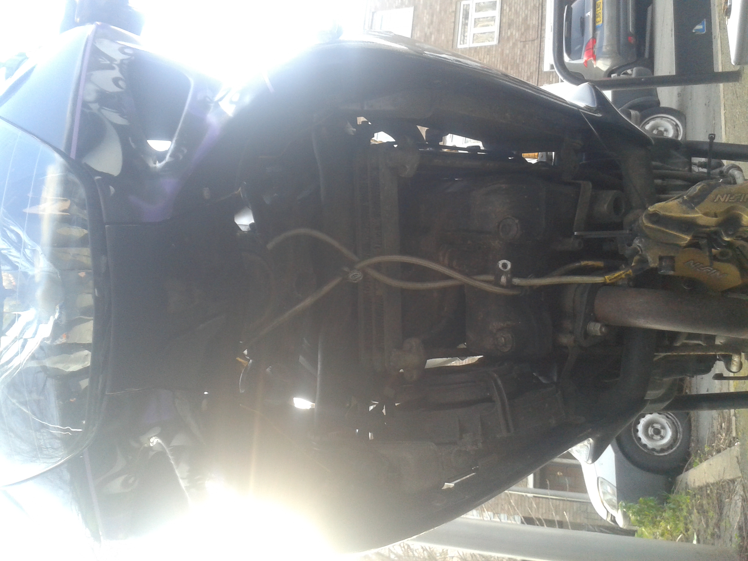

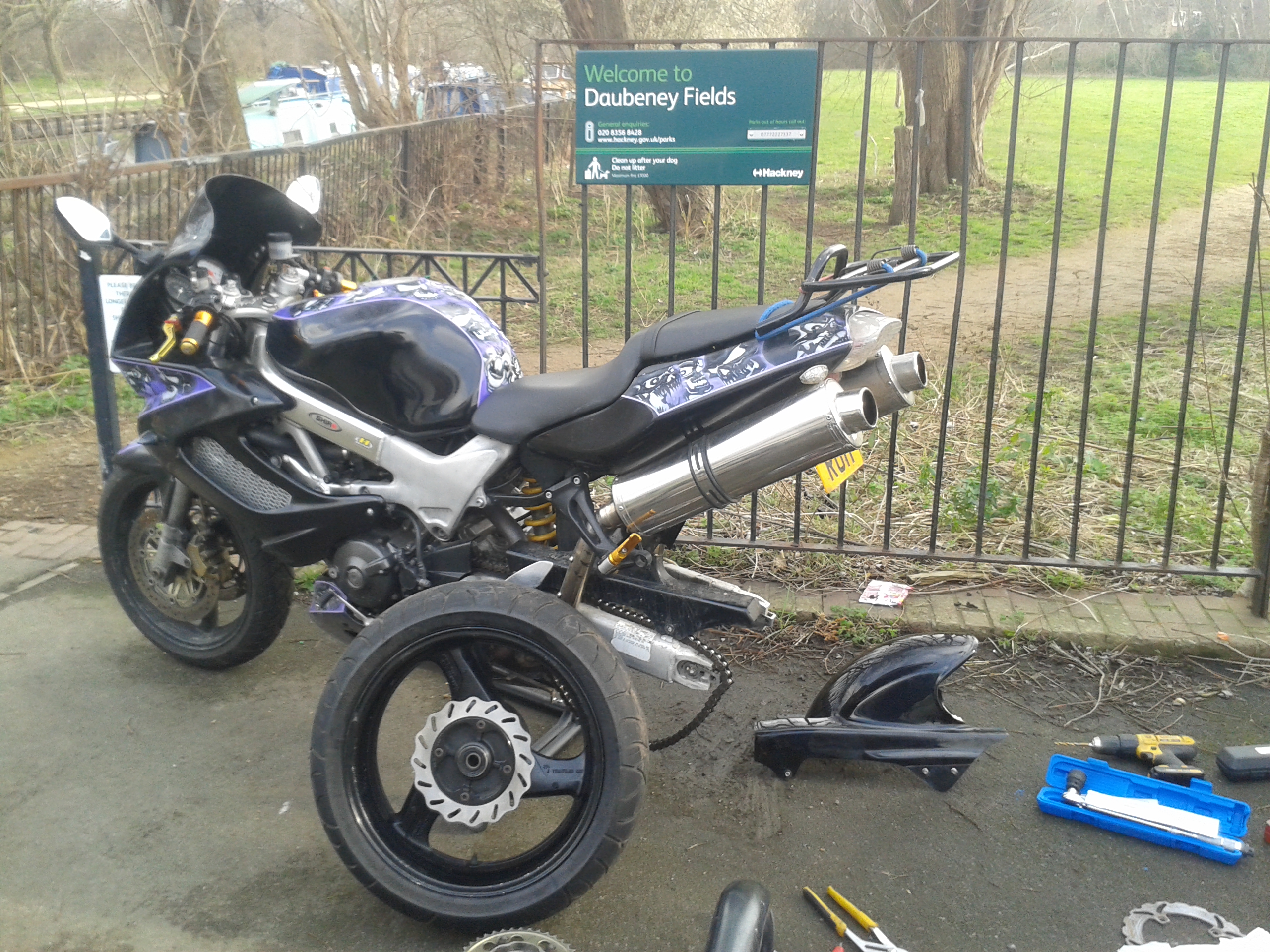

head bearings, brake disc and pads, hugger, rear tyre, numerous seized and broken bolts extracted and replaced.. with ph
Post by fatfreddy000 »
SORRY ABOUT THE UPSIDE-DOWN DUPLICATED PHOTOS- MY COMPUTER HAS MENTAL HEALTH ISSUES..
as the title says..
started 9:30 this morn and was flat out without even a bloody cuppa tea till 4:30 just in time to pick up my boy from nursery (i was very nearly in a lot of trouble)
took a lot longer than i thought as has so many seized and broken bolts to drill and extract, including 2 disc retaining bolts, 2 hugger bracket bolts, 1 front brakeline p-clip bolt and a few others.

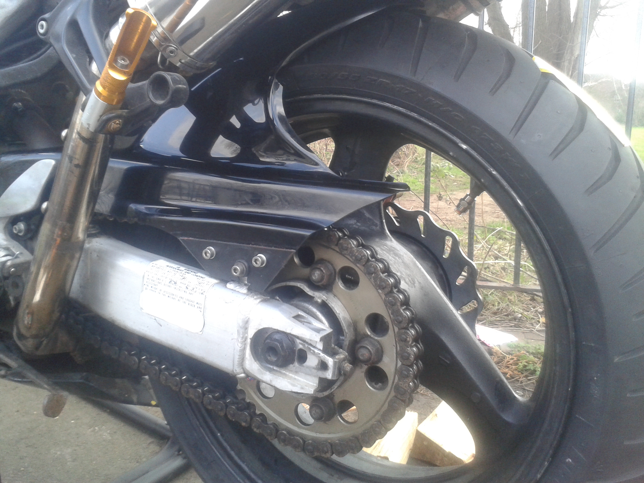

Rear wheel and sprocket all cleaned up and new rear tyre on.
New rear pads.
New chinese rear disc.
Replacement hugger kindly donated by 'kermitlefrog' repaired and fitted.
Exhaust mounts fettled with to stop them interfering with the new hugger.
Lots of rusty bits cleaned up or replaced, lots of degreasing and polishing.

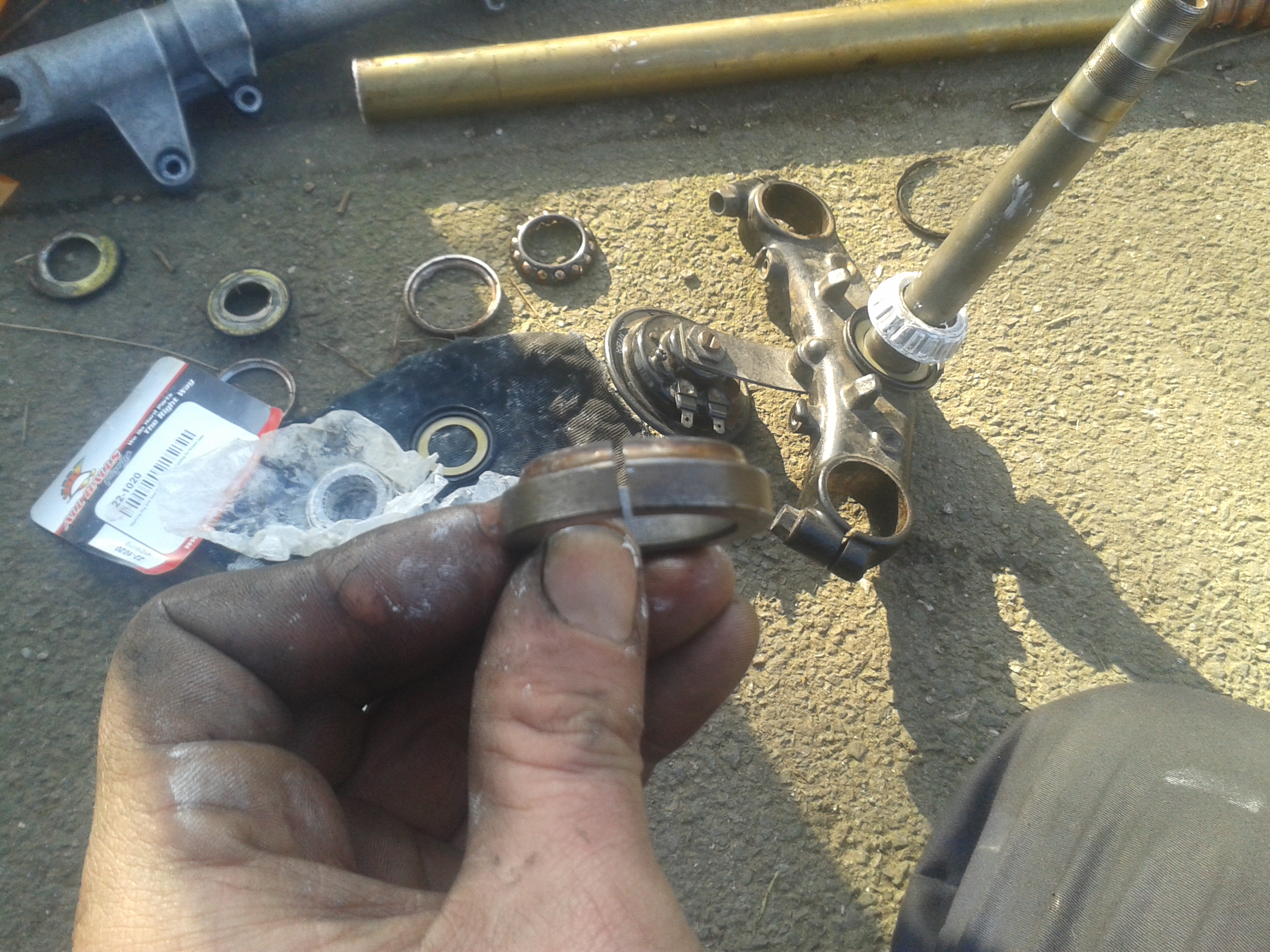

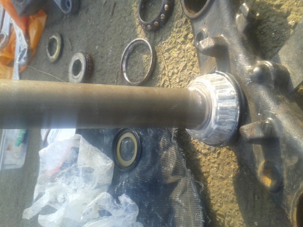

New 'All Balls' tapered needled head bearing installed- took 2 hours 20 and was a cinch except hammering in the lower outer race (bloody fiddly trying to hold the old race up as a drift while whacking a lump hammer with the fairing still on)
anyway she's looking good.
still got an issue with the rear disc even after taking apart again and cleaning the mating surface on the hub- just won't run perfectly true- ever so slight a wobble on the brake caliper.
the areas between the 4 retaining bolts seem to be a little more proud, can't see that this would be possible even by over torquing (and i used a torque wrench)... any ideas?
my partner and son are away to bristol to his grandparents tomorrow till monday so if she's good after a test run I'm off on an adventure for 2 or 3 nights on the bike, .. plus the sun's gonna be shining- cant wait.
just need to have another look at that disc in the morning, plus gotta do an oil and filter change and modify the pilon footrest hangers so i can get the exhaust cans sitting better.
