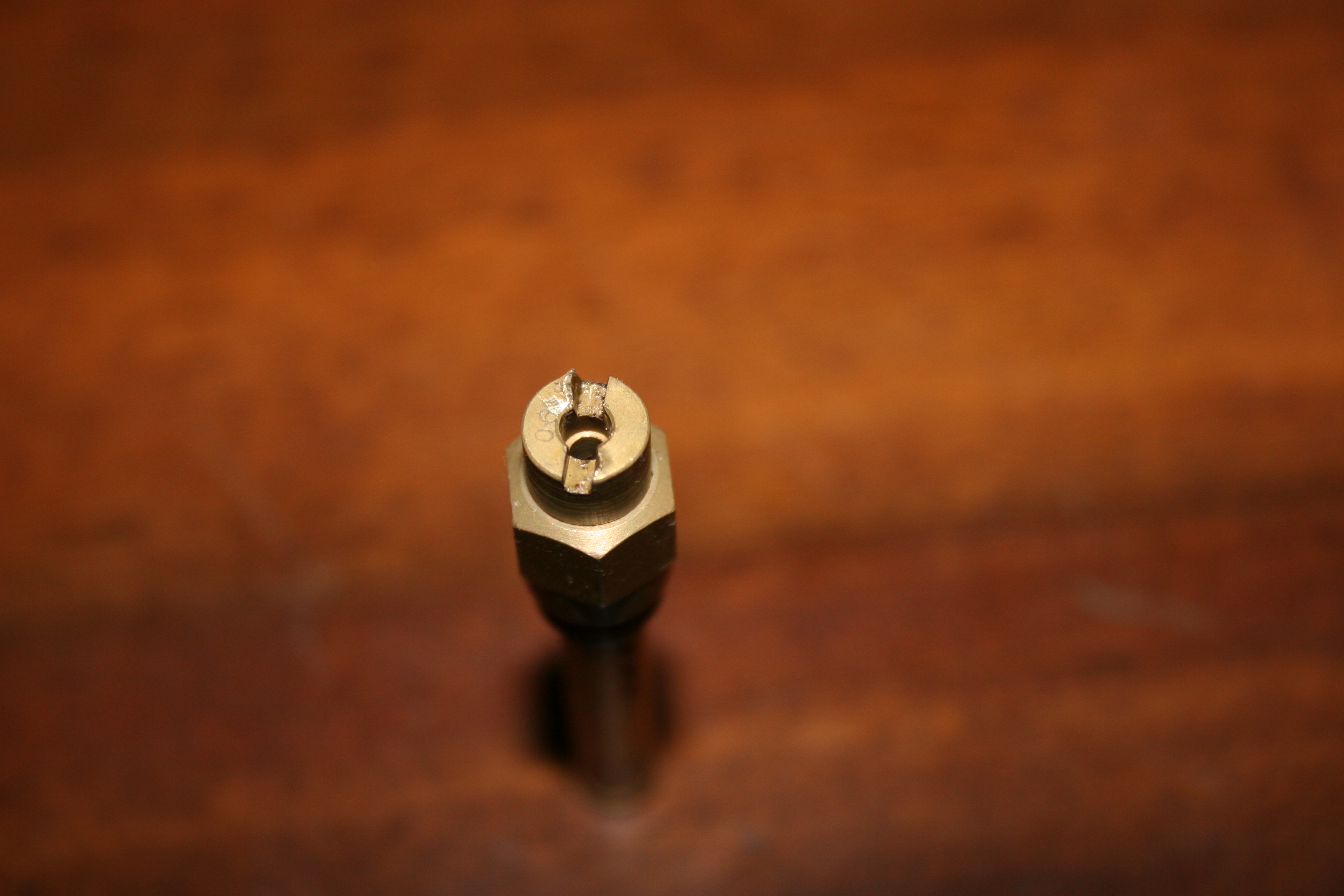

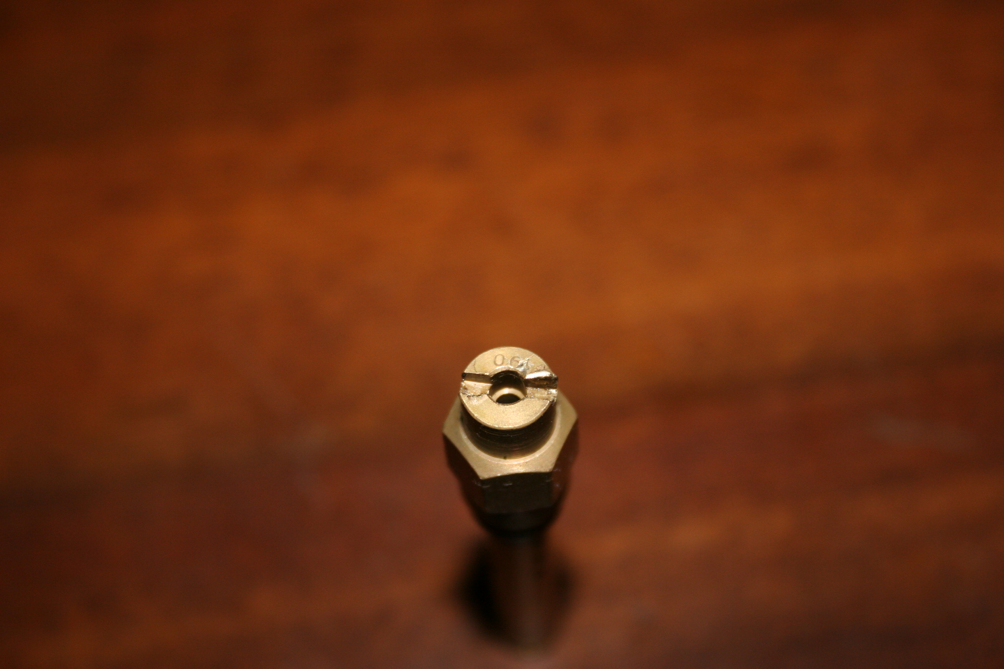

Hello again,
stripped my carbs for cleaning and found that they are fitted with DynoJet needles. 4th slot from the top.
Both carbs have a 190 main jet. I am assuming these are DynoJet jets. I tried to remove the rear jet to examine it but it is stuck fast and I have burred the slot.
The bike has aftermarket standard type air filter and standard silencers.
I have several questions:
1) Is the burring irrelevant or should I file it smooth or should I replace the jet.
2) I am also assuming that this setup is too rich. Both plugs were black. Therfore should I replace both jets with smaller sizes or lower the needle with the current jets to lean the mixture or fit a free flowing air filter.
Possibly a conbination of all these.
Any advice or opinions are welcome but please bear in mind that I am trying to spend as little money as possible. :thumbup:
Thanks in advance.
Mark

They are a tad on the large side for mains. A 180 / 185 would more than likely be better or even two 180s or 185's for dynojets. How was the bike running before. I wouldn't worry too much about the burr in the slot it's the hole in the middle that's more important. Lets hope you havent got any slivers of metal stuck in the carb anywhere. I would try leaning off the needles to compensate and see how things run. Move your clips 1 slot torwards the blunt end, but be aware this will also have an affect on your pilot so you may have to fine tune things down there. Start with the clip position and see how things run first. Don't loose your diaphram springs and make sure you don't pinch the diaphram when putting back together. A little grease around the edge helps to keep things in place. Also how many lift holes have you got in the slides.

I have never ridden the bike. Only saw/heard it running. It started willingly enough (not surprisingly if it was so rich) but there was a noticeable ticking/clicking noise and fearing the CCTs might be on the way out so I have not yet ridden it.
No slivers of metal in carbs as I burred the jet trying to separate it from its tube after removal from the carb. These I plan to sonically clean. No new lift holes have been drilled (which I believe is a good thing). As earlier stated the plugs were black. I assume that at one time the bike had a hi-flow filter and free flowing pipes fitted which have since been removed. It has had 9 previous owners :? .
The front carb had quite a few of spongy bits in it as those little filters in the airbox had disintegrated. I have bought a square of filter material to cut new ones.
I have contacted Dynojet to price up a couple of smaller jets. If they are not too much money then I will fit them and keep the large ones for use if upgrade things in the future. Otherwise I will try leaning the needles as suggested.
