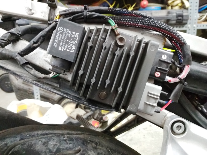

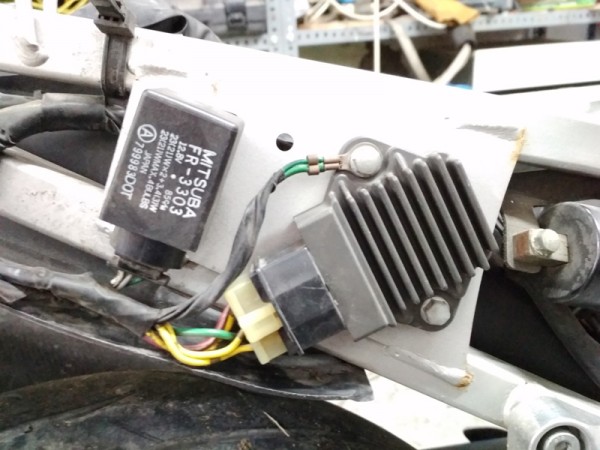

I have changed this afternoon the regulator in my VTR, ( yes, the one that I used for the experiments) and works perfect. Here some pictures

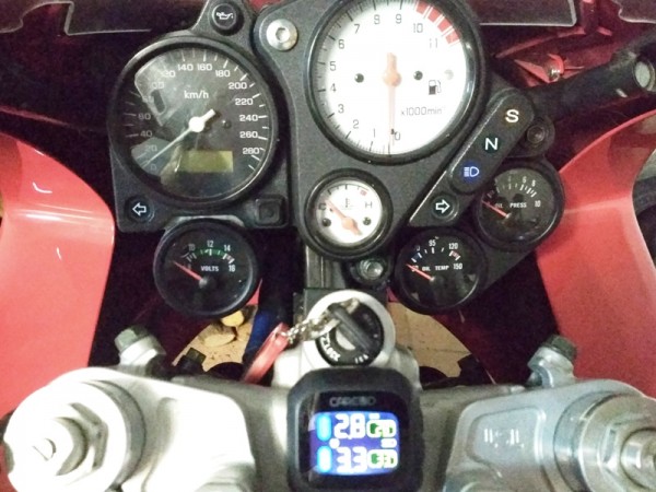

I have gauges installed, i like to check time to time.
Anyway, with new ( and upgraded) regulator and new battery you shouldn't´have problems in some time..
At starting I like to check that the regulator is working, and oil pressure is ok, and tyre pressure is within limits..
I installed gauges in the transalp some years ago, and in the vtr I missed them.. :whatever
