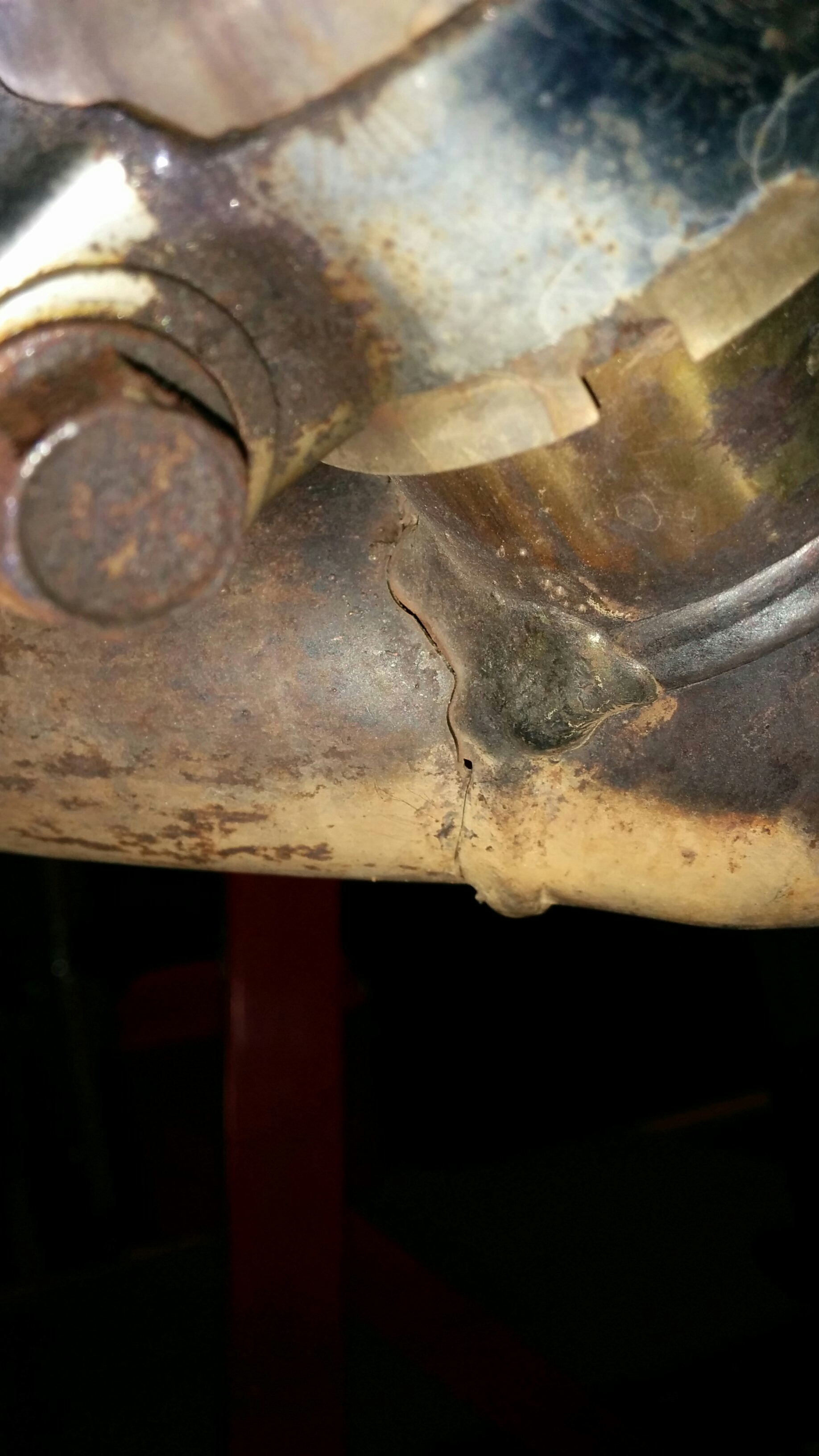

I found a crack in my standard exhaust at a weld where the pipe forks for the silencers. It's cracked about half way around the pipe. So the exhaust has to come off and I've loosened all the fasteners except the front lower header stud nut.
