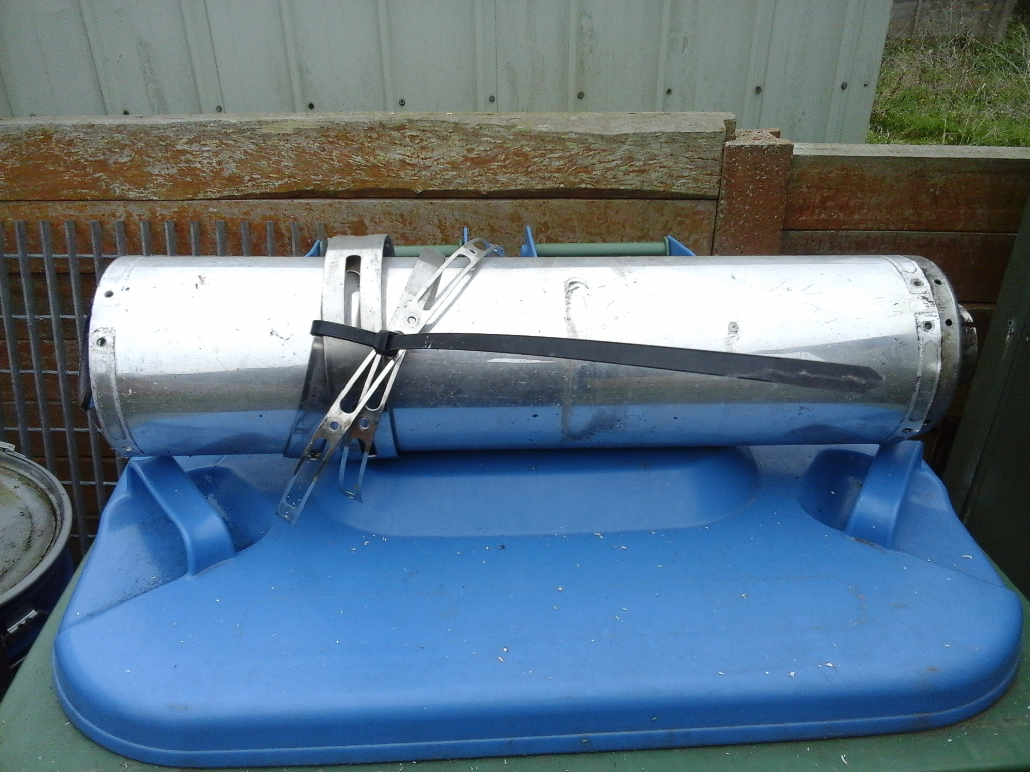

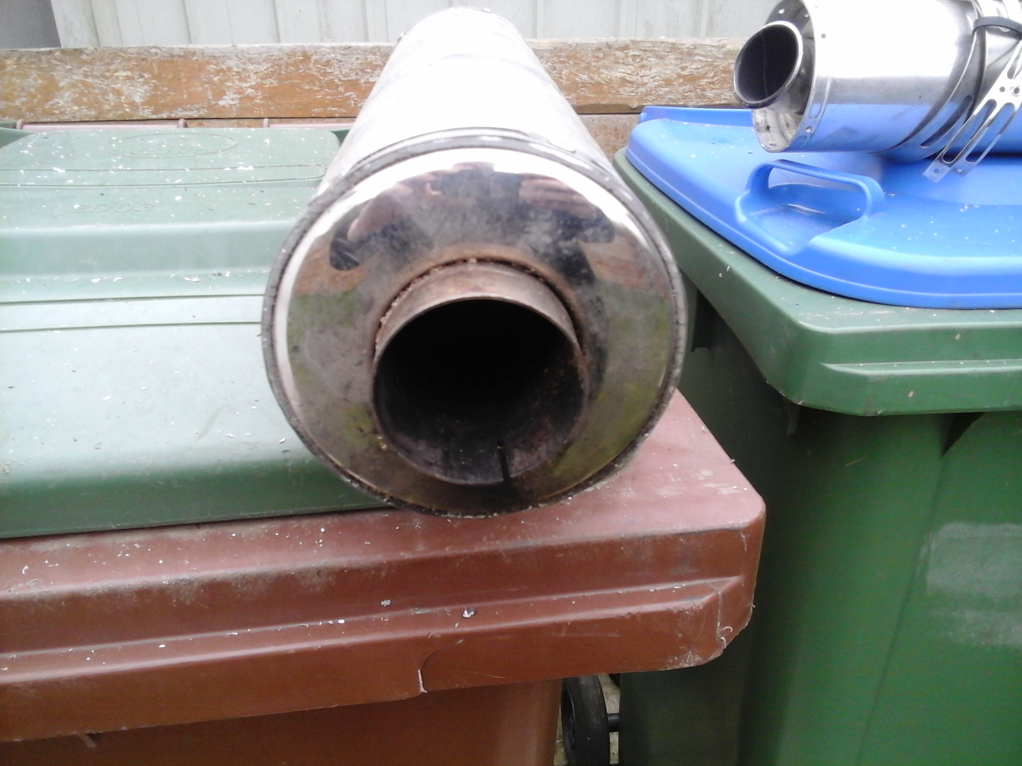

In the scratch & dent section of Franks Acme Spares Corp there are a pair of unbranded cans which with a set of baffles in might do you...
They are rough & partly dismembered...IIRC the PO was going to stubbie them but gave up & sold the bike...Bananaman ?
Open to offers...£'s
