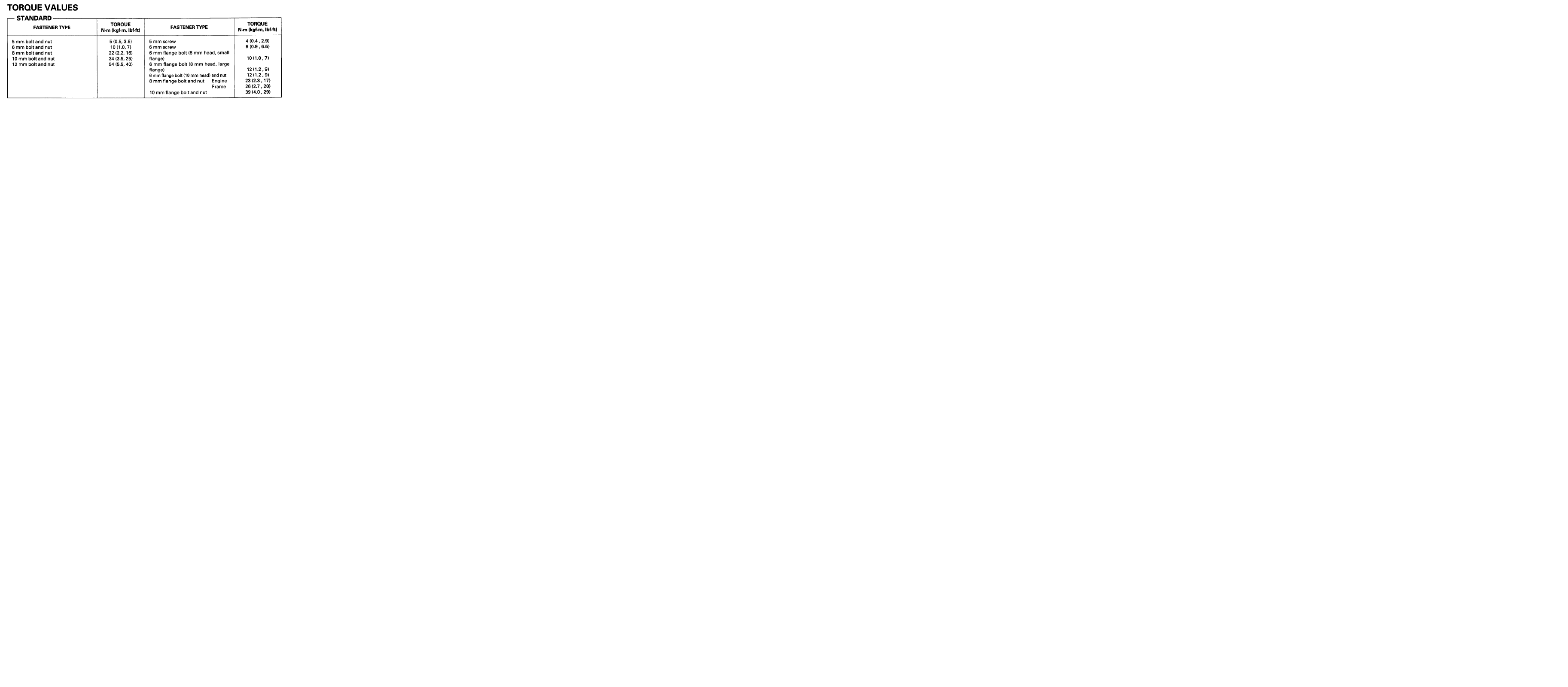

Anyone know what this is?
Couldnt fond it in haynes
Just cleaned out sump on one of my spare engines

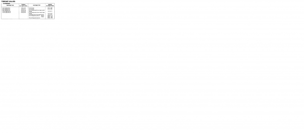

Honda are not as helpful as you'd hope when it comes to torque for case screws. I think the only info in the manual is this.
