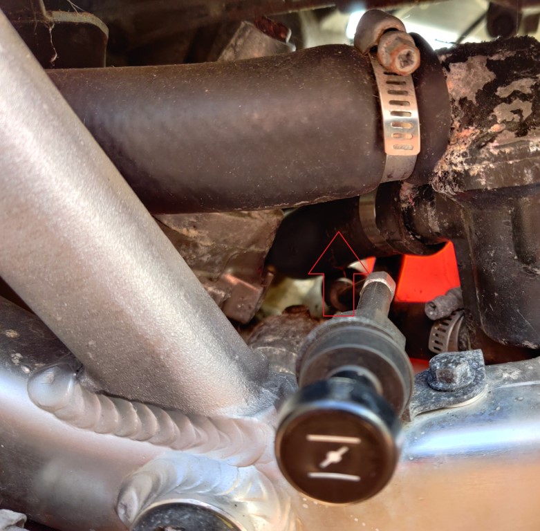

So the only snagging thing I've found so far (other than the cosmetic things), is this coolant leak.

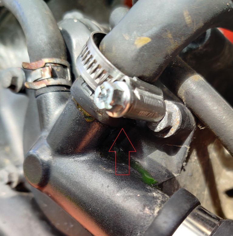

I've highlighted where the leak is. I had broken the hose clip and hoped that would be an easy fix. But it still leaks a little bit. The other picture is showing what I think is the other end of the hose, but just wanted to check. Can someone confirm?
Not decided if I want to go to the expense of a full silicon hose set or just replace that one.

Hi, it looks like you might have corrosion on the aluminium spigot.
I'd remove the pipe & clean the spigot & if the pipe's long enough cut a little off & give it a go
Re: Coolant leak
Might look like corrosion but I think it may be sludge that's leaked out. Coolant wasn't the best when I drained it. Guess I'm going to have to drain it again and check the pipe.
Had a look at the parts fiche on Fowlers and it's not obvious which pipe it is. Fiche seems to imply the pipe goes to the radiator on the opposite side, but from a brief look out looks like it goes to the one in the second picture. Either way, doesn't seem to show the hose on the fiche.

So it was the bottom hose to the right of the choke lever. What a ball ache to get off too!
Found a split in the end it was leaking from and not enough give in the hose just to cut the end off. So looking at these. Don't see the point in getting used ones off eBay that are still going to be 20-ish years old.
