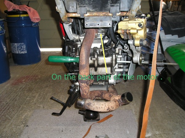

This is my method. Put the the bike on a padock stand. Seat off, thread the straps over the rafters & through the loops on the sub frame... Ratchet them up until just tight but not lifting the bike off the stand... Remove the rear wheel, take note of the spacers & which side they go on, less weight on the swingarm. Crack off/loosen the swingarm nut Do not full remove it yet.
Now the moment of truth...ready...take the padock stand away !
The bike may swing around a bit but thats normal Undo the nut on the swingarm spindle. Dont take it right off, preferably with a rubber mallet, tap the nut to get it moving, fully remove nut, then use the rear weel spindle to push the spindle through...
It's slightly shorter than the swingarm spindle so you cant leave it in place. Once the swingarm spindle is fully out, take the small allen bolt out at the front of the hanger. & the whole hanger will be free apart from the brake master cylinder. There is a spring from the plunger of the M/C to the lever & a fatter spring which hooks from the hanger to the pedal. Use long nose pliers to pull the M/C spring down & out of its location point, might be easier to do it up & out of the M/C plunger but it has a long tang, so have a look & decide which is best... Remove the circlip & the pedal will pull off its prong, there should be a washer on there. Unhook the fat spring.
Top tip take pics on your mobile before you disassemble so you can look at them to check it's going back together correctly...
Reasembal in reverse of above... You may find it easier to put the fat spring on its hooks then push the replacment pedal over its prong if not you'll need a spring puller to attach it... whasher, circlip, line it up push the spindle back through, clean & regrease before insertion, replace front allen bolt with it's spacer. tighten up the singarm spindle nut...but not fully tight just yet.
Put the rear wheel back in having cleaned & regreased the spindle, spacer with the lip on it goes on the sprocket side, use some grease to hold the spacers in place, put the chain back over the sprocket, slide the spindle in left to right. washer & nut on again finger tight for now...
Now get your padock stand back under the swingarm, push down & you get that slack back into the straps... Once back onto the padock stand time to go round & fully tighten the the bolts...Allen at front of hanger, swingarm spindle 93nm torque rear wheel spindle 93nm torque... Adjust chain. Remove the straps. Side stand down. Remove padock stand, clean tools, clean hands & either take it for a ride or crack a stubbie open... :thumbup:
If you don't have rafters avaiable you can use a large step ladder as an A frame, use a good thick bit of timber as a cross member to put the straps through...
Mine hanging from rafters for a compleat swingarm removal...
