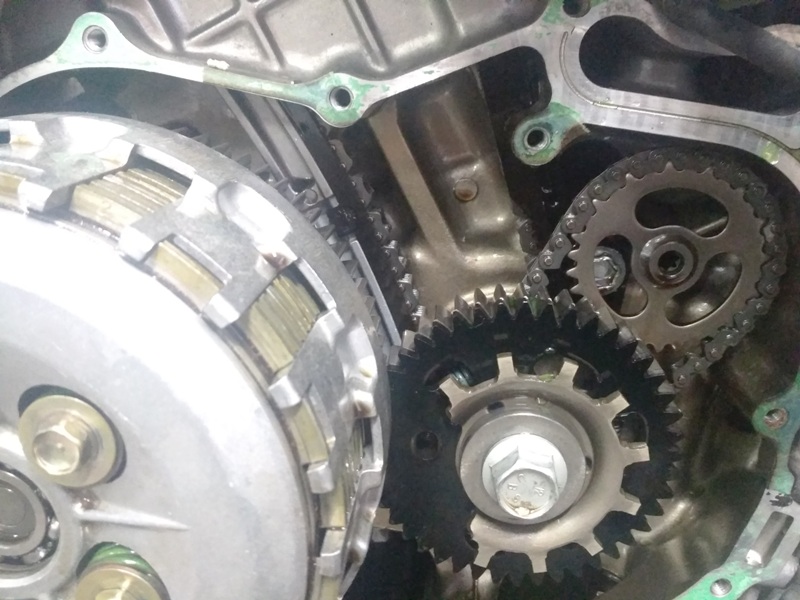

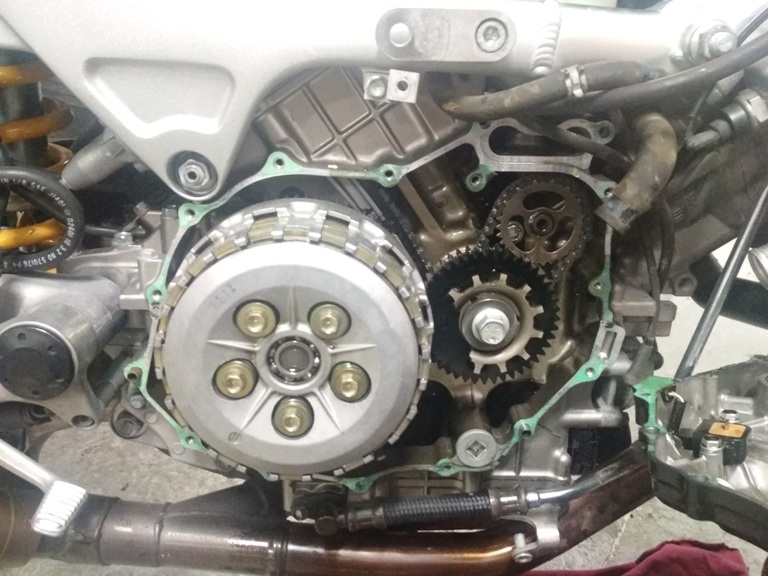

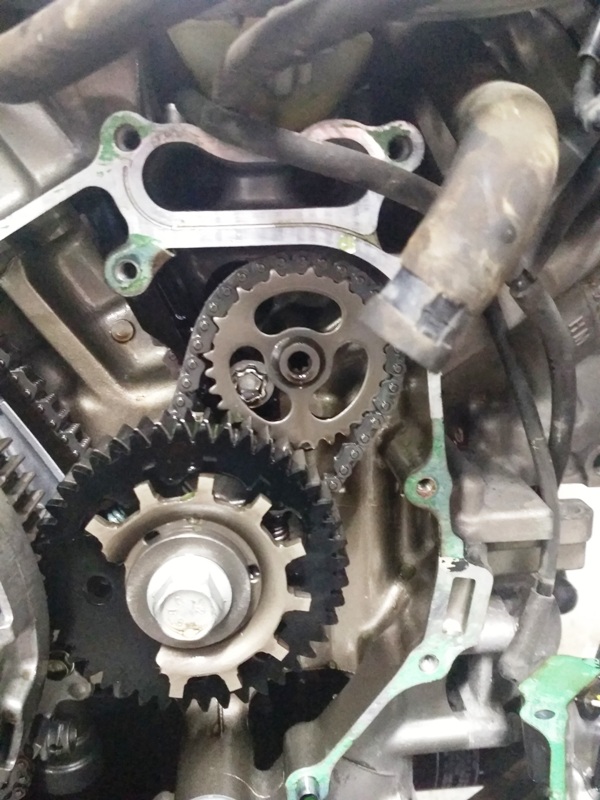

I changed the clutch discs just after buying the bike because a bad working in the clutch system, ( the problem finnally was the slave cilynder that I changed by a Oberon ). I noticed then that the engine was like new inside, absolutely clean, with 85.000 km. ( check pictures) . Since then, I have been using semi castrol 15W50, ( changing every year) and seems to work fine, but the clutch discs tend to be sticky with cold engine first time when I insert the gear.
