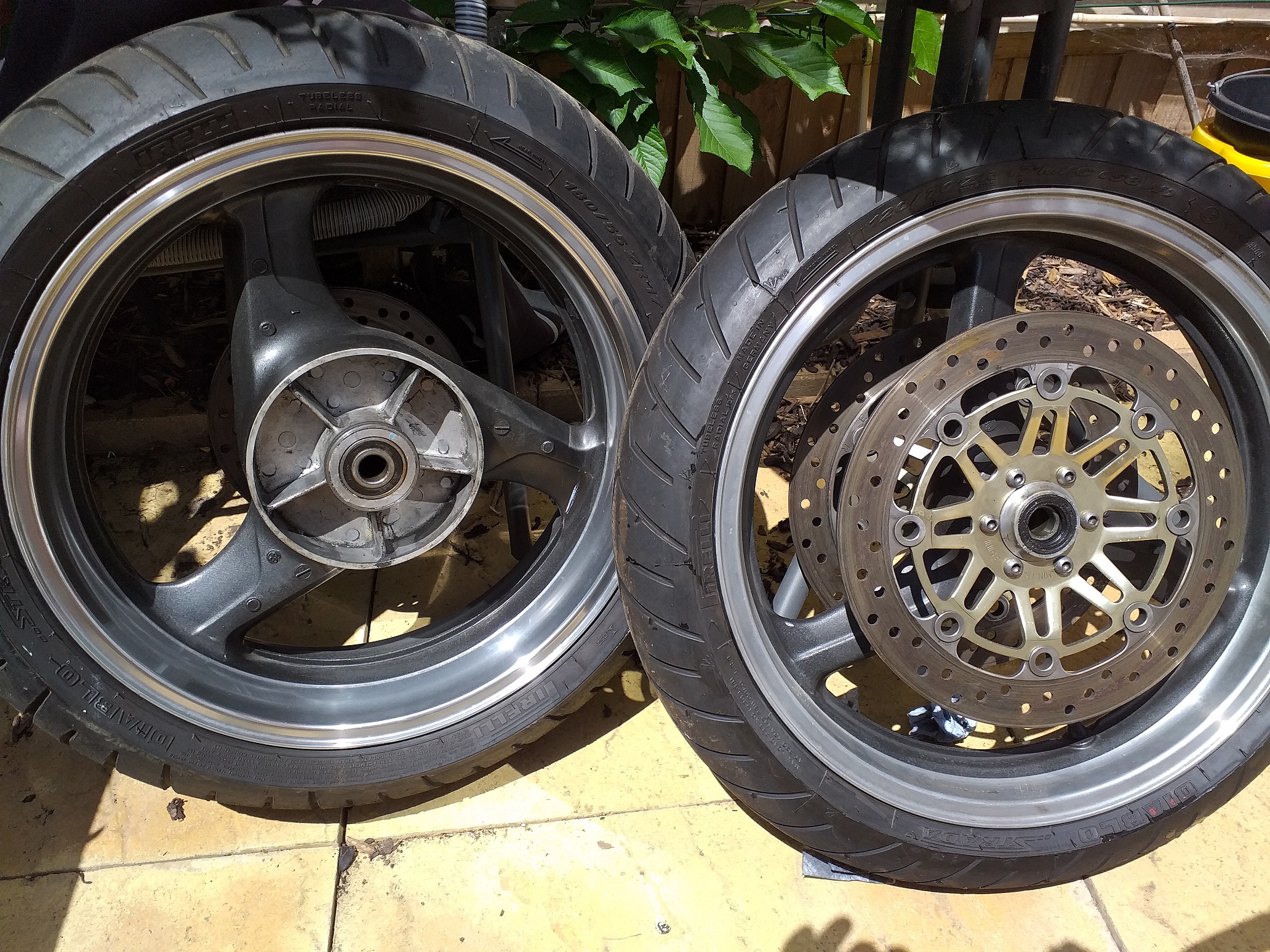

I do like the look of polished wheel rims like nigelrb's above though.
