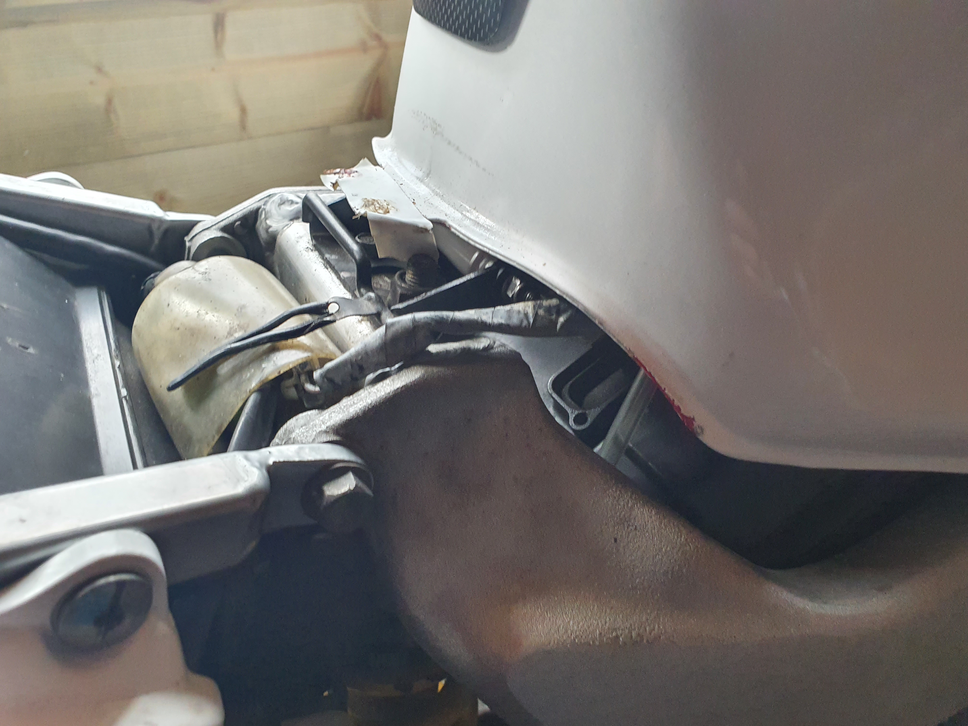

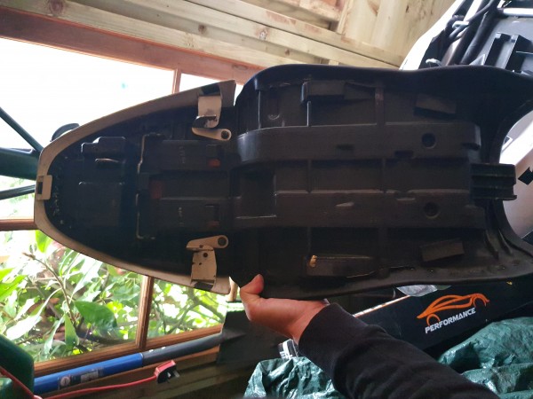

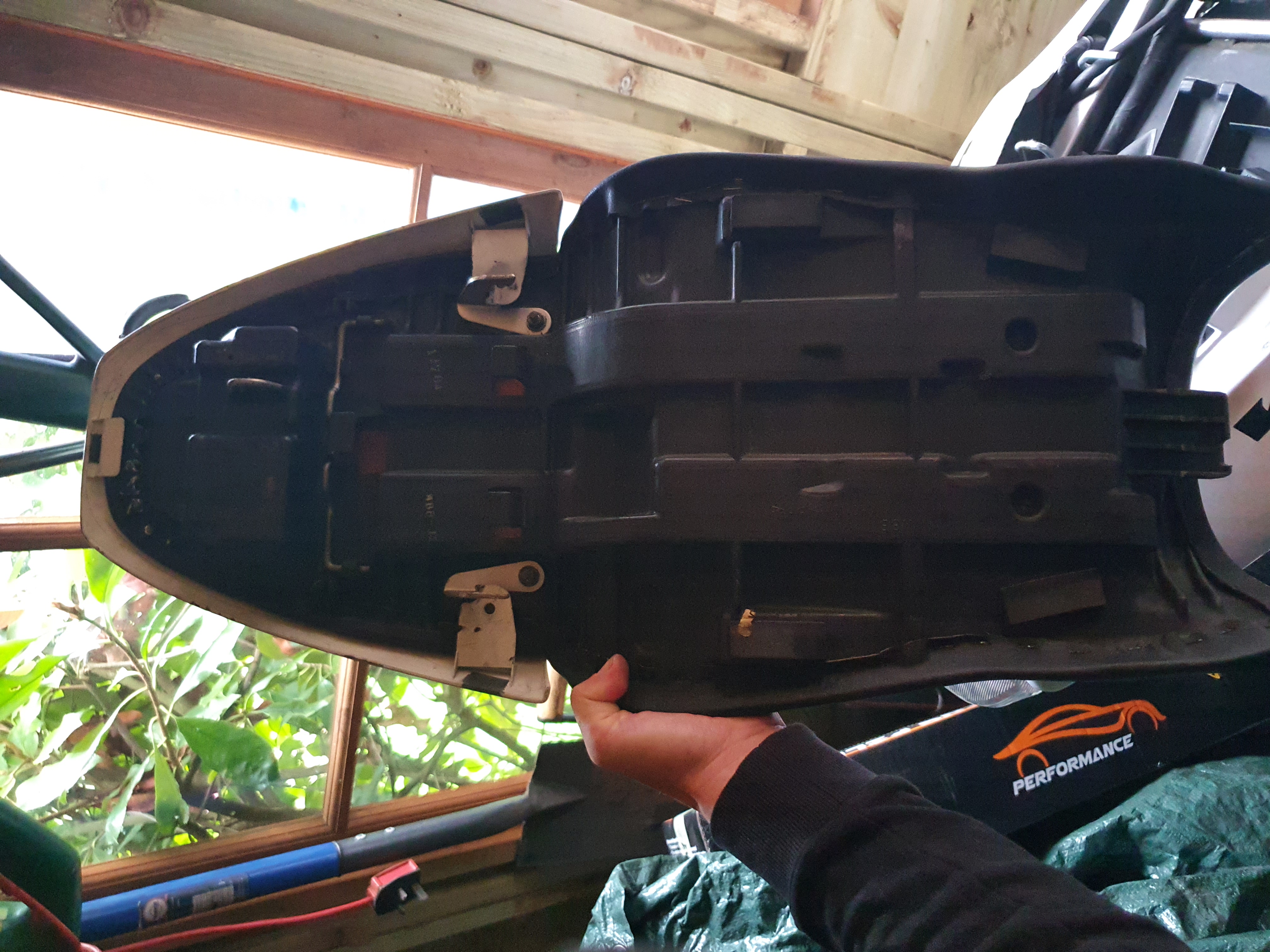

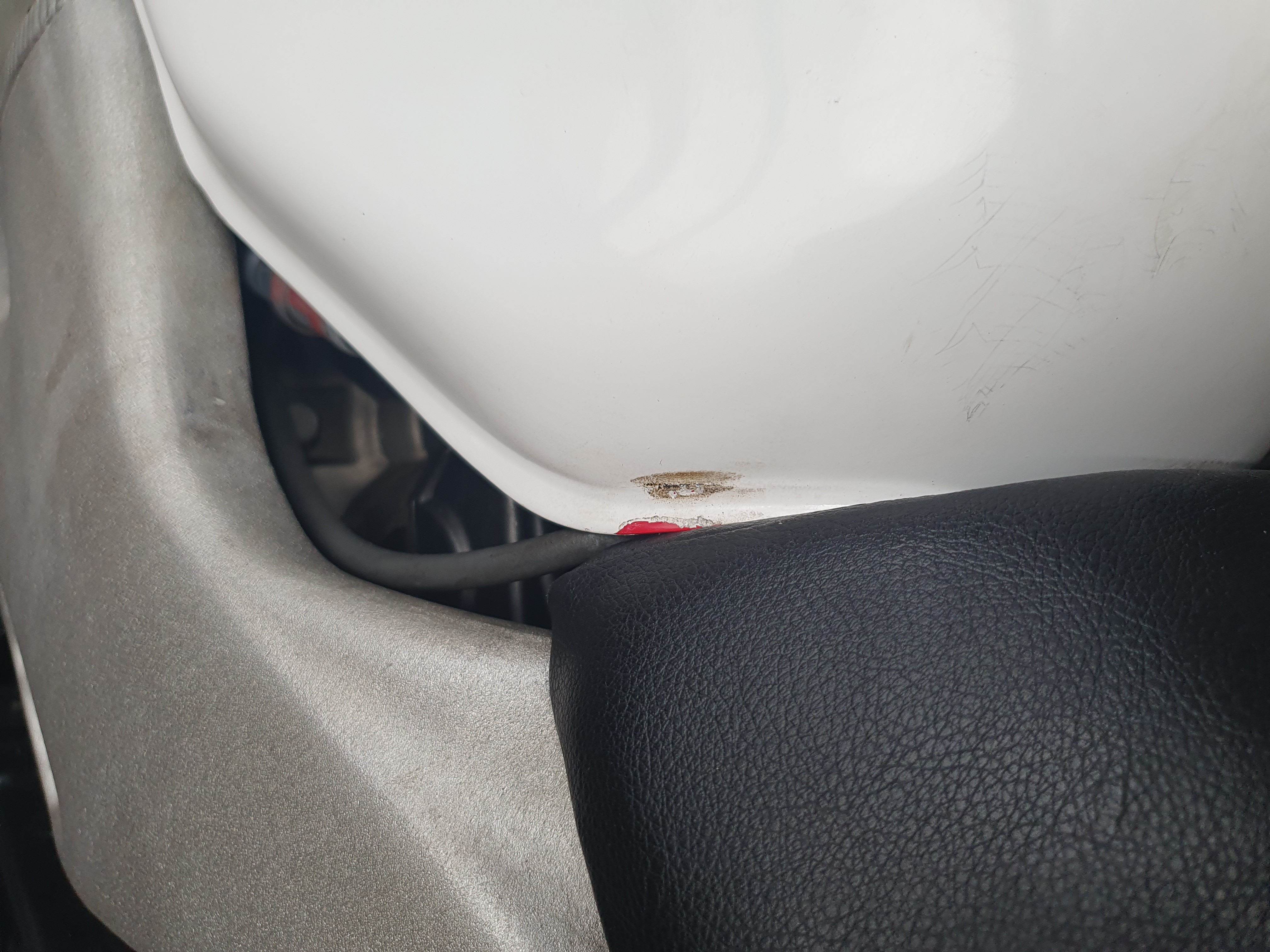

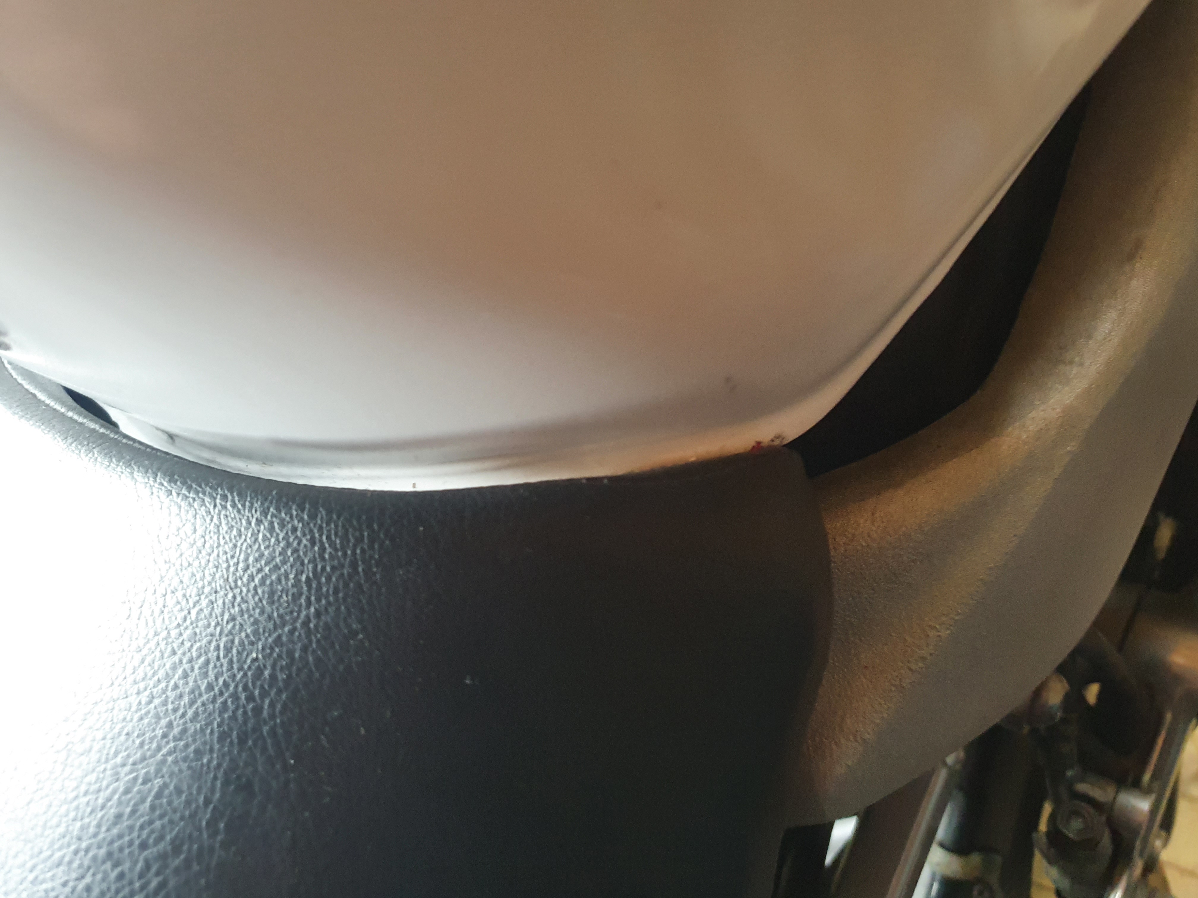

Hi im sorry its been a while business picked up so been busy, I've attached some photos of the seat hope helps if need others let me know unsure what it could be.
Thank you again
Ross
Re: Seat rubbing on tank
There should be some rubber trim along the edge of the tank...
No.14... https://www.ronayers.com/oemparts/a/hon ... /fuel-tank
You should be able to pick up some u-shaped trim from a motor factors that will do the job.
