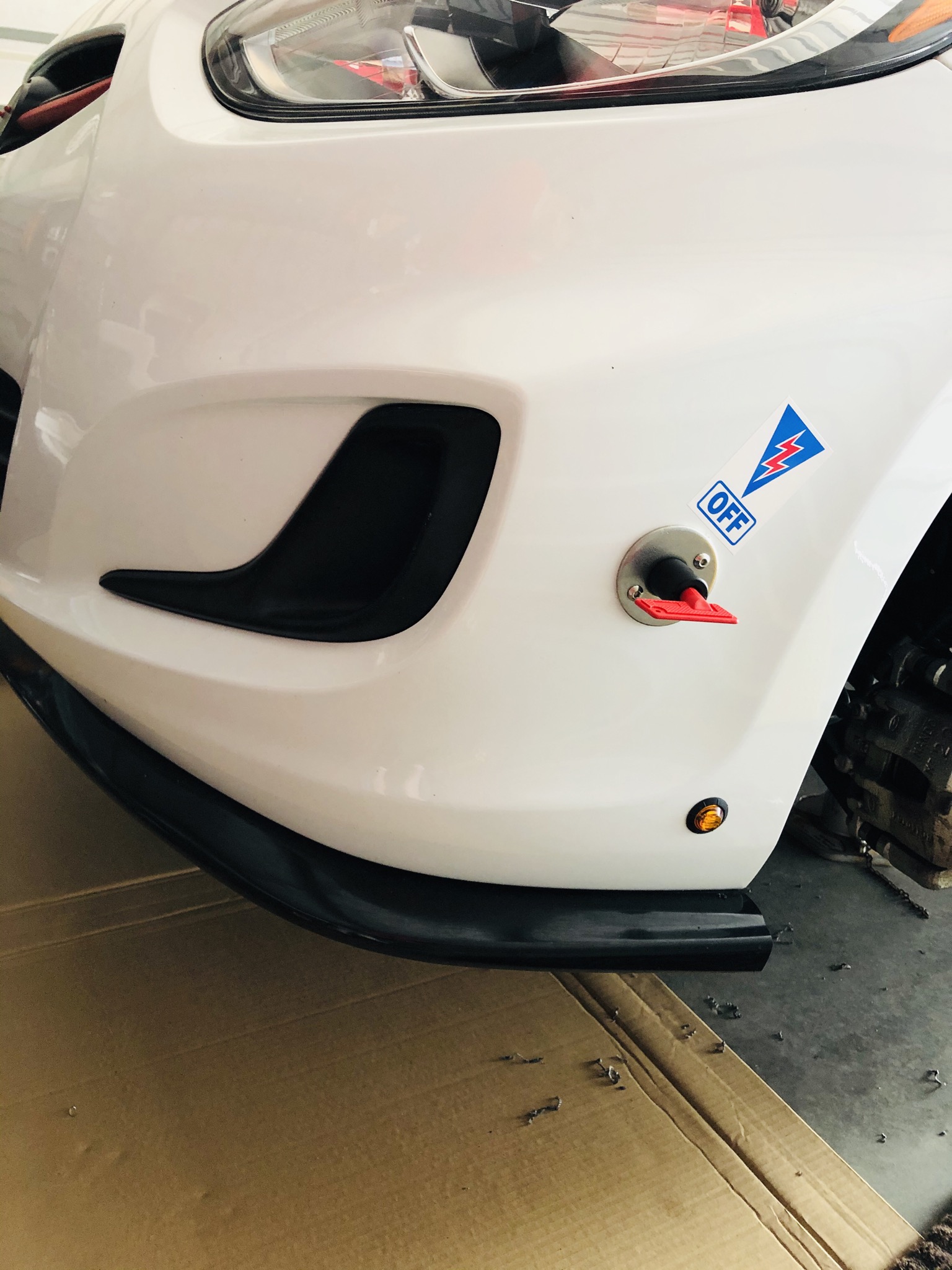

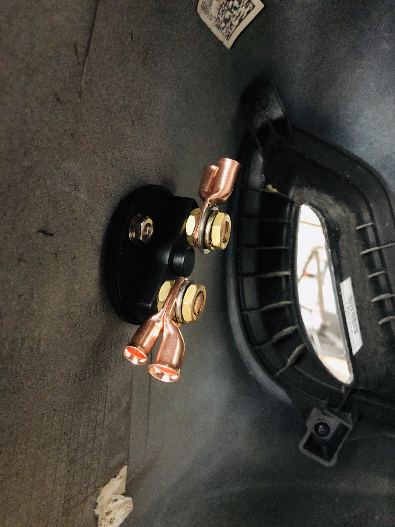

I thought about installing a battery disconnect on the bike with a key like I've done on my project/ track car and drag car years ago.
It would help with theft prevention among other things and since I drive a truck for up to 6 weeks at a time I just simply turn the key and no connection.
This is exactly what I'm now doing with the car as it makes it much easier to turn a switch than open a hood, use a tool, and disconnect the battery. Same with the bike. The switch is rated for 100 amps continuous with 300 amp surge for start up.
It's still in the idea framework right now but something I may actually do.
Opinions?
