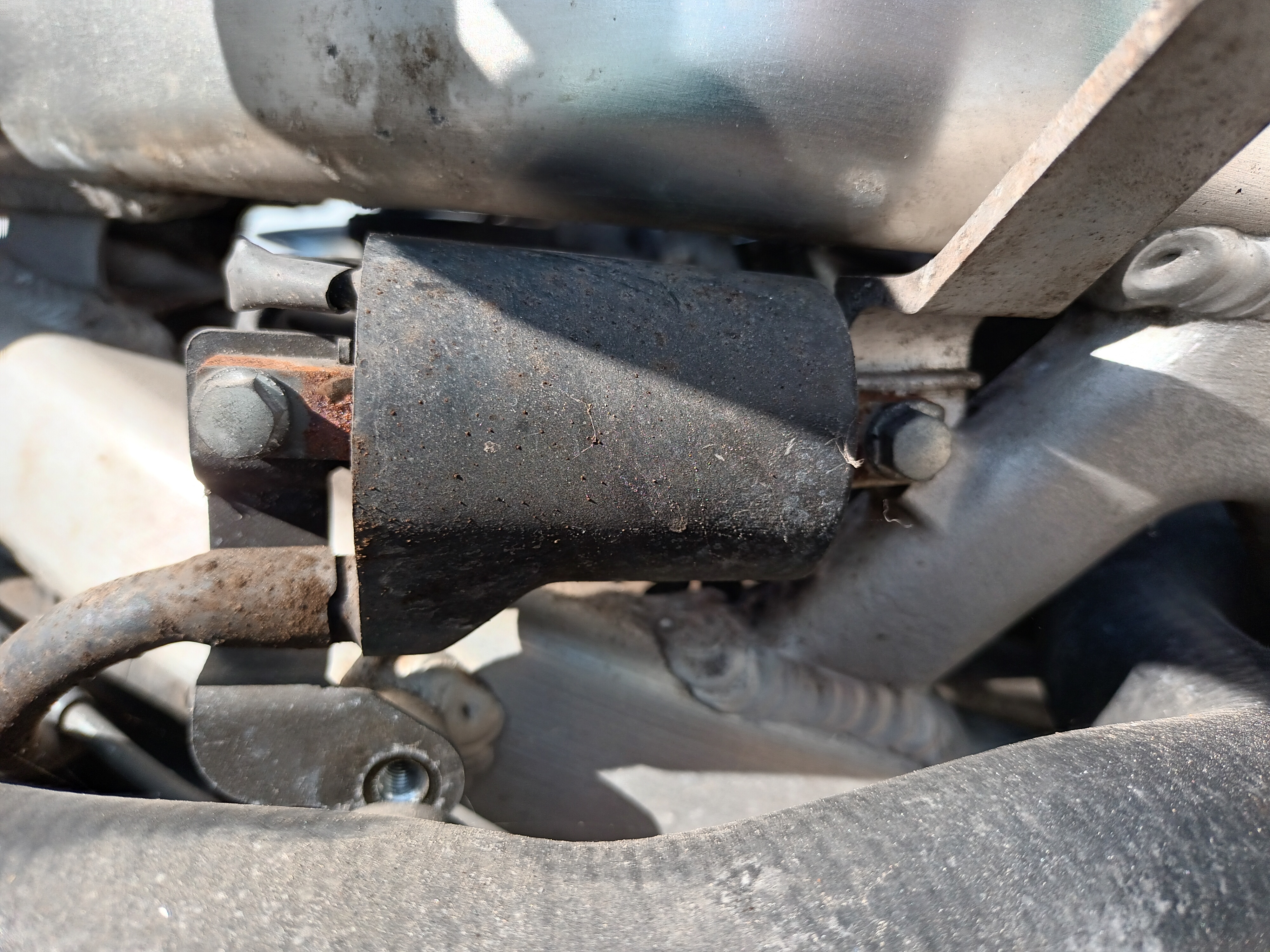

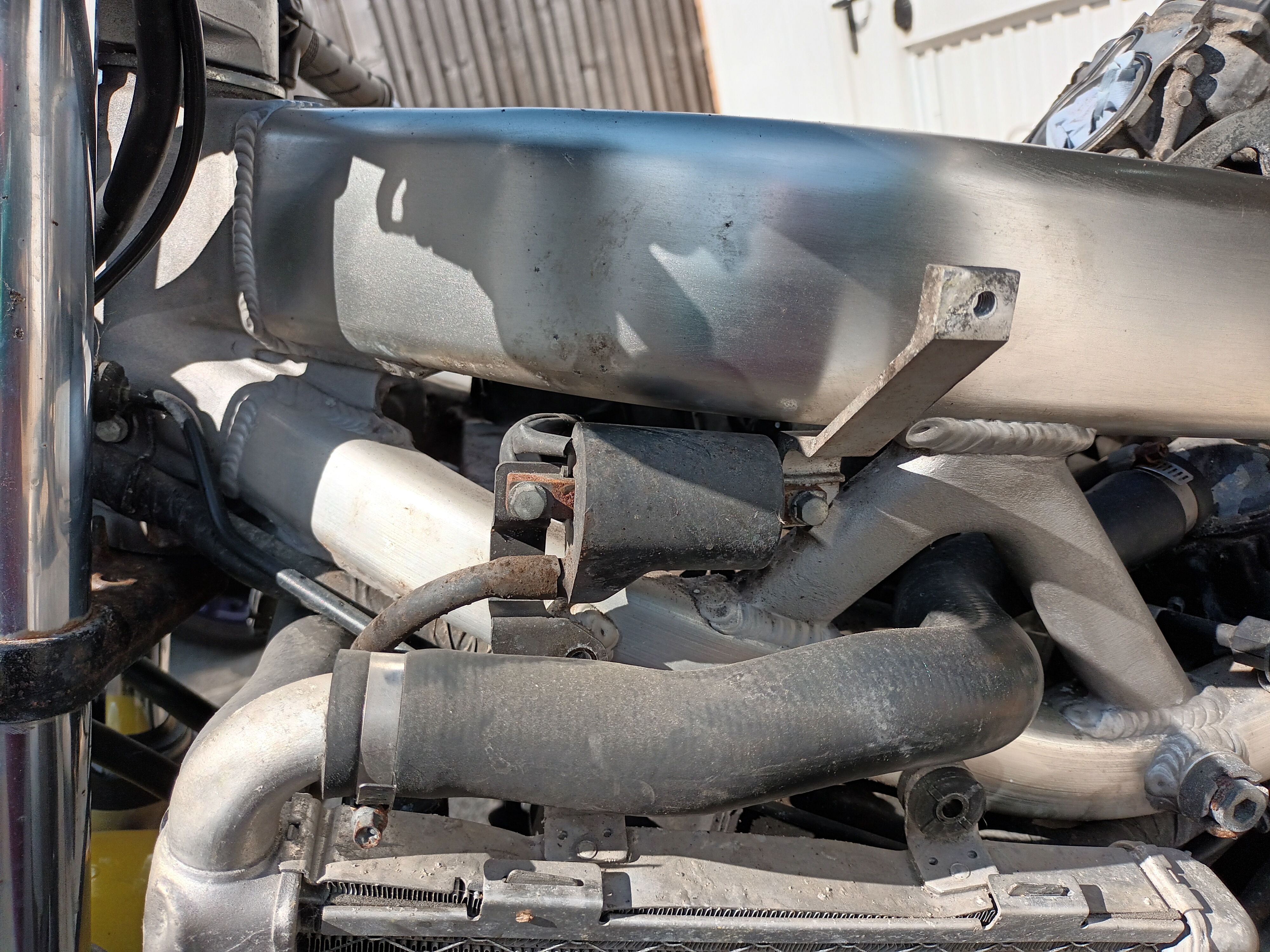

Got all that fixed turns out the bolt was grounding to the casing now I just need to know how to mount the front ignition coil pictures would be nice unfortunately I didn't take them when I changed them
Posts: 16580
Re: Regulator Rectifier Charging System Diagnosis Checks
Well done sorting the starter problem :thumbup:
Can't help with the coil pictures as mine are in a box in the loft...... I fitted stick coils years ago
Posts: 17508
The bottom bolt is the left hand rad fixing.
