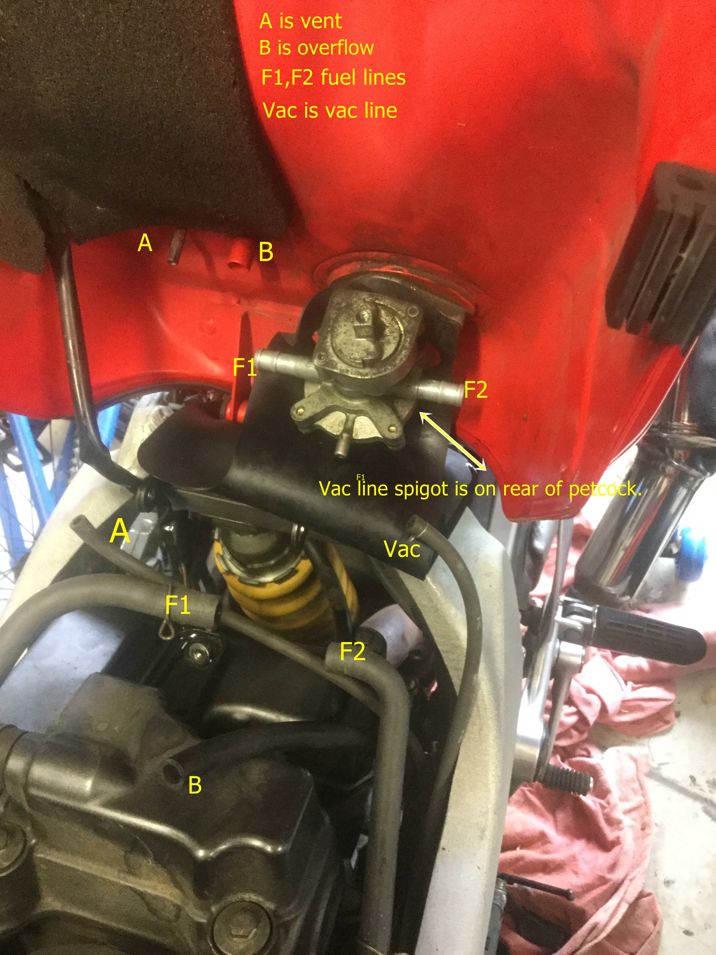

Some snapshots from under the tank. To remove tank ok to remove all hoses at once? Is the main part with all the hoses connected some sort of vacuum switch? There seems to be one hose missing from the bottom.

As in pic's the two to the left Are a breather & overflow... Just check to see if the missing one hasn't just dropped down, both run to the left side of the bike & drop down near the front left of the engine by the little fairing.

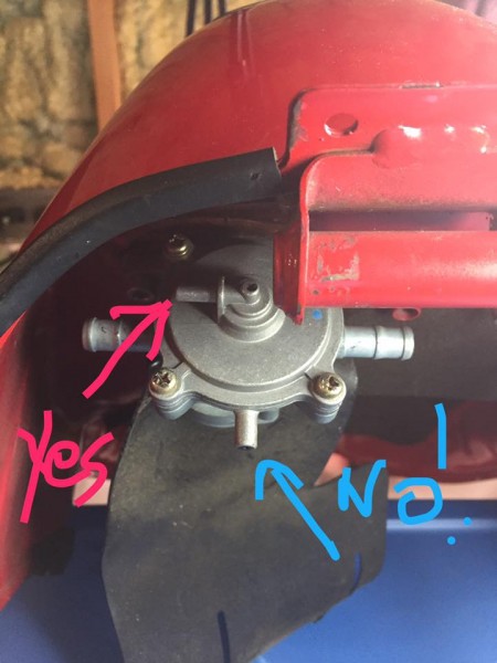

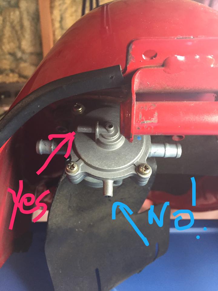

The petcock is vaccume opperated & fule should only flow when the engine is running, the pipe runs from the rear cylinder block to the rear of the petcock & MUST be fitted to the spigot pionting sideways 9o/c when veiwed from rear.
Sometimes there will be a T peice spliced into the vac pipe this will either be for carb balancing attachment or a Scotoiler... It should be capped off if its for balancing...
You might get some fule out of the fule pipes when you remove them thats normal & nothing to worry about...unless your smoking or the engine is hot :lol:

Yes, I see what you are referring to. Is anything meant to go on that "spare" connector that has no hose?

You are correct as in, no hose is meant to go on that outlet facing the floor.
