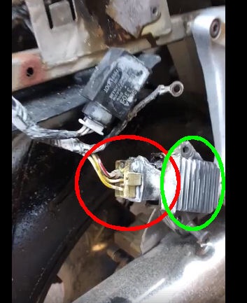

RR getting hot is normal it's part of how the electrickery does it's voodoo...
However if its uncomfortably hot to touch then it would appear you have an issue with that RR...
I don't think it should be hot enough that it's not just 'a bit warm'
They dont call 'em rectum friers for nothing...
Burn RR.jpeg (56.24 KiB) Viewed 911 times
Not mine but apparently he had flames with this one hence the extingisher powder... 8O

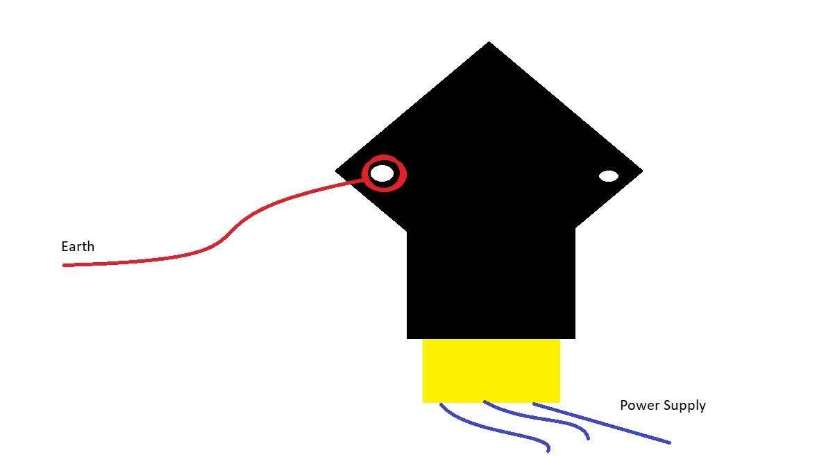

I got an R/R from Wemoto that states 'uses Mosfet technology'. Good enough for me. Anyway, I've plonked it on and was just curious as to whether, what I assume is the Earth, is on correctly, or whether, in-fact, it matters that much at all. Since my garage is a mile away and I forgot to take a photo, here is a diagram, ok, a sh*t diagram, of what I'm trying to explain.
Is it absolutely fine to have the Earth attached tightly through one of the R/R bolt holes?
Re: Another Motobloat!
That is how I run mine :thumbup:
