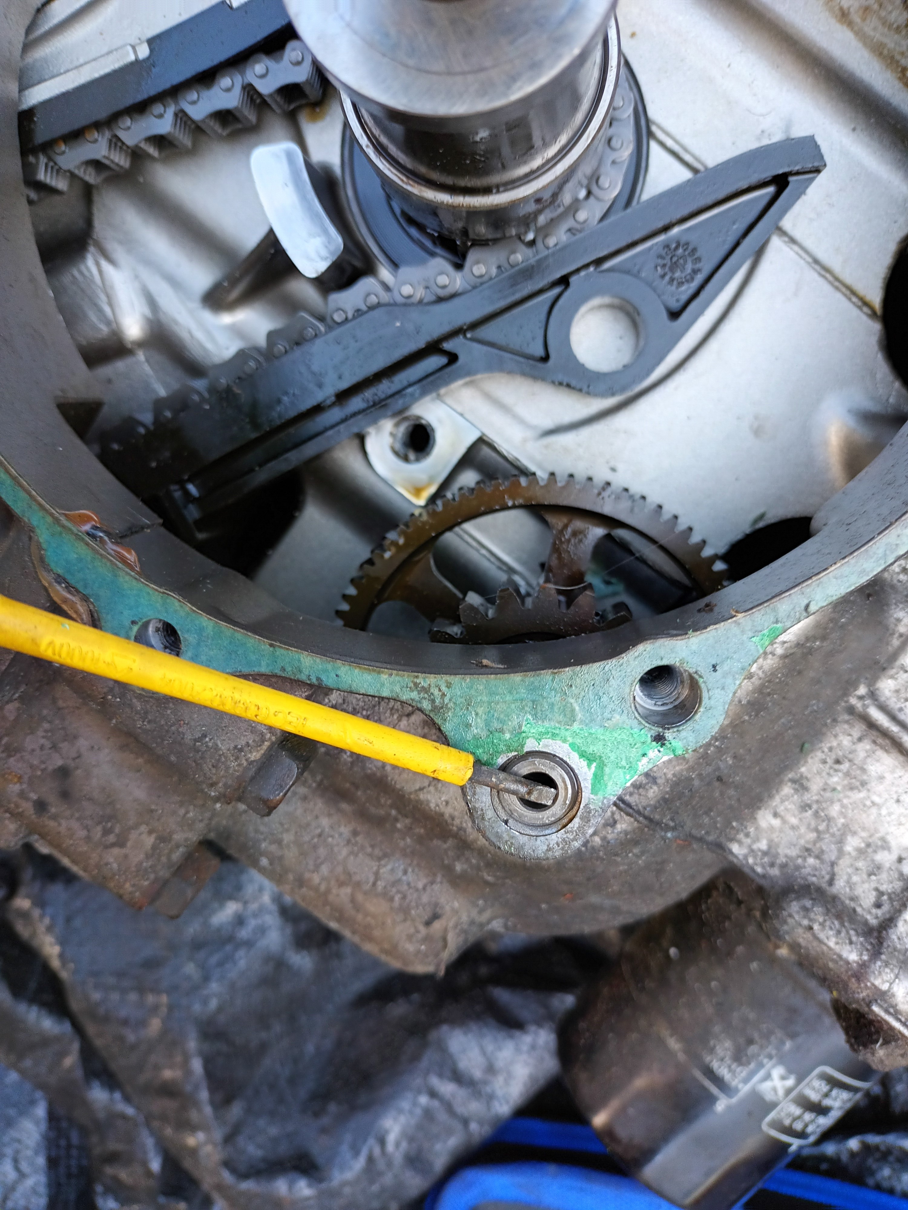

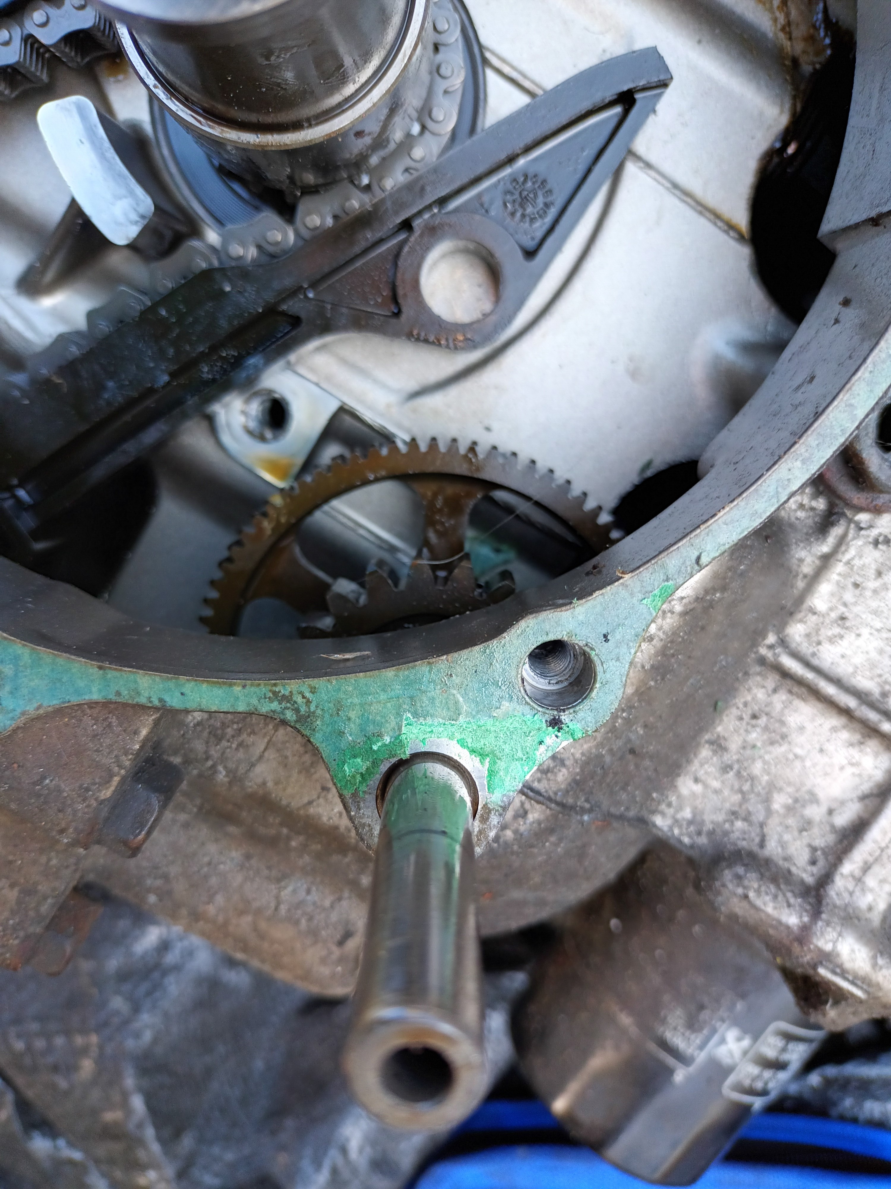

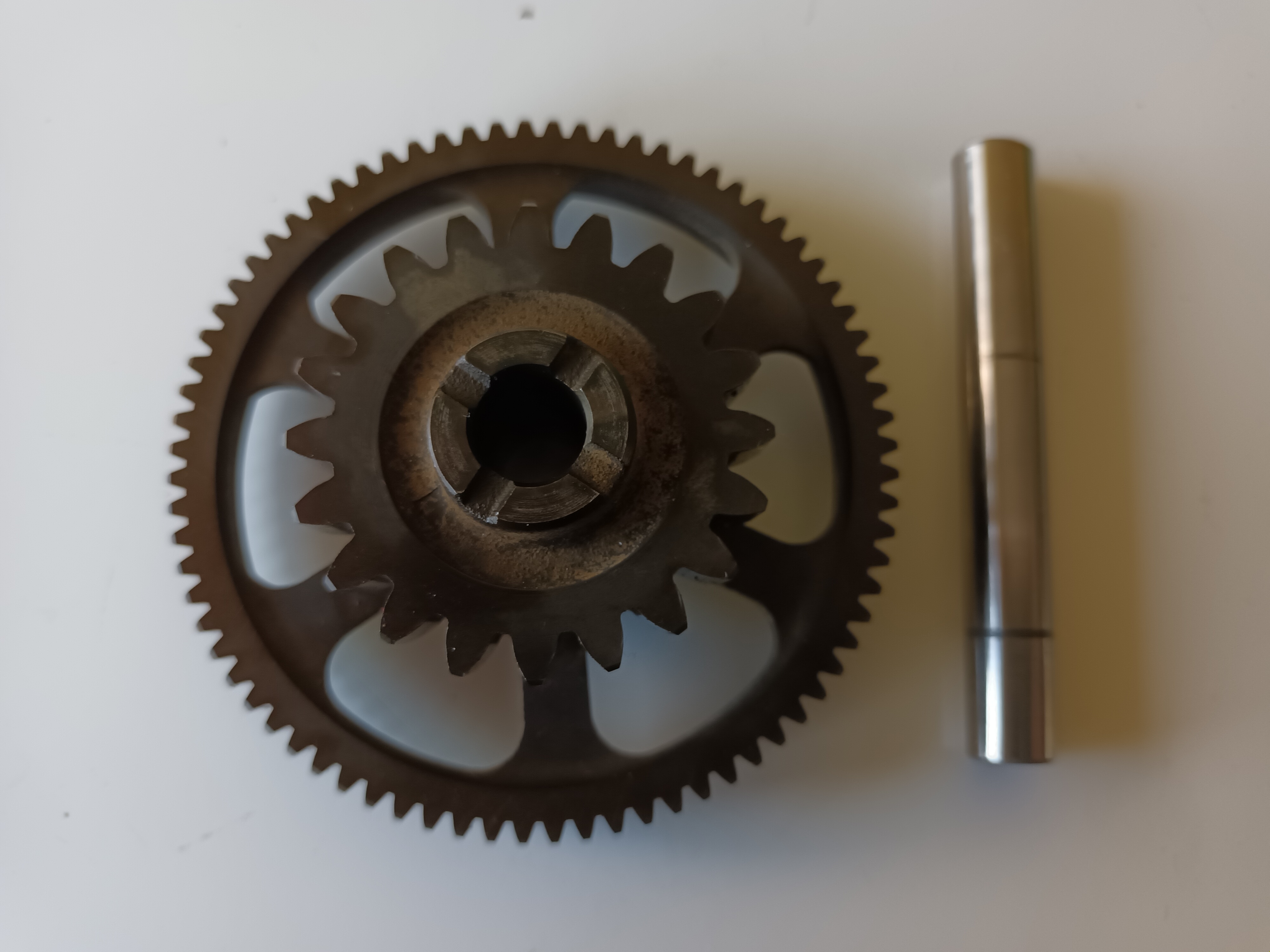

This is the pin that holds the gears in, it's loose fit & come out fairly easy, Tony says use a magnet, I used a small pair of bent nosed pliers to hold & pull out. The gasket needed scraping away to get it out...

You have a new PM as well.
Re: noise
Mac, good man for posting up the photo's above :clap:
