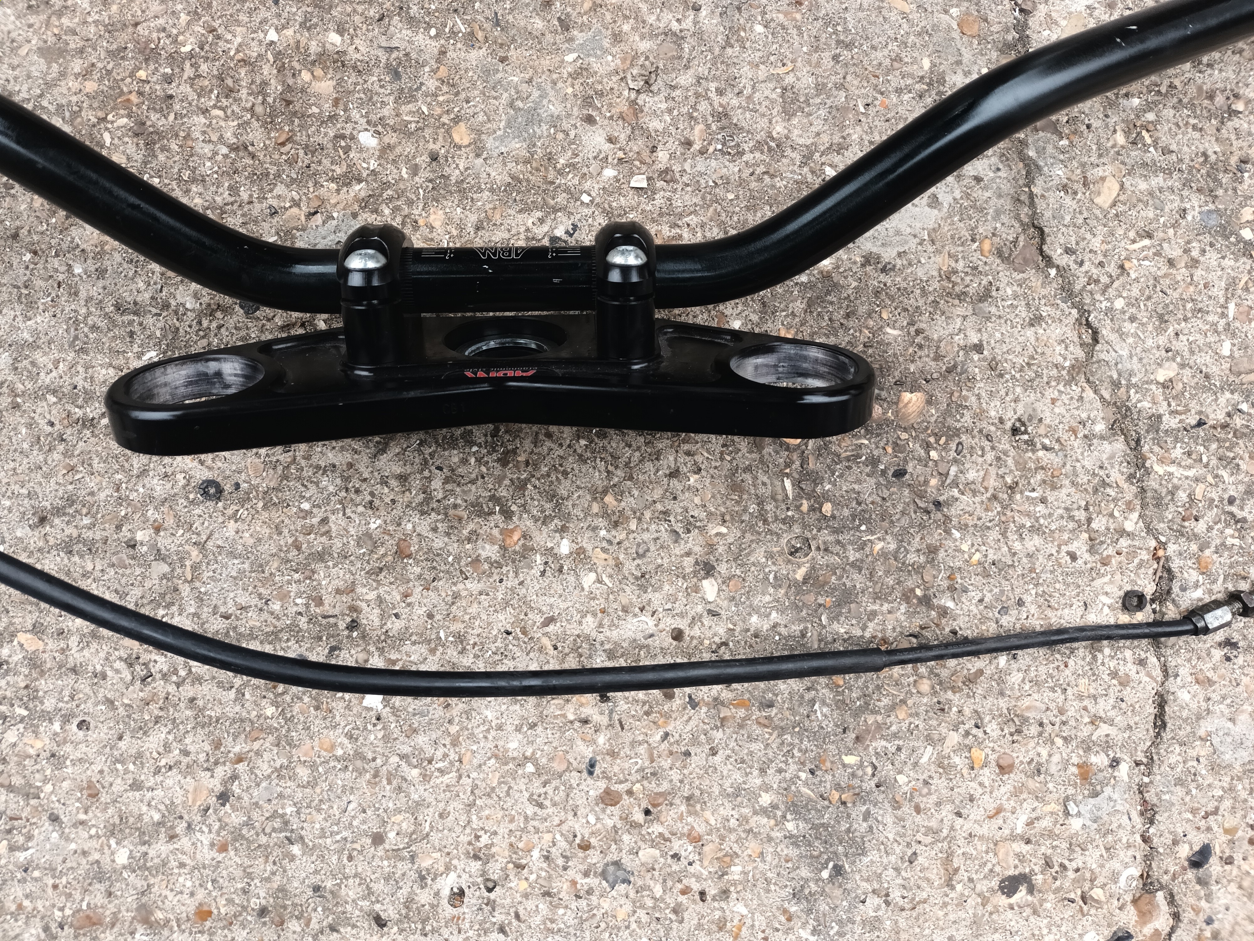

Indeed I have done the flat bar conversion to one of my Storms.
Now as I have the luxury of being able to swap between clip ons & flat bar...Whats the difference ?
Well depending on how much you ride, i'm daily as no car, it may take a while to get used to it, I've never really had an issue with the sore wrists every one complains about as I ride almost every day, so you get used to it.
With the flat bar I find two major differences... I find that my palms get sore from the way you/I lean on them, relaxing a bit helps that tho. The second thing is your more up in the wind blast So long rides are more tiring on neck, shoulders...
I have std fiarings lightly trimmed on the ears, with a DB screen. I do however run 600f4i callipres & have the square res pots so they are lower.
I'ts like riding a different bike. My one is running a 6mm shock spacer so the rear is higher, the flat bars take weight off the front so you will find it handels a bit differently to std.
I have a Cool n Comfy conversion on mine which is a full top yoke swap.

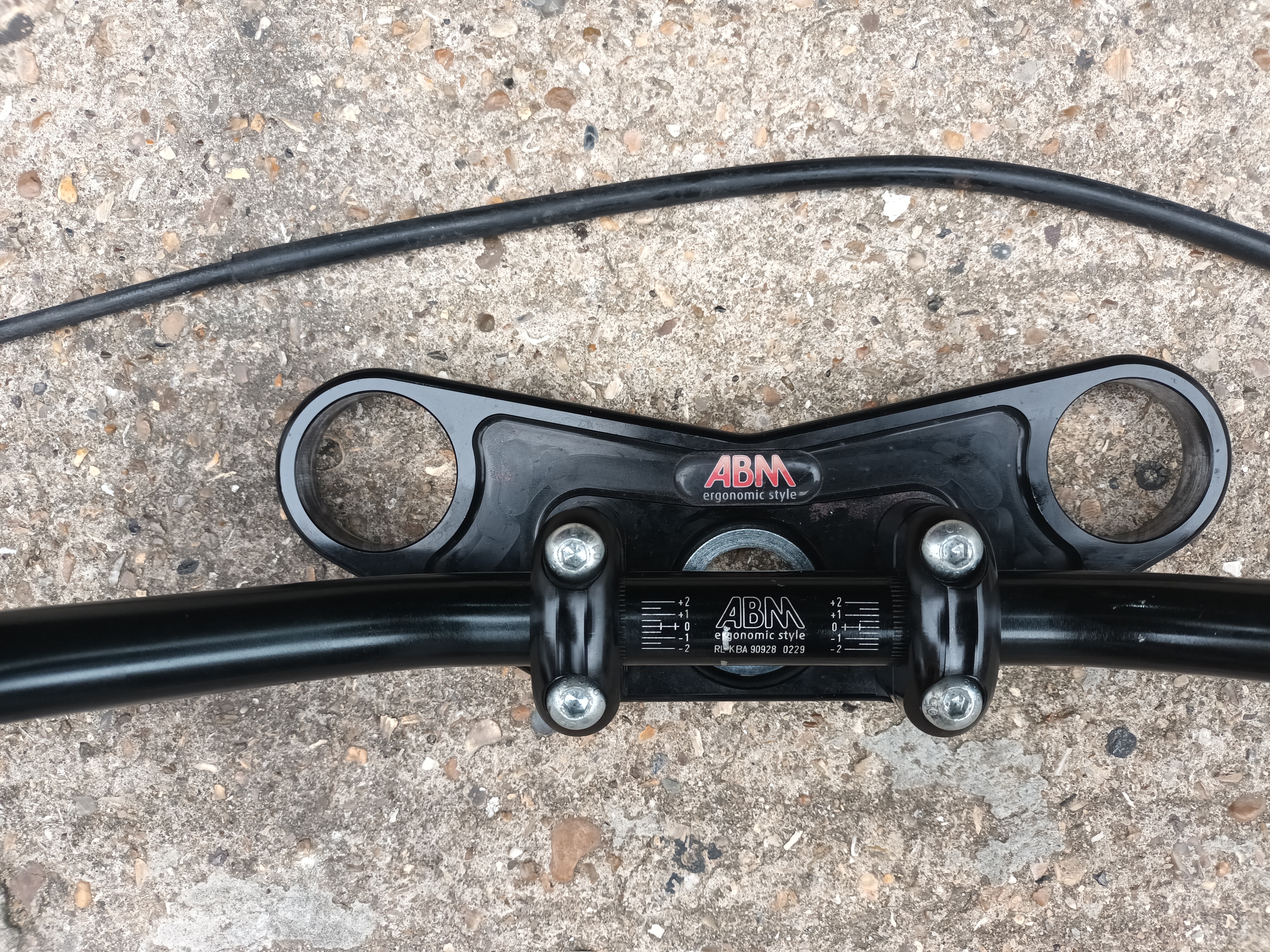

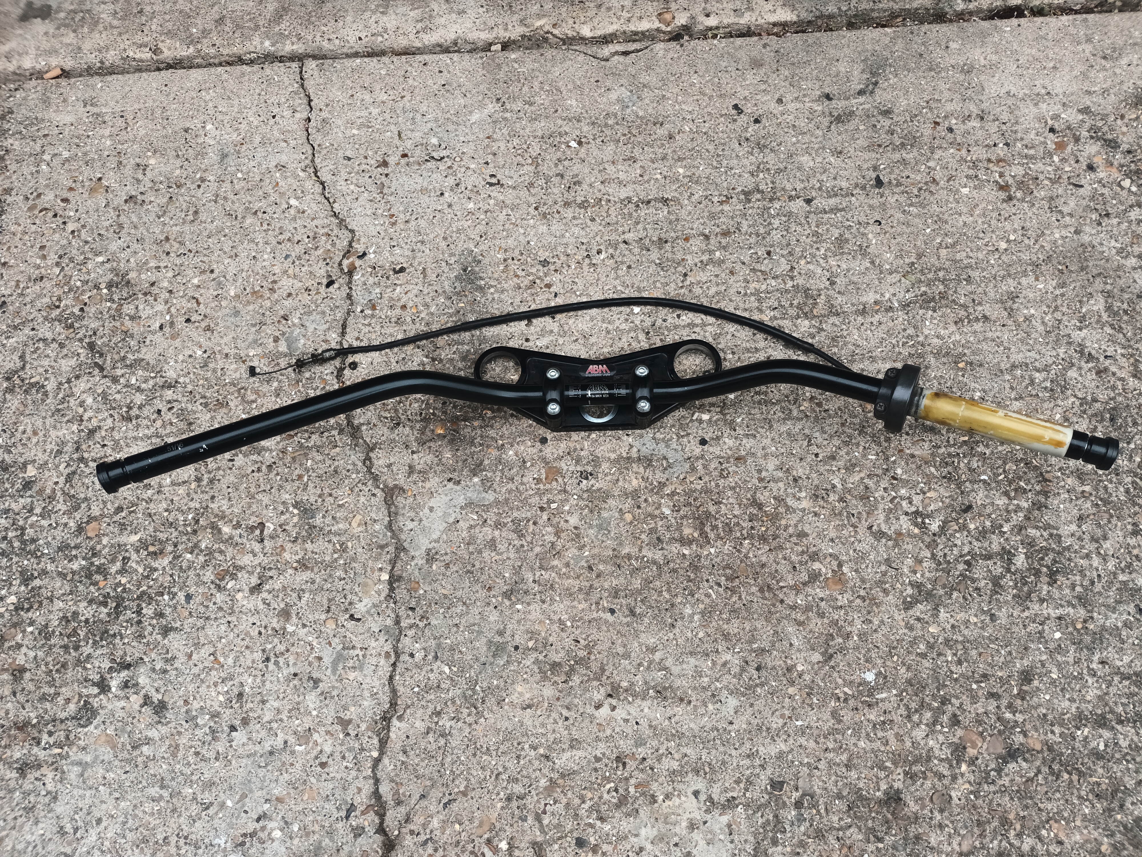

I do have in the parts stash an ABM set up which is a flat plate that just sits on top of the standard yoke...
